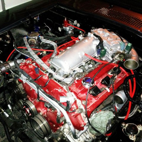

Thanks for the reply, was looking forward to your built how it drives and other things. Mine took some time mainly because of the steering rack which I changed. Engine was all done last week just took it yesterday to get the inter-cooler piping and radiator done after that wiring job will start.
I am still not sure if there is NATS in my car or not as engine is slightly newer still hoping there should be. Will try to run on stock ECU else might change to stand alone adaptronic to have a cleaner look and more tunnability. Let me know if you have any suggestions regards to wiring to stand alone ECU.
Posting a picture as engine was few days back
Thanks

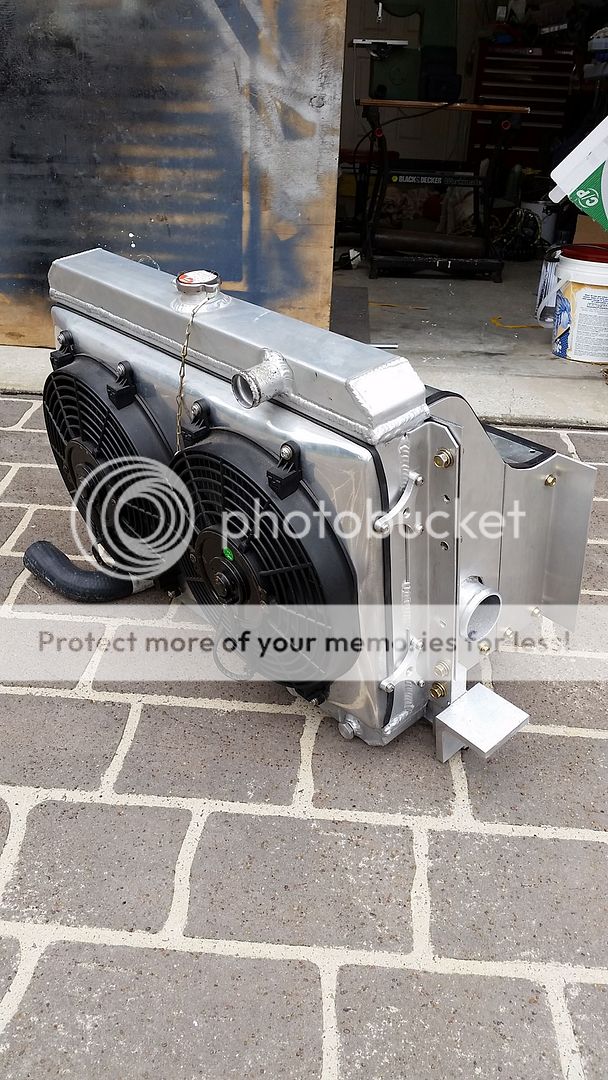

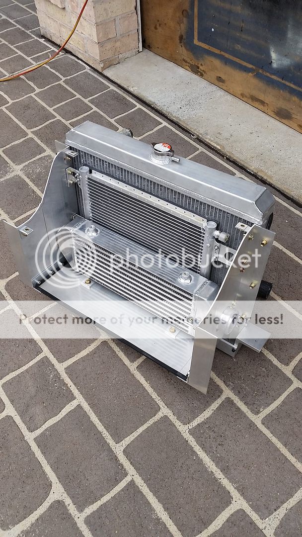

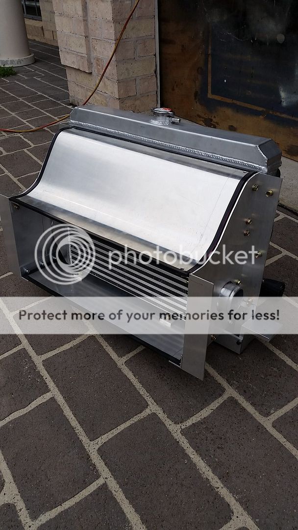

I have changed my setup for the radiator , condenser and a smaller intercooler.
I am keeping in mind what was worked out in the windtunnel tests, I have the opening the same area as the two fans on the shroud at the back, so air in = air out.
14124938_1028006983961948_49496407690859
14067916_1028007500628563_55564887522549
All this sits behind the original radiator support.
