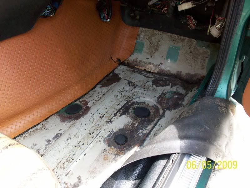

Before with rubber coat/"sound deadening":

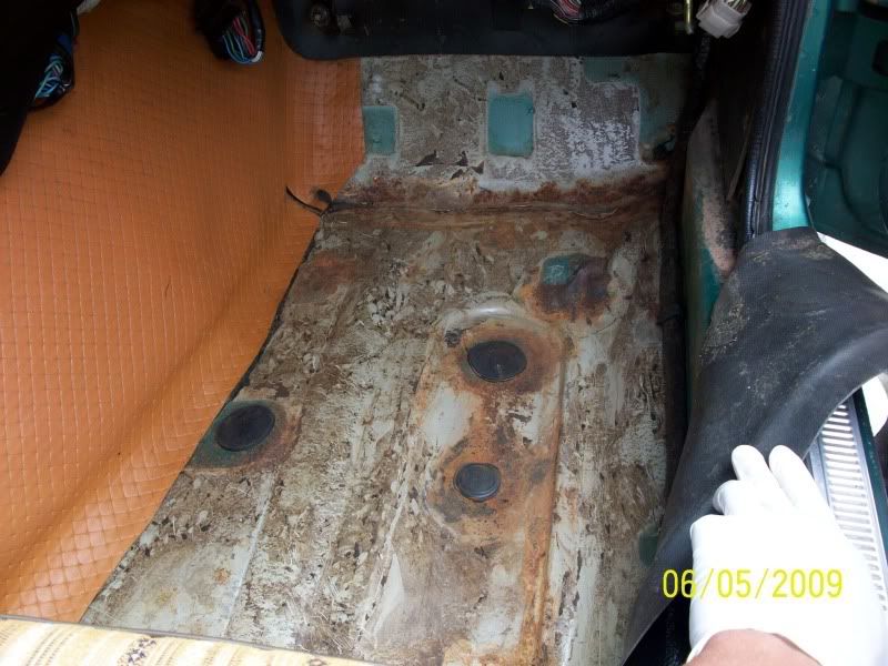

After removing the "factory" rubber under coating:

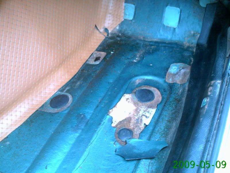

Sanding the rust:

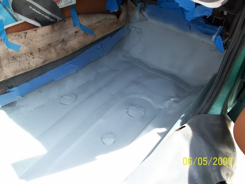

Prime:

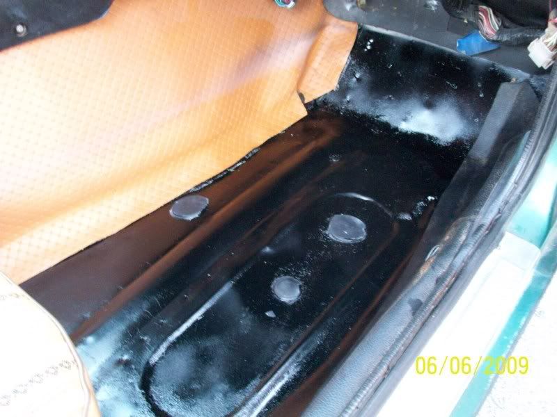

Semi Gloss black:

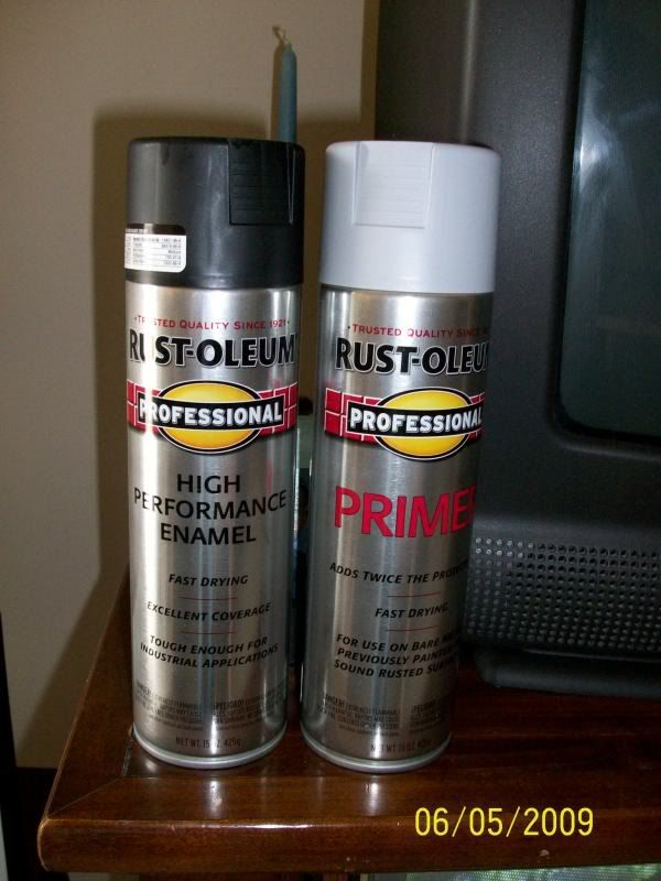

Cans:
I guess you could roll it on or use High density brushes, but I think it will cost a little more considering the brushes, rollers, and mineral spirits etc.
