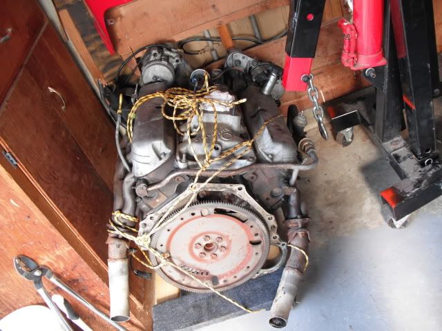

Beau M Posted June 29, 2009 Share Posted June 29, 2009 Help, my brain is full! I have been doing a ton of research (and very little actual work) on my swap into my 280z 2+2. I cannot be trusted to pick out my own parts, as I just bought a re-built 302 on CL. Turns out its from an 86, which no one has anything good to say about. It was rebuilt and came with a nice carb and intake though. Now I need to find a tranny, I want a 5-speed. What exactly am I looking for? Any years or part numbers I need to steer clear of? Thanks. -Beau Quote Link to comment Share on other sites More sharing options...

Michael Yount Posted July 1, 2009 Share Posted July 1, 2009 If possible, you want to get rid of those heads (E6's) and get a pair of E7's from an 87-95 motor (Stang), or better yet, hit your local pick/pull and get a set of GT40/GT40P irons from an Explorer or Mountaineer. The GT40's came on 96 and very early 97's; the GT40P's came on the rest of the 97's-01. Also, the 86 pistons have no valve reliefs (true flat tops) - so piston to valve clearance is a potential issue with almost any aftermarket camshaft --- if you change the heads (and you'll want to) - be sure to measure p to v clearance. The T5 transmission out of any 85-95 V8 Stang is what you want. Don't get the 4-cylinder version. And if you're willing to buy new (most used T5's behind the V8's are long in tooth, no pun) get the T5-Z which has the first 4 gears a bit closer in ratio and 5th gear more overdriven. The stock T5 is 3.35, 1.94, 1.29, 1.00, .675; the T5-Z is 2.95, 1.94, 1.34, 1.00, .625. Quote Link to comment Share on other sites More sharing options...
