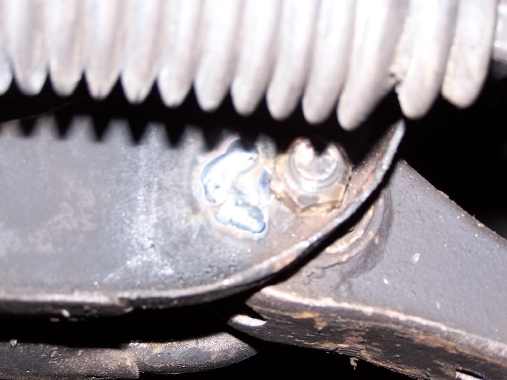

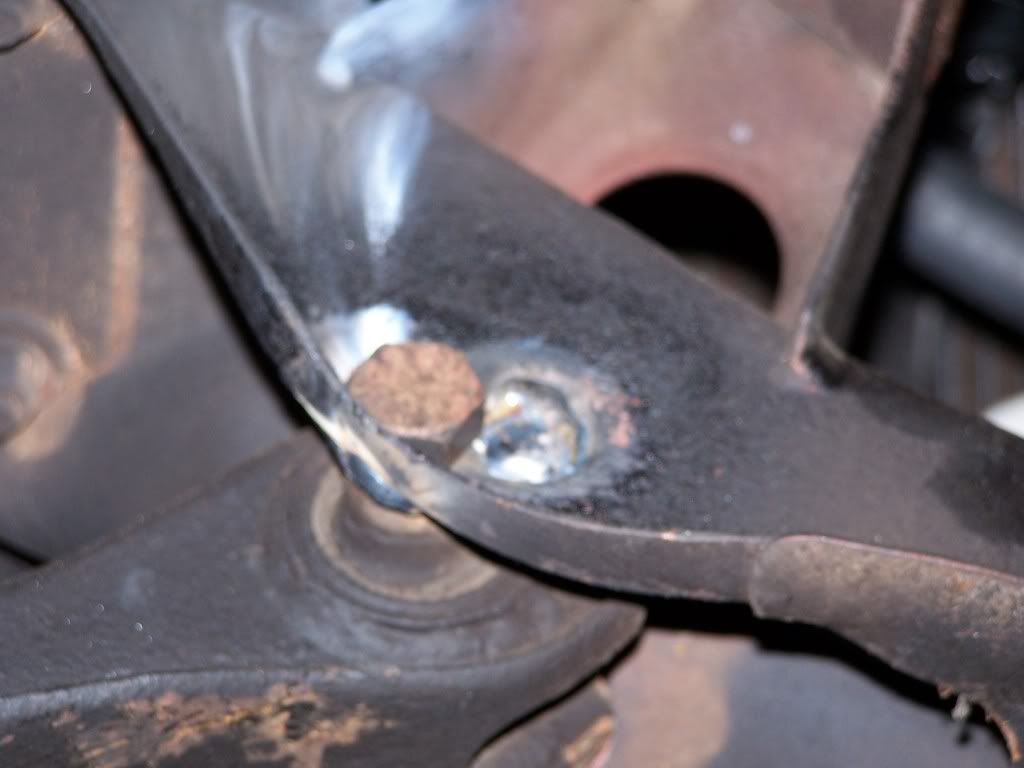

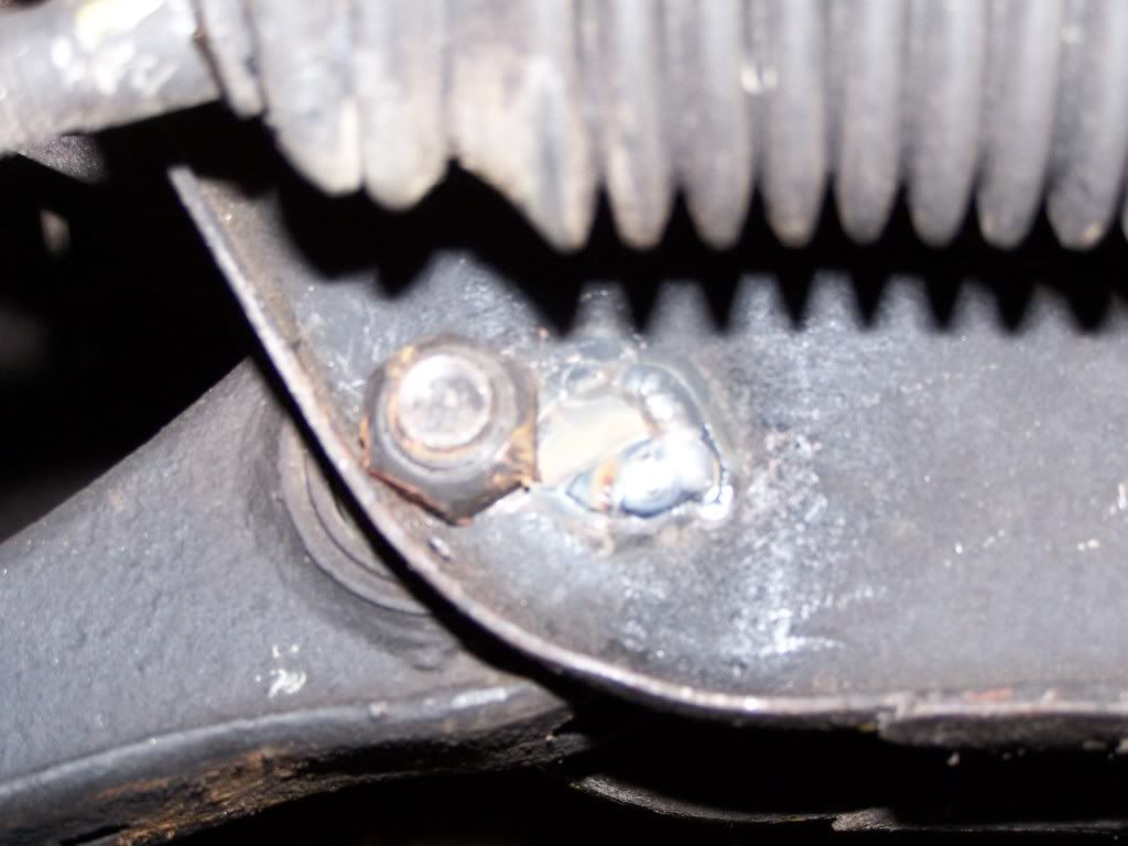

subtle_driver Posted July 17, 2009 Author Share Posted July 17, 2009 I thought i would let you know, the camber trick worked so far. moved the inner lca hole out 1/2" and welded the other hole shut. after adjusting the toe, we had definitly had well over 1/2" of thread left on the inner tie rods. i dont remember exactly. With the car lowered about 1.5" we got 2 degrees of negitive camber. Quote Link to comment Share on other sites More sharing options...
