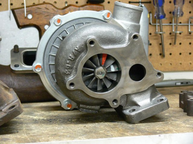

Jesse OBrien Posted August 11, 2009 Share Posted August 11, 2009 Strange, I have a very similar problem, and I suspect it may actually be the exact same problem. Here I have a stock Nissan t3 exhaust housing, and a Turbonetics t3/t04 exhaust side of the turbo: From the sounds of it, Garrett and Turbonetics use the same wastegate cover. I'd REALLY like to be able to just use the stock wastegate setup with this, so let me know if you come up with a decent (affordable) solution. I've been looking for awhile, but probably not as hard as I should have been. Quote Link to comment Share on other sites More sharing options...
