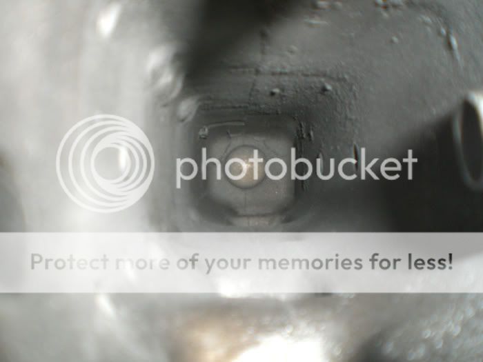

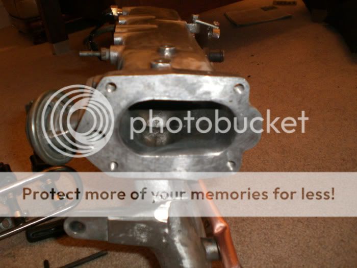

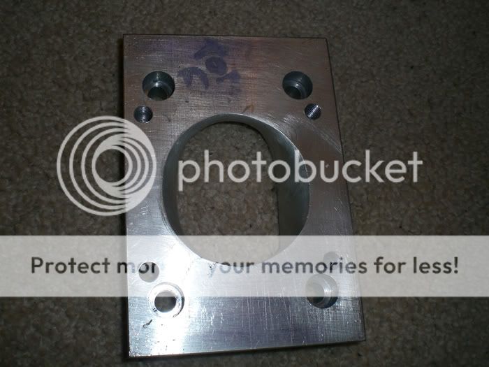

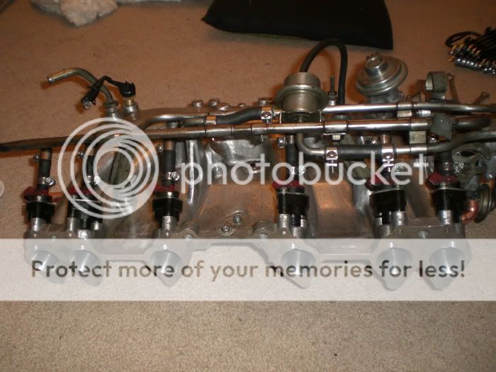

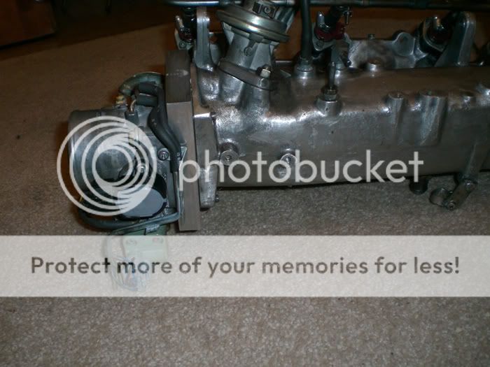

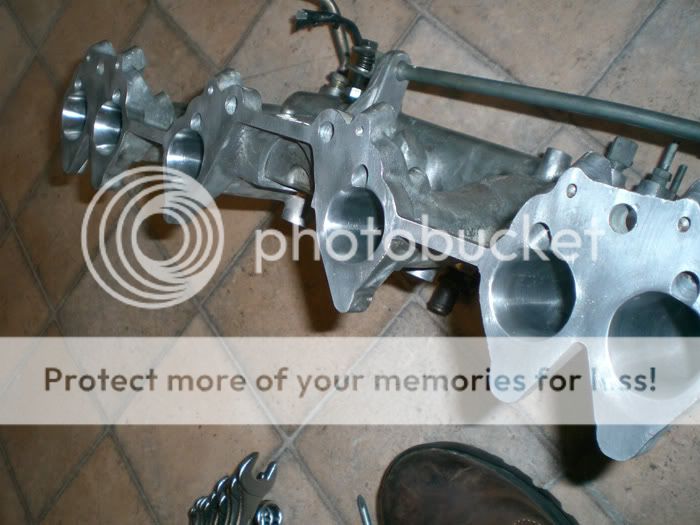

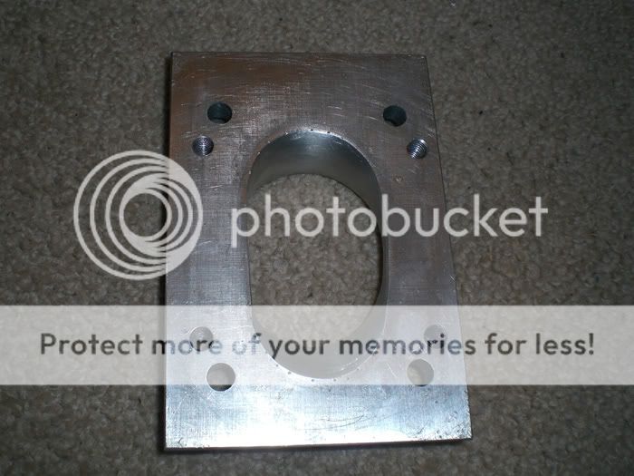

kolonelklink87 Posted August 9, 2009 Share Posted August 9, 2009 Hello Z'ers, So I just got my manifold bits back from portmatching and wanted to share some pics and get some feedback... First off i could use a bit of help identifying the manifold - i've used it for ages but it never had a cast mark on it when i got it - the TB mouth is 40x80mm and matches to a sequential twin throttle. The TB required an adaptor plate for 60mm TB: the plenum is nice and...errrr cavitatious the TB sits on nice an snug now... The TPS is MS friendly of course and there is a idle control solenoid (one circuit to increase idle, one to decrease) on the bottom. finally the ports : I havent seen this TB(probably due to the Accel. cable issues) or manifold used much so I wanted to get some opinions and suggestions on identification(i think is maybe a r30 but not sure), application and anything that i can improve or might have missed. Cheers folks! Quote Link to comment Share on other sites More sharing options...
1 fast z Posted August 10, 2009 Share Posted August 10, 2009 Looks like a naps z manifold. With dual throttle plates. Quote Link to comment Share on other sites More sharing options...
kolonelklink87 Posted August 10, 2009 Author Share Posted August 10, 2009 Looks like a naps z manifold. With dual throttle plates. Thanks, i figured so but thought i'd get someone to confirm since i was posting pics anywho:) Quote Link to comment Share on other sites More sharing options...
ozconnection Posted August 10, 2009 Share Posted August 10, 2009 Did you measure the size of those ports? You did say they were matchported to your head....35mm's? How far up the runners did you go with the porting? Did you taper them at all? Has porting the manifold altered its flow characteristics? Would you suggest that porting with flow bench verification be a more 'scientific' approach? I'm not trying to dampen your efforts (and I've hand ported many manifolds myself) but I'm curious as to AFR's when one or several runners now flow better than the others and there is potentially no way in adjusting individual cylinders to correct the differences, unless you have individual injector/cylinder control, EGT's or individual lambda probes in each exhaust header pipe. Sure, the differences may be small but after modification, are they any better, worse or with greater variation than before? Who knows? Then there's the question of gas velocity? And anti-reversion at the port to manifold junction? Your thoughts? Quote Link to comment Share on other sites More sharing options...
kolonelklink87 Posted August 11, 2009 Author Share Posted August 11, 2009 Did you measure the size of those ports? You did say they were matchported to your head....35mm's? How far up the runners did you go with the porting? Did you taper them at all? Has porting the manifold altered its flow characteristics? Would you suggest that porting with flow bench verification be a more 'scientific' approach? I'm not trying to dampen your efforts (and I've hand ported many manifolds myself) but I'm curious as to AFR's when one or several runners now flow better than the others and there is potentially no way in adjusting individual cylinders to correct the differences, unless you have individual injector/cylinder control, EGT's or individual lambda probes in each exhaust header pipe. Sure, the differences may be small but after modification, are they any better, worse or with greater variation than before? Who knows? Then there's the question of gas velocity? And anti-reversion at the port to manifold junction? Your thoughts? Yes of course... you know that i always favor the scientific approach! but affordability is a bit of an issue with me so I can't always be as precise as i'd like. If you're in the area some time soon i'll take it off the car an give you a look - the porting wasnt done by myself but by a local head engineer who claims some experience with Z engines. Ports are tapered and matched to the head-matched gasket and thus the head... which is simularly ported(38mm from PO). My rationale being that for the higher RPM camming of my engine this setup should be superior to the 32mm ports and twin, but small, butterflies. I'm certainly a big proponent on the small ports on cedrics combination but since the head is already ported I actually thought this might give a good comparison between concepts:icon15: I still have alot of tuning to do and if nessercary i can throw on a stock XZ manifold if you want to project some G-tech data... but thats a conversation for another time Since quite alot of material has been taken out - i wouldnt have trusted this one to home porting Quote Link to comment Share on other sites More sharing options...
kolonelklink87 Posted August 17, 2009 Author Share Posted August 17, 2009 well I was hoping to prompt a bit of discussion about NAPS manifolds but i guess my approach was WAY to subtle So i'll put it more plainly, why is the NAPS manifold so rarely seen on Z engines? - it seems like an improvement over the stock tapered N/A manifold and since the turbo manifolds are rarely avail locally in Aust it seemed the obvious choice... additionally the TB port size is already ~30cm2(80x40mm minus the round edges), much larger than the stock 50mm TB mouth(~20-22cm2 i think?) AND there are no EGR bumps at the base of the runner-plenum interface. The EGR dumps into just behind the TB (see above pics) which could easily be removed with a dremel (i have chosen to leave it on for now). I still need to tune things in properly but this manifold seems to deliver well into the 6-7k range once the ports are opened up a little. (I'll try to get some flow numbers when I come into some money lol) How come I so rarely see this used as a serious option on a Z? (i hope this isnt too annoying of a question but alot of what i've read "poo-poo"'s the NAPS manifolds and I cant see any good reason to. I have read plenty of posts about people considering using NAPS manifolds or dicussing sequential throttling but no real feedback after fitting and tuning. My experience has be wholely positive so far) Quote Link to comment Share on other sites More sharing options...
