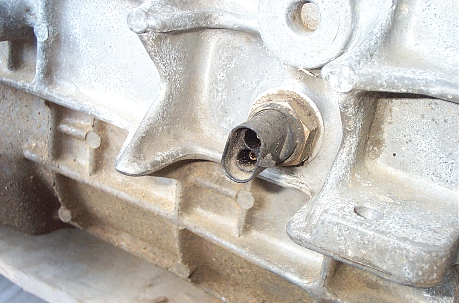

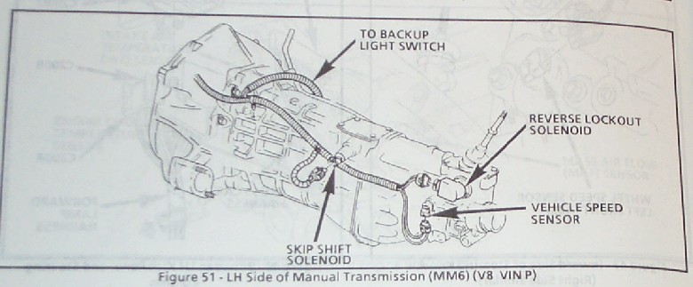

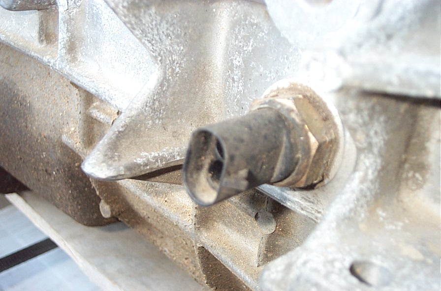

Vette Powered Posted August 23, 2009 Share Posted August 23, 2009 Can someone tell me were the reverse light wiring is on the T56 and how important the lock out is for reverse. I keep grinding a little trying to find 5th gear. Is there a cheaper part out there? Chevy wants a sh*t load for it! Quote Link to comment Share on other sites More sharing options...

bodie Posted August 23, 2009 Share Posted August 23, 2009 reverse lockout is a pita to get through if not wired up. either wire it to a seperate switch of from you brake switch. its just a 12v selonoid. Quote Link to comment Share on other sites More sharing options...
