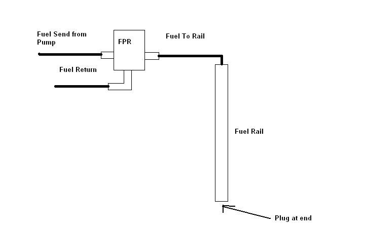

calpoly-z Posted August 24, 2009 Share Posted August 24, 2009 I'm in the process of building an O-Ring fuel rail to replace my barbed one, and I was thinking about ways to route the fuel lines that would look a little better. I was thinking about mounting the FPR to the firewall and routing both send and return around the back of the engine. I drew up a little schematic to show how I was planning on routing things, but before I went ahead and did this I wanted to verify that this would not cause any problems. As you can see, I want to mount the FPR inline before the rail and then have one end of the rail plugged. Does anyone see any issues arising from this? Quote Link to comment Share on other sites More sharing options...
nismopick Posted August 24, 2009 Share Posted August 24, 2009 I assume this is going on an L Series motor? Are you using the stock FPR? Because most of the L28 FPR's just have one IN and one OUT. Quote Link to comment Share on other sites More sharing options...
calpoly-z Posted August 24, 2009 Author Share Posted August 24, 2009 I am using this on my L28. I'm not sure exactly what vehicle the FPR I currently have is from, but it definitely has 2 inlets each 180 degrees apart and the one return outlet on the bottom. Quote Link to comment Share on other sites More sharing options...
Six_Shooter Posted August 24, 2009 Share Posted August 24, 2009 I routed my fuel feed into the end of the fuel rail nearest the firewall, and then from the other end to the FPR which I mouted in the location of the stock mechanical fuel pump, which I then used the original feed line as a return. Been working great this way for over a year. You will need to verify that your FPR will indeed provide proper fuel flow to the rail connected in the way you have pictured above, some rFPRs will and others won't. I would advise against mounting the FPR on the firewall, some sanctioning racing organizations will fail tech with the FPR mounted on the firewall. Quote Link to comment Share on other sites More sharing options...
