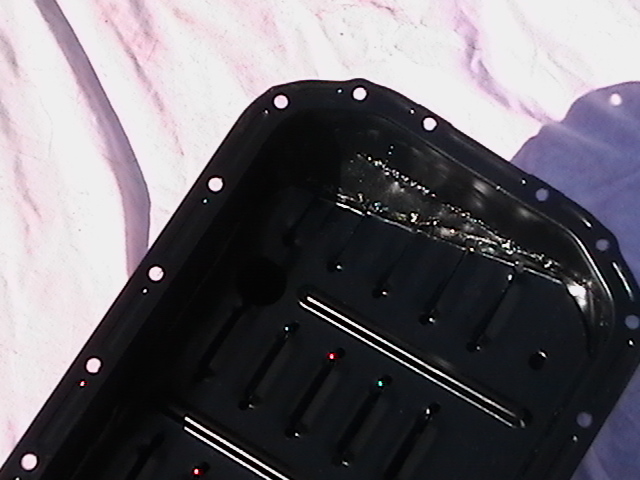

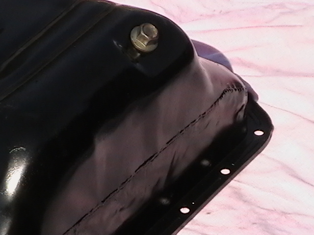

this was mostly a stock one

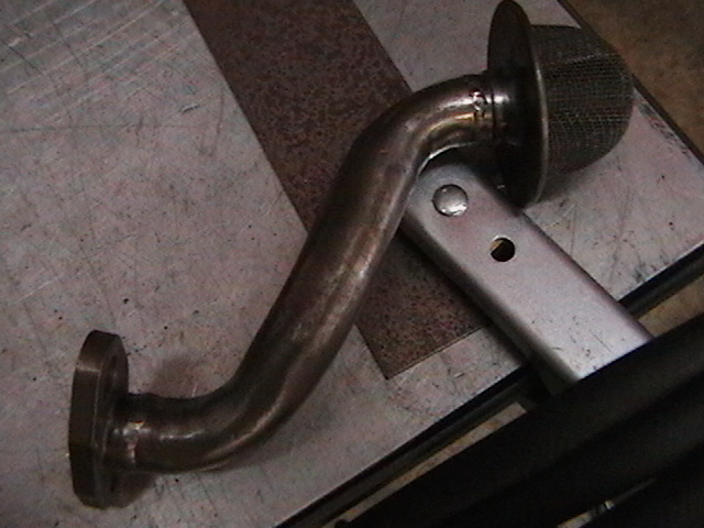

first one we did. So i made a couple of mistakes. I made a jigs to move the oil pump pickup and depth and to set the pan depth and angle ... and no i forgot to take pics of this pan in the jigs...

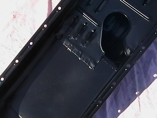

We do lots of metal fab and envmyz asked me to do this for him so i did . i laid it out and my old boss(Ex McLaren Can am fabby and indy car fabby) welded it up we also decided to make jigs at chris's urging .
can do a deep sump wide sump with baffles to . custom would be pretty easy. he wanted a stock look and this is what i came up with...

Correct. This "was" a stock RB pan. Front sump made into a rear sump. He takes the stock oil pickup and fabricates it to make a mirror pickup.

It does take a solid 8 hours plus materials to do this. And to make it look good.We could do it in half the time mig welding it and not taking care of the details but i would and will not do it that way.

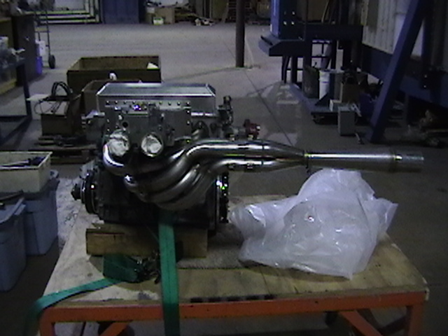

header(stainless) oilpan(drysump with scraper) front cover for balancer and electormotive ignition wheel.

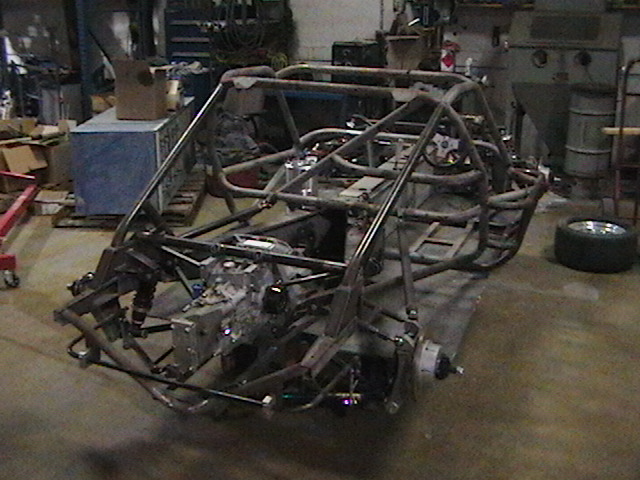

chassis lotus europa E prod car

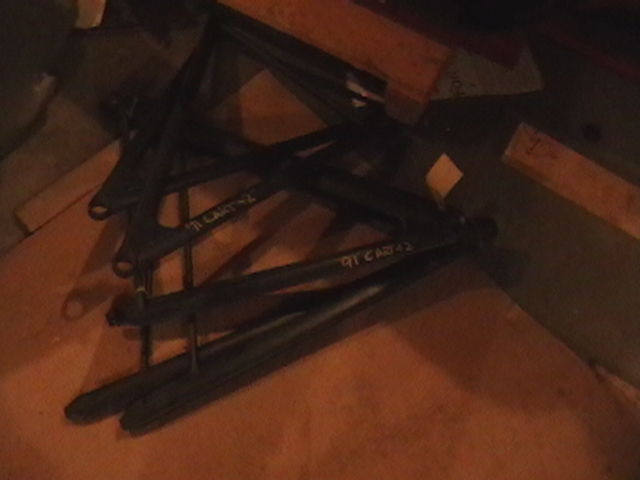

My T buck control arms left over 91 lola chassis control arms.
