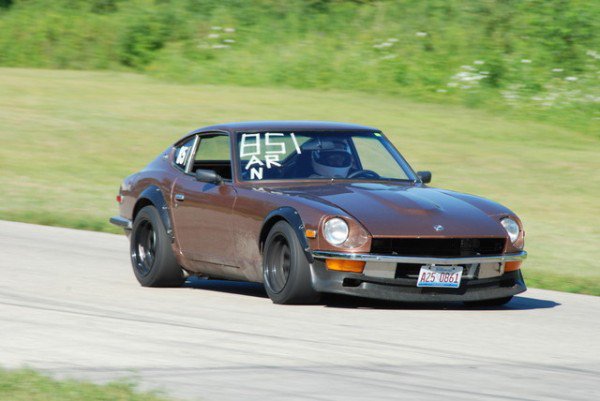

voltron_boi Posted August 25, 2009 Author Share Posted August 25, 2009 i have talk to heavy85 a member of hybridz, and he is running 15x10 with 5' backspace on his 240z. i dont know if he did any modify to his suspension, because its been a while since i talk to him. i was thinking about what stony had say. so for now i am going with the 15x10 5' backspace. so if anyone can confirm if it fits with stock suspension, then ill be order my set today. so please any feeback? Quote Link to comment Share on other sites More sharing options...

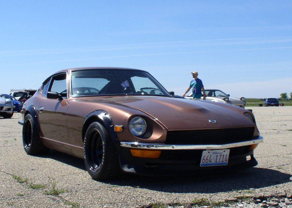

voltron_boi Posted August 25, 2009 Author Share Posted August 25, 2009 here are some pix of heavy85 car that i have save into my laptop. Quote Link to comment Share on other sites More sharing options...
zlalomz Posted August 26, 2009 Share Posted August 26, 2009 I don't know why you want 15x10 on a stock suspension but here is what the front looks like with 5 inch backspace. It clears with a stretched tire but I'm not sure about say a wider 275 Hoosier. Quote Link to comment Share on other sites More sharing options...
