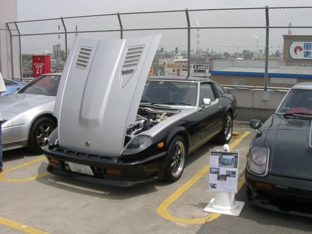

zeeboost Posted September 15, 2009 Author Share Posted September 15, 2009 Then all you have to do is remove the headlight to get in there and clean once in a while. Just a thought. Scott. I've been keeping this project pretty hush-hush for now, but I may not be able to remove the headlights once I'm finished. If I can, it won't be an easy task at all. It's not going to have the original 7" headlights, basically. How do other cars get away with this? Are they completely sealed, not having a drain tube or anything? Some examples of the headlight cover finish I'm going after: Ferrari 360 Ferrari f50 Aston Martin: Quote Link to comment Share on other sites More sharing options...
Avernier Posted September 15, 2009 Share Posted September 15, 2009 ^ All of the above are three piece designs with industrial strength rubber based adhesive. You have to bake those headlights at 250-275* for about 7 minutes to open them. They are fully sealed. The clear part fits into a v shaped groove thats filled with the adhesive. Once you press the clear part into the groove at room temperature (the adhesive is fairly pliable at room temp.), bake it for about 7 minutes at 250, then press it all the way together and clamp it with "C" clamps or vice grips until it cools. now it is fully sealed from the elements. if you want to recreate that, you need to make a housing that the cover can fit into to seal. Quote Link to comment Share on other sites More sharing options...
zeeboost Posted September 15, 2009 Author Share Posted September 15, 2009 What if I mold the headlight cover on and seal off the headlights using a rubber gasket of some sort? If I bond the covers to the bucket, and use a body filler to smooth the transition from the bucket to the cover, this should create an air-tight seal, correct? Thus, leaving the moisture's only area of entry to be the gap between the headlights and the bucket? So basically, if I completely seal this off, I won't have to worry about trapping moisture inside and running a vent tube, correct? edit: Also, I don't mind if I need to run a concealed drain tube for moisture, but only if it will keep the headlight covers from fogging up. If I'm still going to have those issues, I might as well go through the trouble of sealing it all off (again, if that will keep the moisture from collecting on the inside). Quote Link to comment Share on other sites More sharing options...
cygnusx1 Posted September 15, 2009 Share Posted September 15, 2009 A completely sealed module or well ventilated will work. Well ventilated will probably get dirty and require internal cleaning regularly. Sealed (airtight) will be more difficult but will not get dirty or foggy as long as there is little or no moisture in it the air when it's sealed. Partially vented with a small hole will probably get enough moisture in it from daily temp swings to cause internal fogging. Quote Link to comment Share on other sites More sharing options...

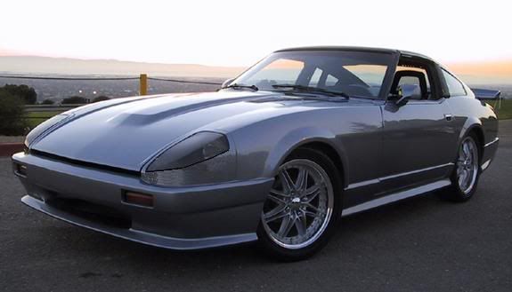

zeeboost Posted September 15, 2009 Author Share Posted September 15, 2009 Cygnus - Thanks, it looks like I get to figure out the best way to seal this beast. Avernier - I'm painting part of the headlight cover to make it look like part of the car, hence why I'm wanting to mold the covers and flush any gaps. Even though I love this car (minus the stripes someone drew on it...?), I do not want to be able to see the shape/outline of the covers through the paint: ...but to make it look like one with the body, such as Darius did: Quote Link to comment Share on other sites More sharing options...
cygnusx1 Posted September 16, 2009 Share Posted September 16, 2009 There are some hot rods that I have seen that have tail lights that look like they are behind the paint. In other words, there are no seams or pockets, the paint is continuous right over the light and the lights shine through the clearcoat. I am not sure how it's done or what it's called. Anyone? I think that's what you want to pull off here. Just like Darius's car but the headlight corners are clear, but look like they are seamless, flush with the paint, with zero trace lines. Here is a somewhat poor example: Quote Link to comment Share on other sites More sharing options...

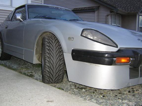

Dan Juday Posted September 28, 2009 Share Posted September 28, 2009 I saw a heavily modified S30 at an MSA show several years ago that the owner had done something like this to. It looked "O.K.". Actually it looked like a lot of work/money for just an o.k. result. It did get me thinking though. I hate those brackets. Exposed screw heads and double back tape, arg! So I was thinking: You could paint the clear covers about an inch or so in from the edges the same color as the car. When mounted it would look like you had smaller than normal covers. Then glue acrylic blocks to the backside, behind the painted areas, as mounts. In the blocks drill holes and glue in dowels that would fit into matching holes drilled into the headlight buckets. If you were carefull, and clever about where the mounts are located, you could get a nice tight fit without any exposed hardware. The covers could be installed and removed by squeezing them enough for the dowels on one side to clear the holes. Use some small felt pads on the mounts so any movement won't mar the paint. Quote Link to comment Share on other sites More sharing options...
zeeboost Posted September 29, 2009 Author Share Posted September 29, 2009 I saw a heavily modified S30 at an MSA show several years ago that the owner had done something like this to. It looked "O.K.". Actually it looked like a lot of work/money for just an o.k. result. It did get me thinking though. I hate those brackets. Exposed screw heads and double back tape, arg! So I was thinking: You could paint the clear covers about an inch or so in from the edges the same color as the car. When mounted it would look like you had smaller than normal covers. Then glue acrylic blocks to the backside, behind the painted areas, as mounts. In the blocks drill holes and glue in dowels that would fit into matching holes drilled into the headlight buckets. If you were carefull, and clever about where the mounts are located, you could get a nice tight fit without any exposed hardware. The covers could be installed and removed by squeezing them enough for the dowels on one side to clear the holes. Use some small felt pads on the mounts so any movement won't mar the paint. Dan, that's an idea and a half right there! That may be my best way to approach this. The only other potential problem I'd have is the weatherstripping around the covers. I'm sure using them would help reduce dirt/moisture/other crap from getting inside, but on the other hand, the rubber will look out of place on one section of the cover. The cover has two streamlines (for lack of better word), one on the upper portion and one on the lower portion. I was planning on painting the cover the same as the body from the lower streamline to the bottom of the cover. Pictures would probably help more than an explanation: A crude rendering: This probably is the closest resemblance of what I'm going after: And originally I had intended on using black pan-head mounting screws, and having a black ring outline the cover (think aston martin vanquish). Another crude sketch of that: So if I use the weatherstripping around the cover, it will look awkward where it sticks out in the painted area of the cover. I could paint the rubber the same color as the body and cover, but it would still look odd sticking out like that. I'm not sure of a better way to seal the cover and still have it removable, so I may just end up cutting the rubber out of the painted areas, and just have it seal of the rest of the bucket. I don't know how efficient it will work, but it's the best I can think of at the moment. Again, the dowel pins are an awesome idea! When you mentioned the felt pads, which paint are you saying would be damaged? Quote Link to comment Share on other sites More sharing options...
