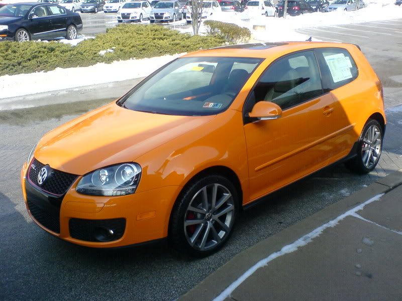

adam78280z Posted September 24, 2009 Author Share Posted September 24, 2009 Here's the order it should go if your going to do it with the por. Apply the por15 to the rust area. When the por is still tacky but not cured spray a coat of epoxy primer over the area. You know the por is ready if you touch it with your finger tip and no por transfers to your finger but still feels tacky. If you paint it too soon the por is still out gassing and it will bubble the primer. After the epoxy primer dries but withing it's cure period (or you have to scuff up the primer) use a resin based filler like duraglass to do the major filling. Sand the duraglass but don't go through the epoxy. If you do recoat. Now use bondo to feather out the repair. Now you can go to your high fill primer.The epoxy primer is waterproof and that's the barrier between moisture and the metal. At least that's how I did it! Derek Yeesh, body work is just that, WORK I just went by the local paint supply place..... I think i'm going with a 2007 VW Magma Orange color : What do you guys think? Plz don't bash for the VW pic Quote Link to comment Share on other sites More sharing options...
z2go Posted September 25, 2009 Share Posted September 25, 2009 Yeesh, body work is just that, WORK I just went by the local paint supply place..... I think i'm going with a 2007 VW Magma Orange color : What do you guys think? Plz don't bash for the VW pic I don't know what to think of it... maybe it's the lighting in the pic, but it almost looks like the original 240z orange, except... faded? Quote Link to comment Share on other sites More sharing options...
adam78280z Posted September 26, 2009 Author Share Posted September 26, 2009 I don't know what to think of it... maybe it's the lighting in the pic, but it almost looks like the original 240z orange, except... faded? I like the black trim as well. Definitely black hood vents and perhaps black air dam, etc Quote Link to comment Share on other sites More sharing options...
V8INtheZ Posted September 26, 2009 Share Posted September 26, 2009 2002 Chevy Grabber Orange is the best orange color. Im gonna paint my Z that color with black everything else. Quote Link to comment Share on other sites More sharing options...
