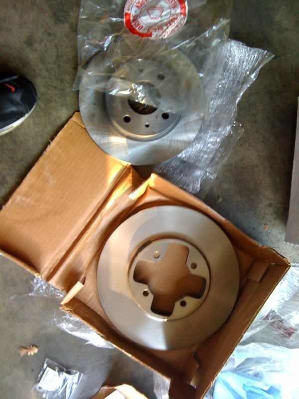

stravi757 Posted October 3, 2009 Share Posted October 3, 2009 I just got this stuff in the mail from MM, The rotors seen in the picture(which are two completely different rotors) are supposed to be for the 300zx vented rotors(front). I removed the wheel to my car(78 280z) to see if they would fit and neither of them did. Also the spacers didn't either! Im sure they didn't do this on purpose because I know alot of people have bought from them and I haven't heard anything but good but wow, I was really hoping I would get to install everything this weekend. Does anyone have a picture of what the rotors are supposed to look like in the front? The one thing that concerns me is the bigger nicer and newer looking rotor in the picture that didnt fit also lined up perfectly with the spacer, did i get the wrong kit plus some other random rotor? Quote Link to comment Share on other sites More sharing options...

Kennysgreen280zt Posted October 3, 2009 Share Posted October 3, 2009 the spacer and rotor bolt on the back of the hub, not the front. the rotor with the iron cross pattern cut out of it looks correct. Quote Link to comment Share on other sites More sharing options...
auxilary Posted October 4, 2009 Share Posted October 4, 2009 hope these help front vented 4x4 swap with spacer (this is not MM unit) Quote Link to comment Share on other sites More sharing options...
