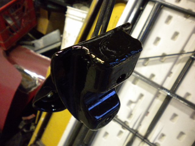

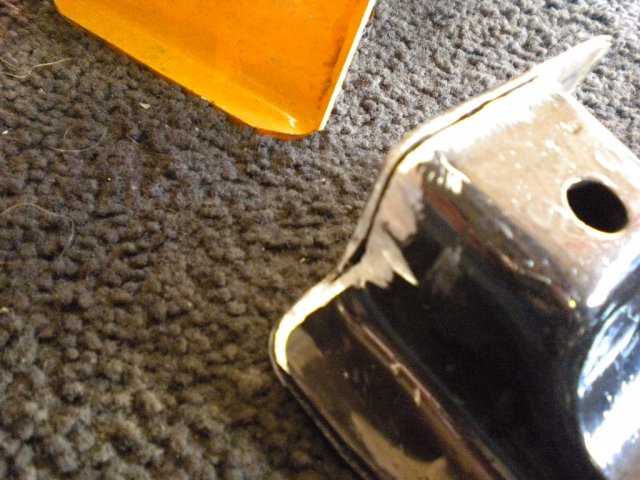

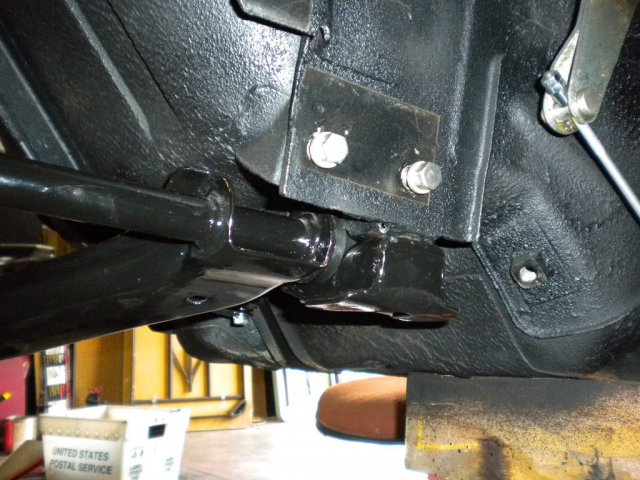

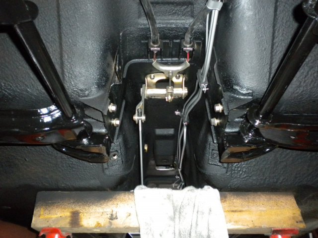

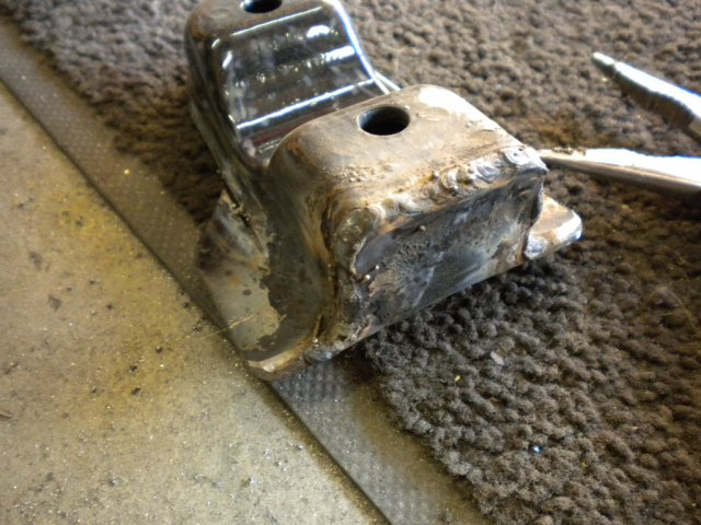

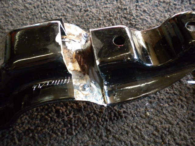

HLS30-08077 Posted October 20, 2009 Share Posted October 20, 2009 The only thing I've used on the 260Z build has been a .032?? Flux-core welder (Harbor Freight Tools Special) and it kinda sucks but at the same time, it's not THAT bad. I've learned to keep the nozzle as close to the weld (about 1/4" away) as possible. On 22 to 18 guage, I use the LOW setting and turn the speed up to 6 or 7 (On a nine scale dial) And when I welded the diff cross member peices together (pictures below) I used the HI setting and kept the speed at about 7. It welds 12 to 16 gauge beautifully, in my opinion. Especially on a tight budget. Would love to be able to afford a gas though, but I'll stick with the FC for now, it works. Dave. As you can see, the welds aren't that bad and after a little grinding and POR15, they turn out nice. ALL this in prep for the R/T mount that I'm hoping to see soon. (Hint Hint RoostMonkey) I cut out the center to make room for the dual 2" exhaust that will be added later, using the 4"x9"x22" muffler shown, which will sit hight in the tunnel due to the crossmember alteration. Quote Link to comment Share on other sites More sharing options...
