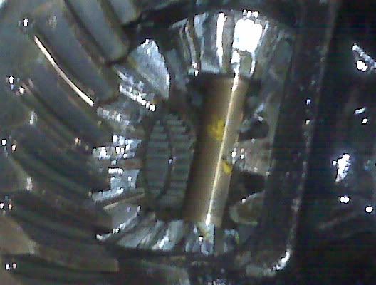

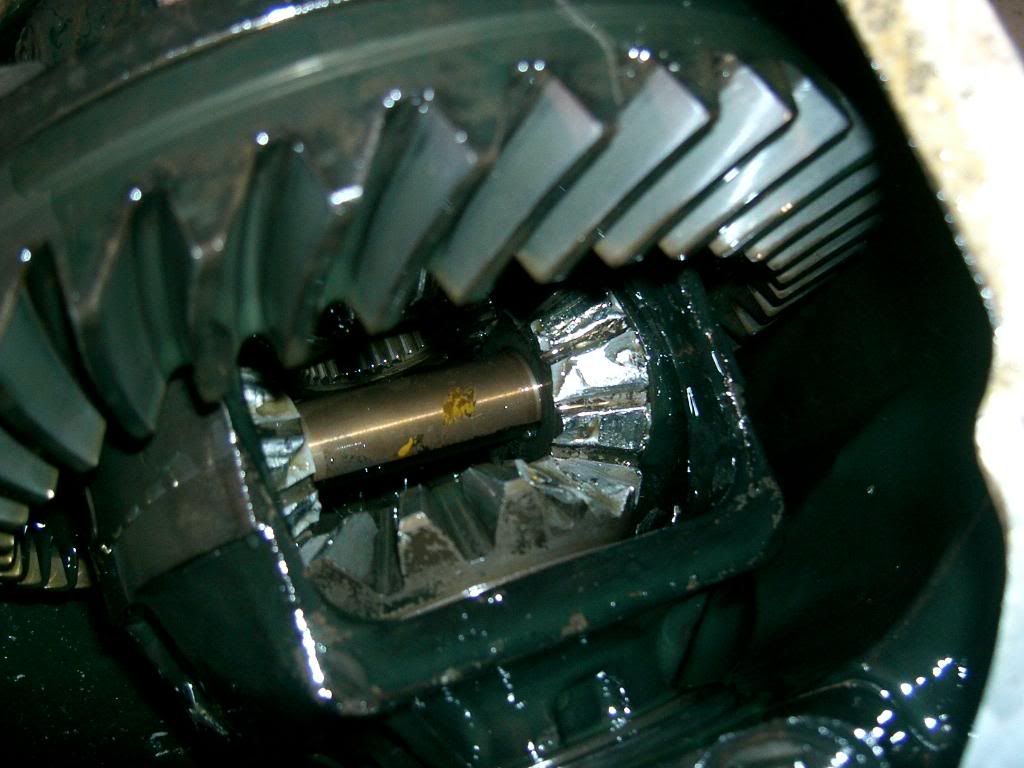

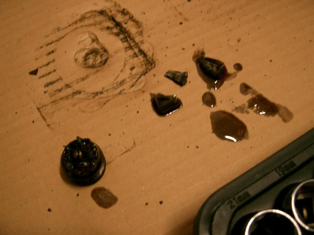

Got to work on the Z today.
George and I pulled the differential.
Decided to drain the diff before pulling the cover off since we couldn't get the cover off in the car.
Hmmmm

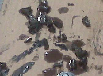

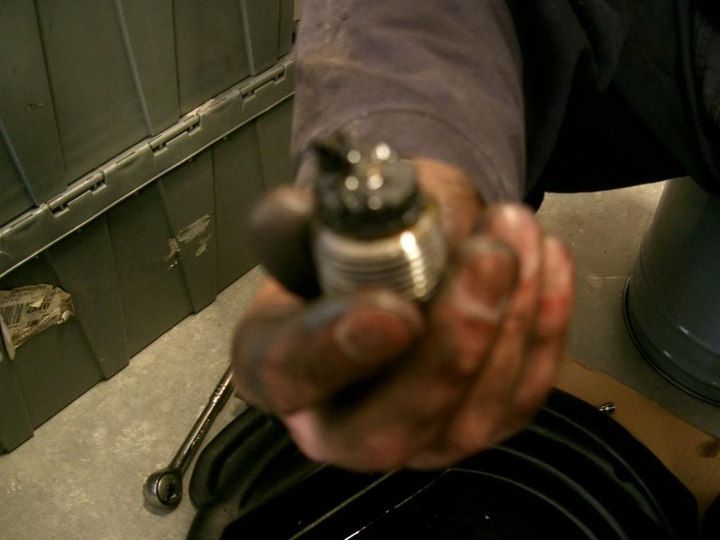

Drained the oil and through the 1" drain hole something happened...splash...

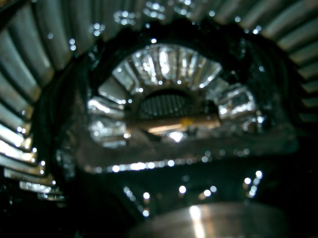

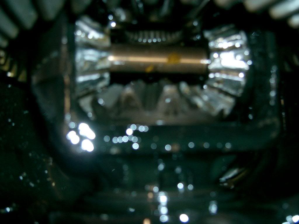

Took the cover off...something wasn't quite right
I think I might make a chain out of this... lol
Anyone have an R200 3.90 or 4.10:1?
