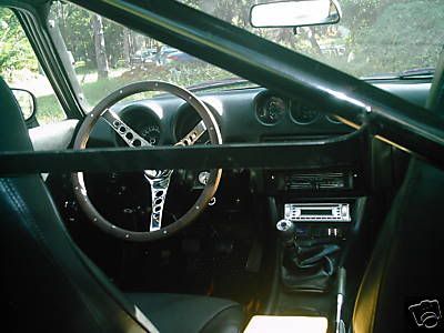

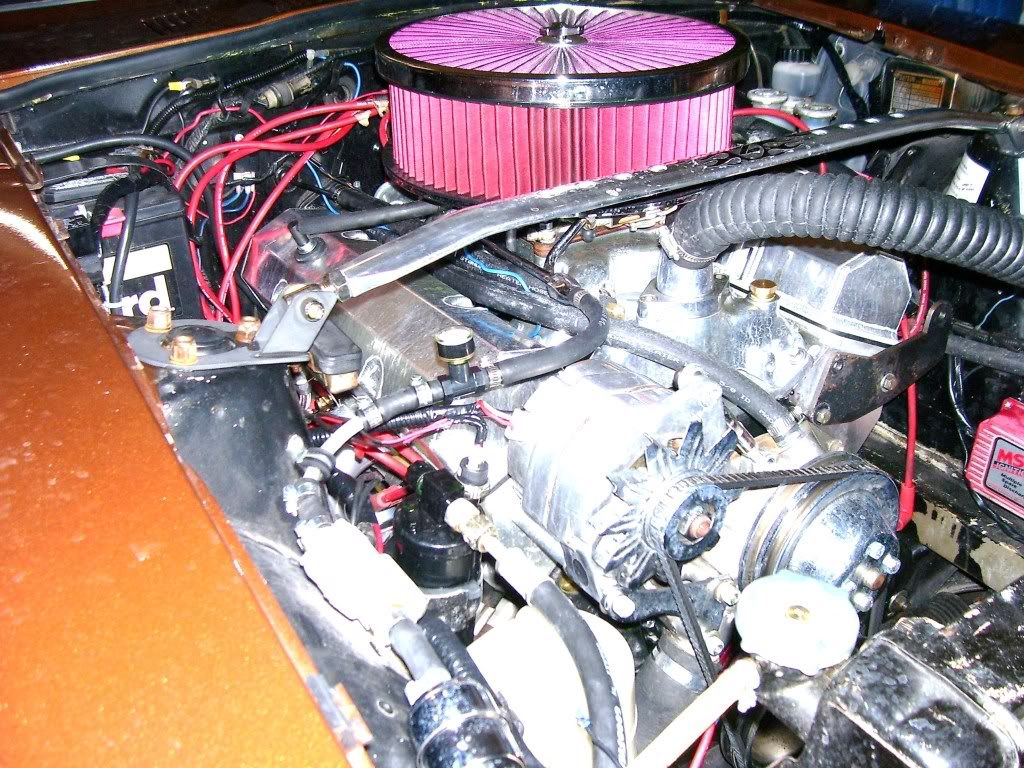

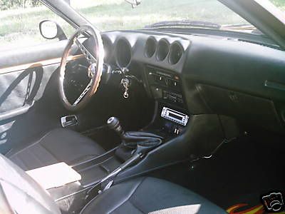

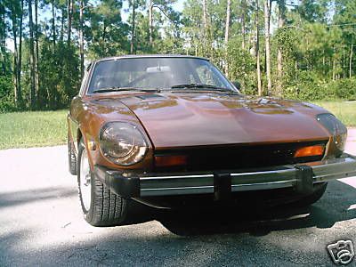

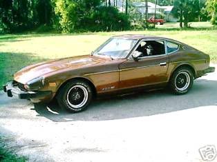

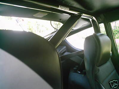

383 Z Posted November 25, 2009 Author Share Posted November 25, 2009 Well here are the pic's I have now. http://s931.photobucket.com/albums/ad157/bhcii/ The pic's of the new motor isn't very good, it over heated on the first firing before we got it timed. I'll add more pic's as I go! Thanks Jack for your help with the "how to" with the pictures! Quote Link to comment Share on other sites More sharing options...

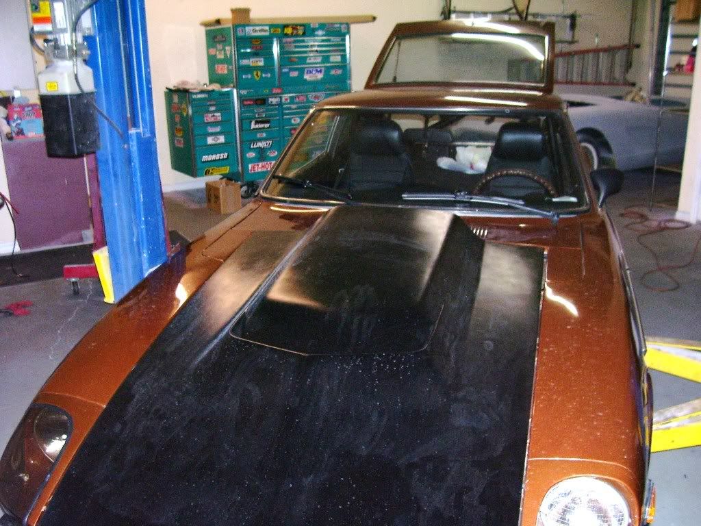

neotech84 Posted November 26, 2009 Share Posted November 26, 2009 Thanks Ross for clarifying the name........ I didn't notice that till today. My name is Scott in case any one was wondering. Here are his pics from the bucket. Beautiful motor Cowl hood Roll cage Interior More interior Side view Front Drivers side As stated by Ross, there is a section on the left when you view a pic that says "Share this image" and under that the last option is IMG code. Just click that and paste it in any post. Very simple. Or the option is the same if you move your mouse over the pic in ALBUM view (Don't Click) it will be outlined and you can click the IMG Code option. Lover your car looking forward to seeing more of it! What is the chassis in the background of the pic with the cowl? Would like to see that car. Scott Quote Link to comment Share on other sites More sharing options...
383 Z Posted November 26, 2009 Author Share Posted November 26, 2009 I'm laughing at myself for not catching that (The name)! Scott, Ross and Pyro thanks very much for the help and education with uploading the pic's. I'll give that a try with the next set of pic's. Now about the dirty pic's of the car, the water spots on the car and motor is an example of my trying new things on the car. It did over heat while we were timing it. It turns out that replacing the mechanical fan and shroud with a new electric relay fan didn't work out so well! The plug wires on it are just to get it fired up . I have a brand new set and Billet looms that should dress it up nicely. I live in Upstate New York, South of Rochester, so unfortunately the car has to go into the garage for the winter. I won’t move it when they start salting the roads! They salt heavily here! I don’t have a lift so it will be slow going but I do have heat. I will be working on it through the winter installing the VLSD R200 that I just got for it. I'll drop in and update on the project as I go, maybe I can help someone else that needs info on this install. Quote Link to comment Share on other sites More sharing options...
