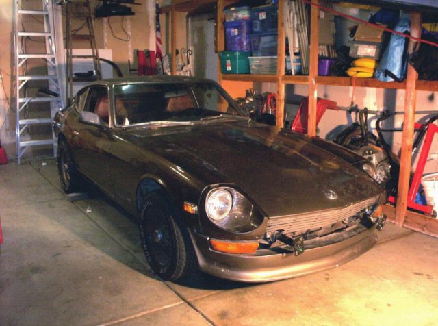

I purchased a non-running 260z donor for $350, and spent a year getting it ready for the kit. I sold off all the parts I don't need. I actually made a profit of $25.
If I hadn't had to replace the rusted floorpans ($270) I would have started way ahead.
I picked up my body kit from John at the Knotts Berry Farm Kit Car show last year. No crating cost, no delivery fee, just gas for my pickup truck, from Northern Cal and back. $4500 total.
I've spent the last year fitting panels, cutting and sanding... fixing my mistakes... and then redoing it the correct way. My plan is to do the basic bodywork myself and get the car into primer. Then install all the exterior lights. Then I'll move on to drive train (SB Chevy using JTR conversion), suspension and interior. Once it's a driver, I'll strip it down and send it out for paint.
To date I have around $5700 invested in the project. I'm estimating at least another $5000 before wheels and paint, but that will be spread out over the next couple years at my current rate, so it won't hurt too much.

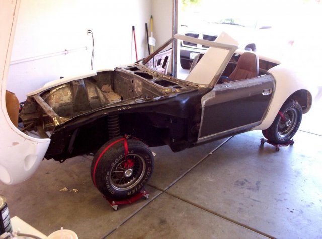

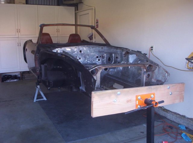

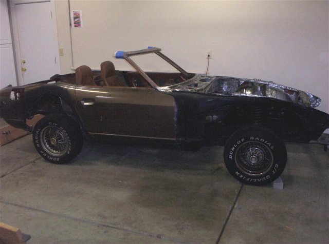

Here are a couple pics of the donor 260Z.

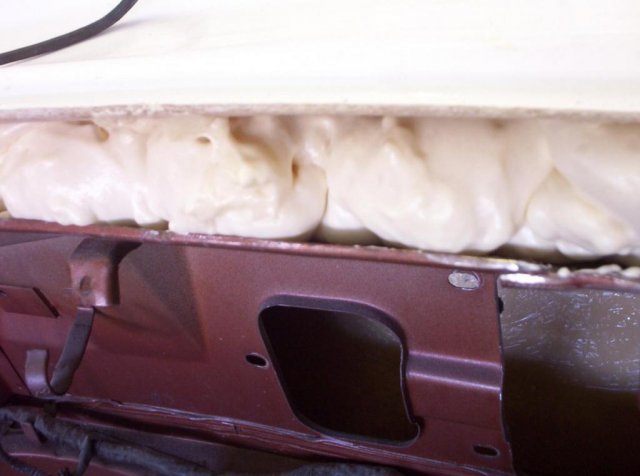

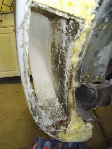

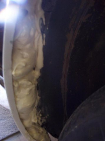

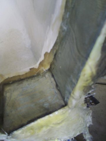

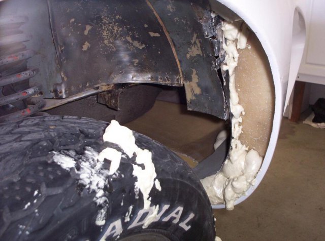

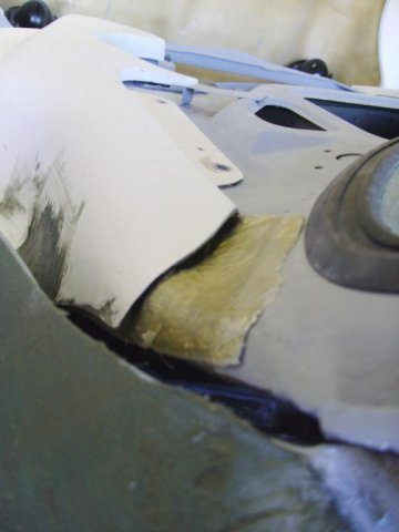

I decided to start with the rear tub. I attached the tub with a combination of short strand fiberglass adhesive and expanding foam. The fiberglass is used to attach the tub to the door jams. The expanding foam fills the gap between the old Z sheet metal and the new fiberglass body making it impossible for the tub to shift.

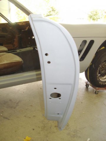

I then test fit the door skins and front quarters. The door skins are attached with adhesive and the quarters bolt on using the same holes as the original Z fenders. I could then bolt on the tilt bonnet and check for fit. At this point I should have rough trimmed the bonnet to the curved door gap. If I had I would have noticed the door skin needed to be right where it was in order to match up with the bonnet. Instead I thought that the door skin was warped, pulling away from the sheet metal of the original door. So, when I attached the skin, I pulled it up tight using sheet metal screws to hold it down while the adhesive dried.
When I remounted the quarter panels all seemed well. But when I lowered the bonnet I discovered my mistake. Many hours of glassing, sanding and cursing my stupidity later, every thing lined up.

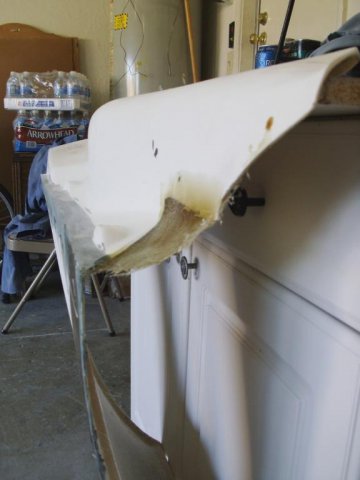

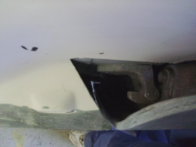

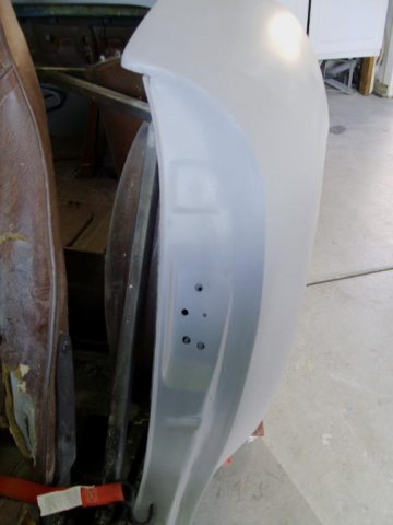

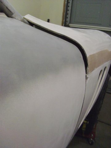

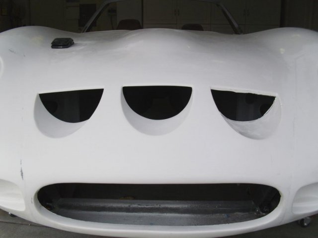

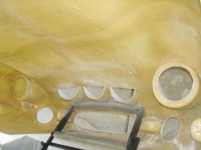

After fixing the door skin error, I turned my attention to the tilt bonnet. The bonnet must be trimmed to fit under the windshield. Once again I trimmed too much and had to recreate the proper curve with a little fiberglass work.

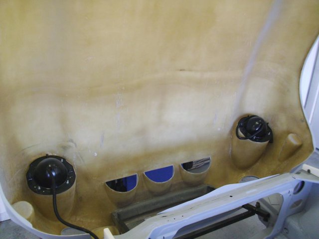

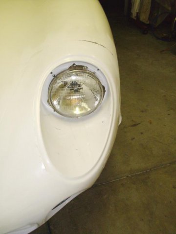

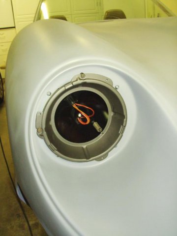

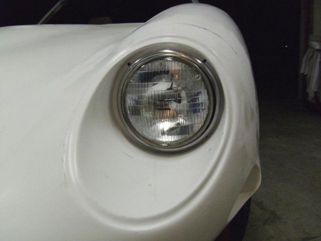

I then cut the headlight holes and hood vents using a spiral saw. It makes quick and accurate cuts. I could then mount the original headlight buckets (cleaned and painted) from the Z.
A couple chrome trim rings from a MGB finish off the lights nicely. The rings just rest on the lamps right now. If anyone knows how to make some clips to keep them in place, let me know.

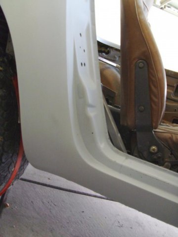

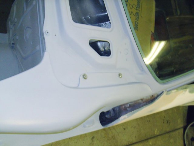

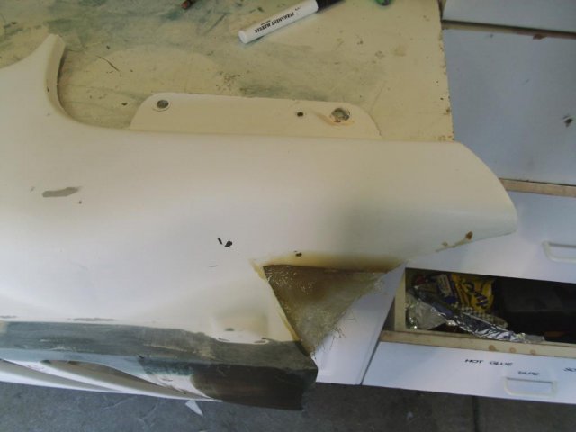

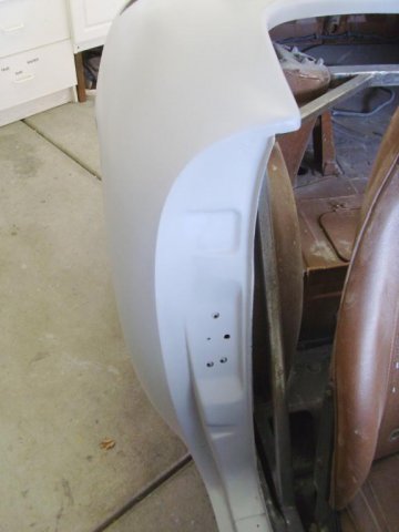

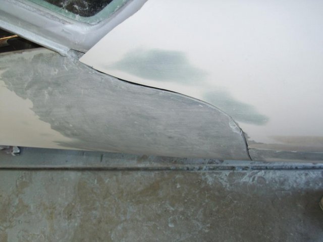

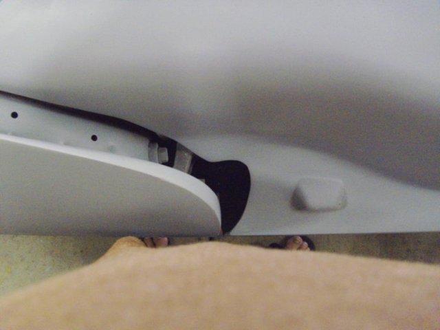

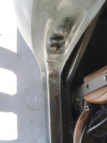

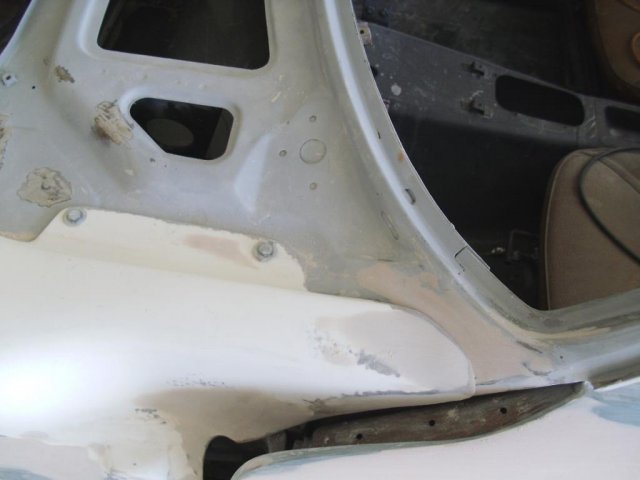

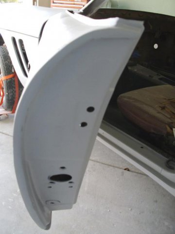

The upper portion of my quarter panels (near the windshield) didn't fit to my liking. They were too long, causing the entire piece to ride up off the sheet metal where it was supposed to bolt down. That piece also flared away from the body, keeping the rubber door seal from laying down flat.
I also didn't like the triangular gap that the front edge of the door swings through when opened. It seemed awkward and exposed too much of the hinges below for my taste.
After trimming the ends and sides of the upper section of the quarter panels, I laid down fiberglass matting to make a form fitting bottom and attached the panel with more resin, filling in the gaps with the short strand fiberglass filler.
With more matting I created a web in the triangular door gap.
After sanding and shaping, the piece now fits snug to the body and has a more eye pleasing curved door gap.
Edited by Fauxre

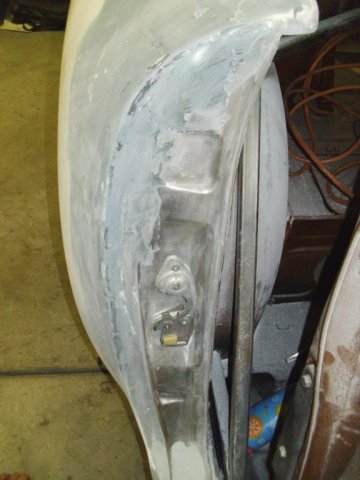

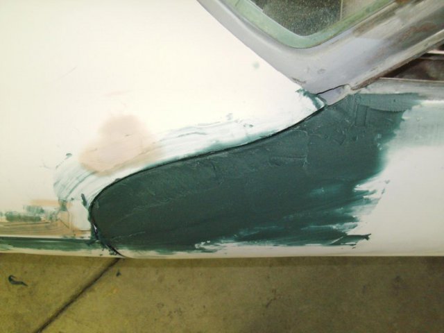

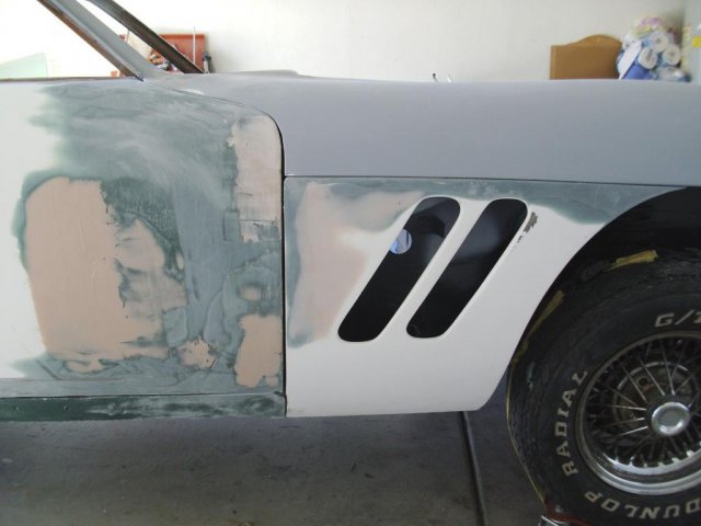

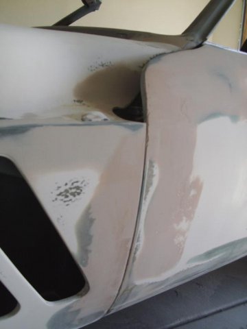

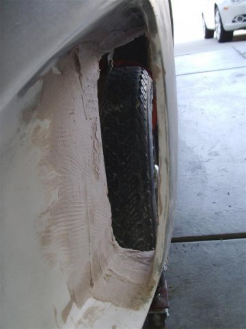

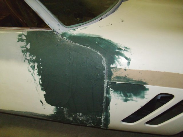

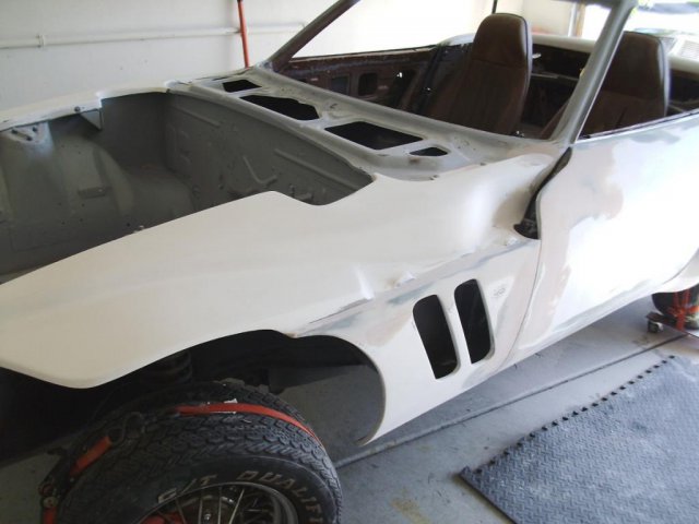

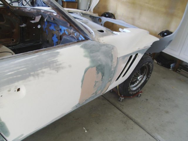

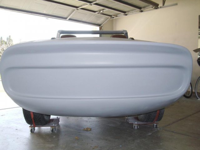

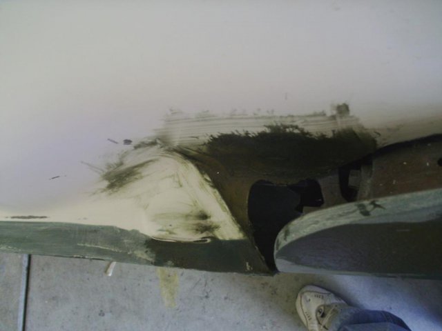

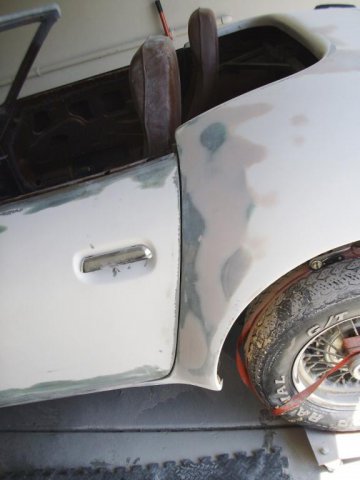

I was feeling so good about the results on my quarter panels, that I started to refine the gaps and blend the new fiberglass panels into the existing body. Starting at the front, I sanded the seams left by the molds, filled low areas with light weight body filler and cleaned up the edges of the panels.
I worked my way around the car, feathering the bottom edge of the rear tub to the rocker panel and refining the shape of the tub to match the outer edge of the new door skins. I spread many thin layers of filler and spent many hours sanding.
Edited by Fauxre

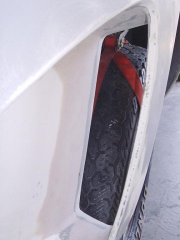

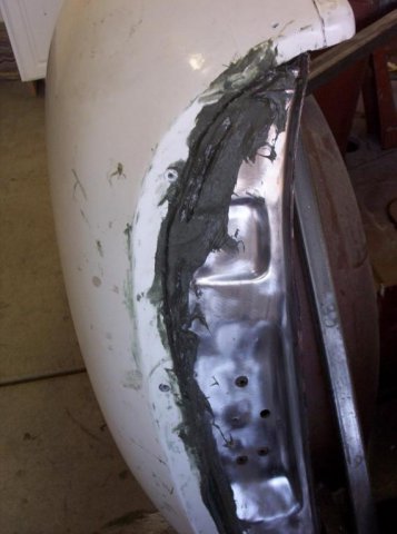

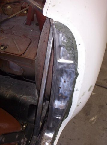

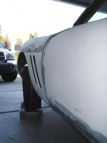

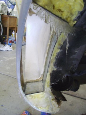

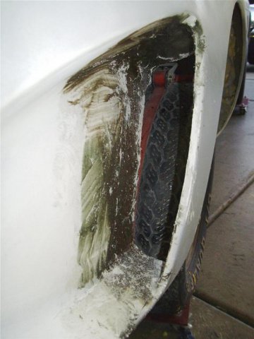

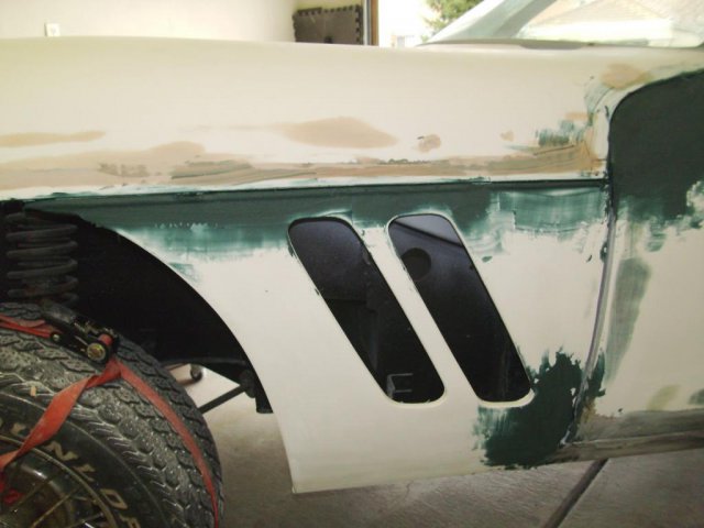

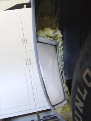

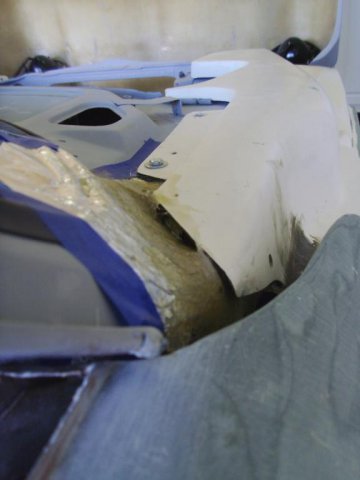

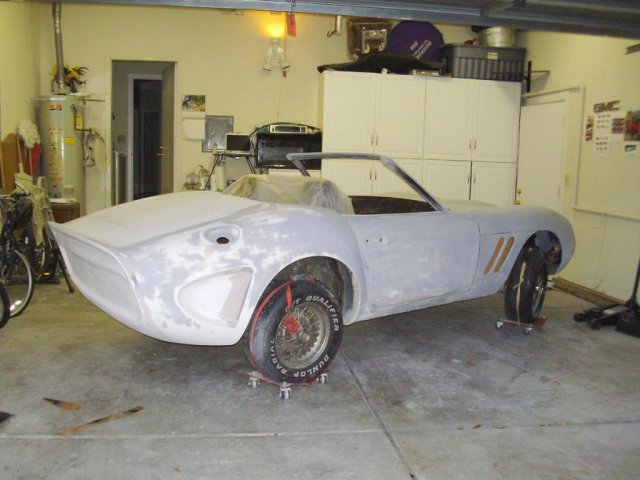

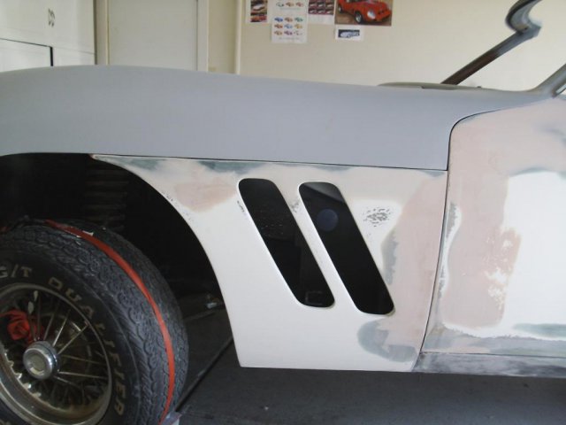

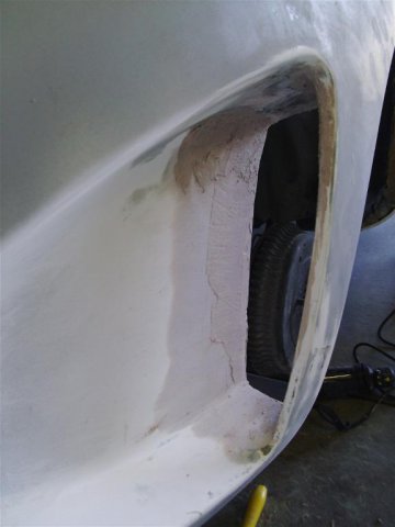

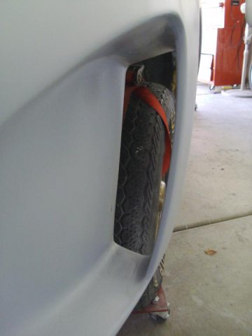

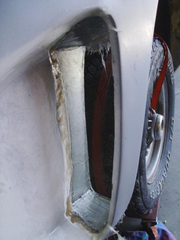

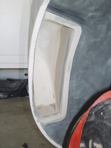

It was now time to take on my most ambitious modification yet... cutting and sculpting the rear wheel well vents.
Many builders skip this mod, preferring to simply paint this area black to look like a vent opening. I think it's the most unique feature of this body style and never considered any option except functional vents. What that function is, is ambiguous to me. I guess it was to cool the rear brakes by allowing more air flow. Whatever the case they look COOL!!!

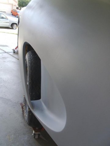

After cutting the initial hole, I fabricated a cardboard template to form the extended inner wall. Using the template I cut a sheet metal version and attached it to the back of the fiberglass with resin and matting. I lined the inside with fiberglass cloth and built up thickness with more matting. To get level with the existing fiberglass, I spread a layer of the short strand fill, and sanded. A little light weight filler and more sanding.
I fashioned a fender well extension from sheet metal to finish the look.
The series of pics below chronicles this process.

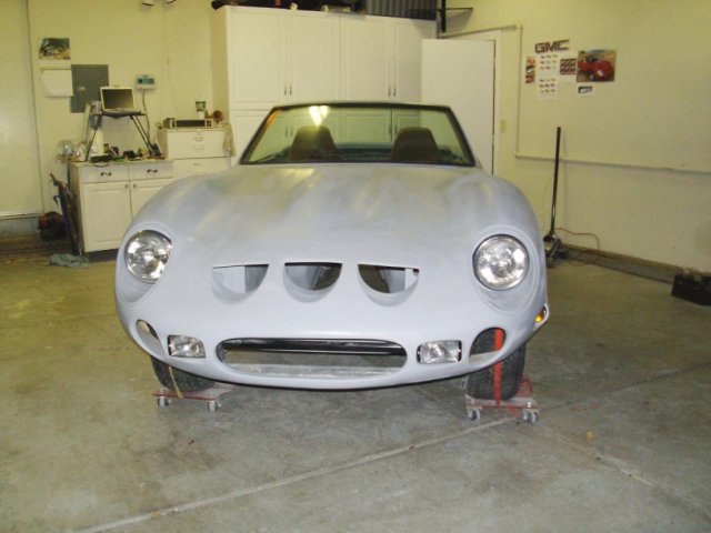

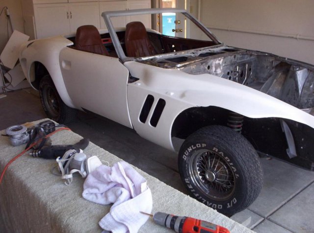

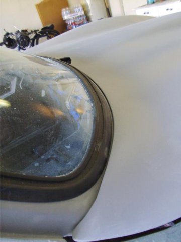

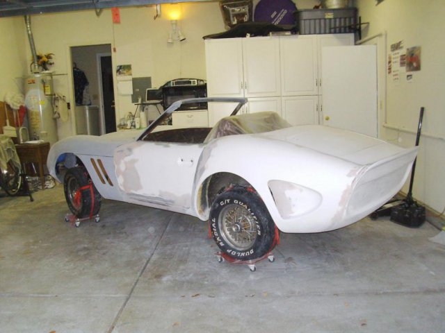

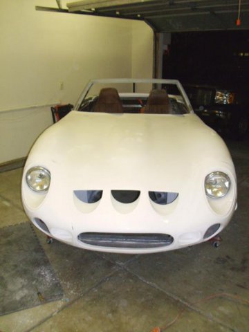

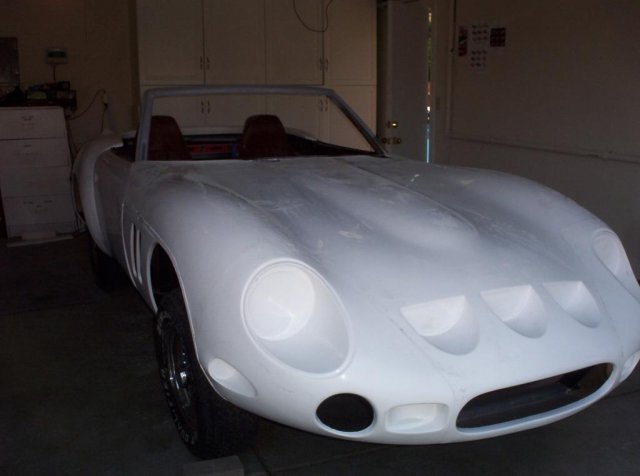

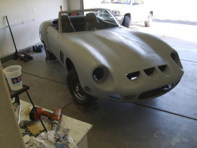

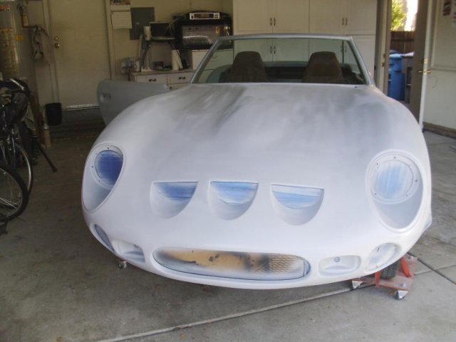

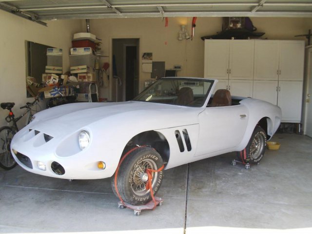

However, before moving on, I needed a little assurance that my bodywork, rough as it is, was at least "not horrible". With the body sporting so many different colors, my eye couldn't focus on shape. So I applied two coats of grey primer surfacer to the entire car. The result? Pleasing. Not perfect, but good enough to allow me to feel good about moving on. Ill leave the final prep and paint to the pros.
I've re-installed the lights up front, the door latches and handles, and the windshield.
The last three pics in this series are photoshopped concepts of this project... before final paint.

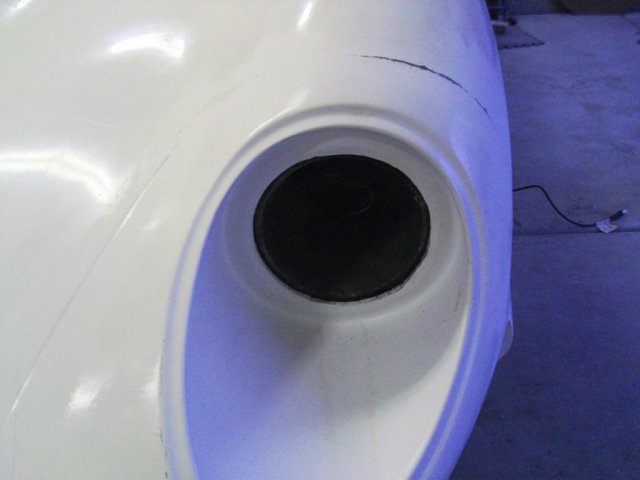

This fuel door from a Mitsubishi Eclipse might be a nice alternative to a LeMans style gas cap. Not sure if I like it enough yet... will see.
