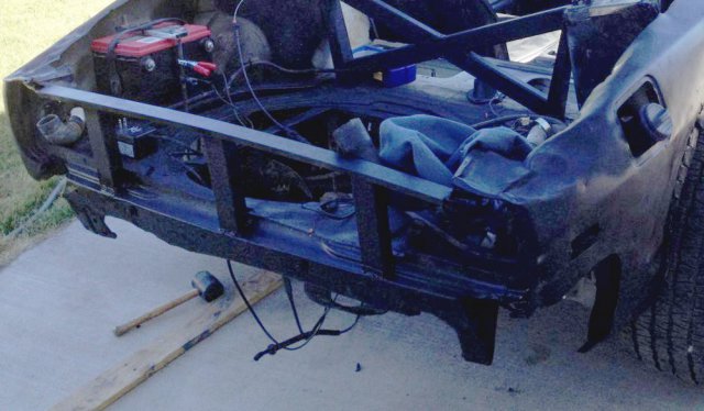

I stripped the front end and all lights last weekend.  I choose the bolt on cheek panels, and
hope that I can have the nose mounted this weekend, with the doors and rear tub to follow
the following weekend (but may drag out).  I've ordered a set C5 euro spec tail lights and
collected the pigtails to build the proper harness, which might happen after work next week.
I cut the rear fenders two weeks back in anticipation of starting (look honey, I cannot change
my mind now, it is even uglier....)

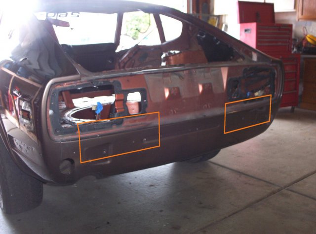

One suggestion;
I had a real issue installing my tail lights.  I don't know how deep the C5s are.  If they're more than an inch deep, and you mount them roughly where mine are, you may have a clearance issue with old sheet metal.  My lights are mounted roughly in the orange rectangles in the below pic.  I couldn't access the area very well after the tub was installed and it was almost impossible to cut the old sheet metal through the holes I made in the fiberglass. :banghead:  There are actually three layers of sheet metal forming the seam where the floor meets the valance and the rear panel.
 If you need to make room, do it before you mount the tub.
If I had to do it again, I'd weld in some reinforcement and cut out the entire rear panel.
Edited by Fauxre
Wes - You've frightened the daylights out of me with those quotes, not so much about the cost but the realization that there is so much work to be done. I dragged the 'Puckett' front section out from under the house today and rather than look at it I ran my hand over it... You're right, there are a lot of surface irregularities that are going to need bog and sanding. Oh well, what's another couple of years to completion.
The lights are scheduled to arrive tomorrow, and I will be checking that very closely.

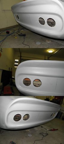

The lights are between 2.5" and 4" deep from memory.  I'm playing with a couple
designs, the lights a slightly oval, so am thinking to mount them on an angle, which
would move their center up ( / /  Plate \ \ ) or the basic ( - -  plate - - ).  A big goal is to
maintain access to the bulb sockets from inside, but that seems more and more unlikely.
Dan-  I like the angled configuration idea...unique.  I think you're definitely going to have clearance issues.
You can see here where the center of the VR rear panel falls in relation to the Z sheet metal.  The gap between the old exterior and the rear tub is only an inch or so.
I'd recommend doing something like espeery did here, in order to get good access from the inside.
The existing Z tail light holes make it awkward to access my light mounts, so I tried to make them bigger.  This resulted in a lot of sharp edges that cut my hands to shreds when ever I work on the lights.
Edited by Fauxre

That is a little more aggressive than I planned, but it is an option.  The housings
are fairly shallow, with the central socket 3.5" deep from the mount surface.
I had another layout in mind ( _ -- plate --_ ), but that would definitely cause
a depth issue.  Since I have not bonded my tub yet, I will pick the style I like,
install the lights and check the fit.  At that point I can decide if I want to do
more cutting or make small pedestals.
