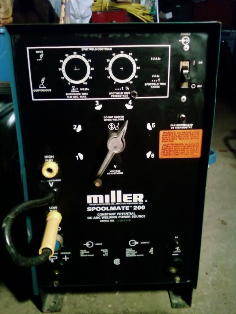

BURLEIGH Posted December 2, 2009 Share Posted December 2, 2009 Obviously I'll have to get a torch and other items, but... What do you think?? Thanks in advance! Quote Link to comment Share on other sites More sharing options...
Mike C Posted December 3, 2009 Share Posted December 3, 2009 The Spoolmate 200 is a constant voltage machine to run the spool gun, ie a MIG welder. You need a constant current machine to TIG. Quote Link to comment Share on other sites More sharing options...
