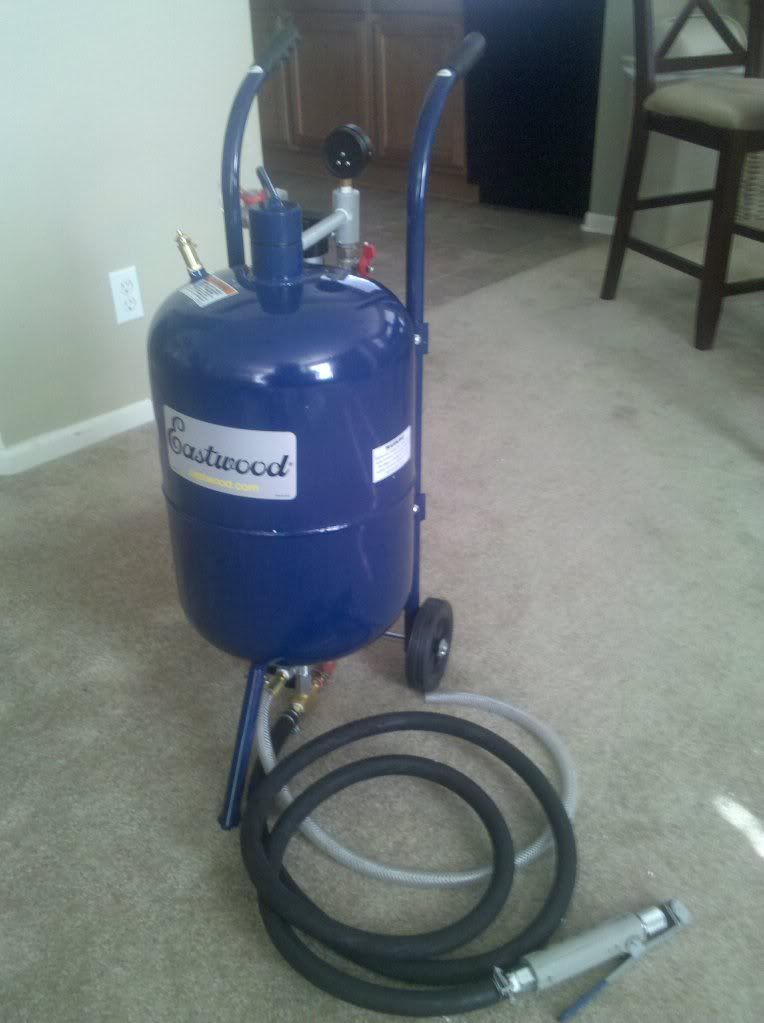

proxlamus© Posted March 29, 2010 Author Share Posted March 29, 2010 well... months later.. I just bought the Eastwood Soda Blaster this morning.. FREE shipping which is nice! Saved $66!! As soon as I get it, Ill take pics, a quick video and write up a review. I believe they said it was on back order till the 9th. That will give me time to build a nice enclosure so I can blast in my garage without worrying about soda and dust ALL over the garage. Should be interesting!! If it sucks.. Ill sell it or return it lol. Quote Link to comment Share on other sites More sharing options...

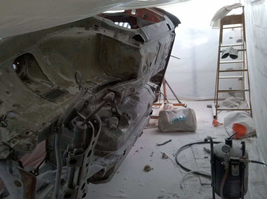

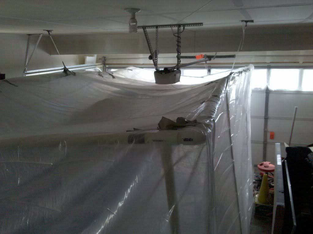

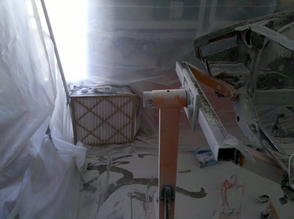

proxlamus© Posted April 5, 2010 Author Share Posted April 5, 2010 Well well.. what an experience.. I received the Soda Blaster from Eastwood .. I was able to assemble the unit fairly easily.. but the hoses were practically glued to the hose barbs, so I had to cut them with a razor blade and add some grease for the next time I need to remove the hoses. I built an enclosure in the garage out of PVC and 3.5 mil plastic... cost about $80 or so. I added a IN and OUT fan... which turned out to be a bad idea.. the IN fan pushed more air then was coming out.. even with the IN fan set to SLOW and the OUT fan set to FAST.. so soda blasted out of the enclosure and covered the garage. I blocked the IN fan and just kept the OUT fan on and kept the room in a negative pressure, which was pretty effective. I was able to work for about 20 min before the room became soooooo dusty the visibility was so bad I couldnt see the end of my car.. so I took a break. Once I adjusted the valves I got the soda blasting really smoothly.. I was able to work with about a 3/4"-1" diameter blast zone, one quick pass got the clear coat off, the next pass removed the paint, the next pass removed the primer. It works fairly quickly.. but imagine scrubbing a car with something the size of a quarter. itll take a while. I will use a sander and grinder for the big body parts, and use the soda blaster to get in areas that I cant reach with a orbital sander or angle grinder with a wire wheel. I went through about 50 pounds an hour.. I purchased the XL (coarse) soda from Harbor Freight for about $39 ea. so thats almost $40 an hour to operate this. I could imagine easily going through 600 pounds on a car that hasnt been touched.. I WILL be re-using the old soda all over the floor.. and will strain it all out. Hopefully itll work ok as a fine media. Quote Link to comment Share on other sites More sharing options...

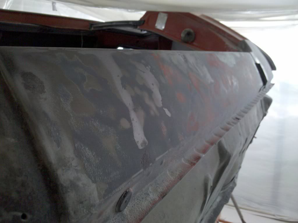

proxlamus© Posted April 6, 2010 Author Share Posted April 6, 2010 Oh BTW... I would NOT recommend blasting an entire car with this. It will simply take too long and the bags of media will add up very very fast. I would take it to a shop or RENT a towable blaster. I will use this for blasting parts and getting into the cracks and areas that a hand sander cant reach. Quote Link to comment Share on other sites More sharing options...
proxlamus© Posted April 17, 2010 Author Share Posted April 17, 2010 Ive learned a few things over the past week or so.. First.. use a Dual Action Sander on the car, then use the sandblaster for hard to reach areas Second.. if you build an enclosure like I did.. I tried using duct tape and 3 mil plastic and PVC for a frame. I would duct tape the plastic to the PCV, which didnt turn out to be too successful. I had leaks all over when I put the booth in positive pressure and the plastic would fall all over the place. I bought a can of Heavy Duty Spray Adhesive.. which is AWESOME. It really seals the booth and I havent had any issues with the plastic falling apart or leaks causing my garage to be encapsulated in a cloud of dust Quote Link to comment Share on other sites More sharing options...
