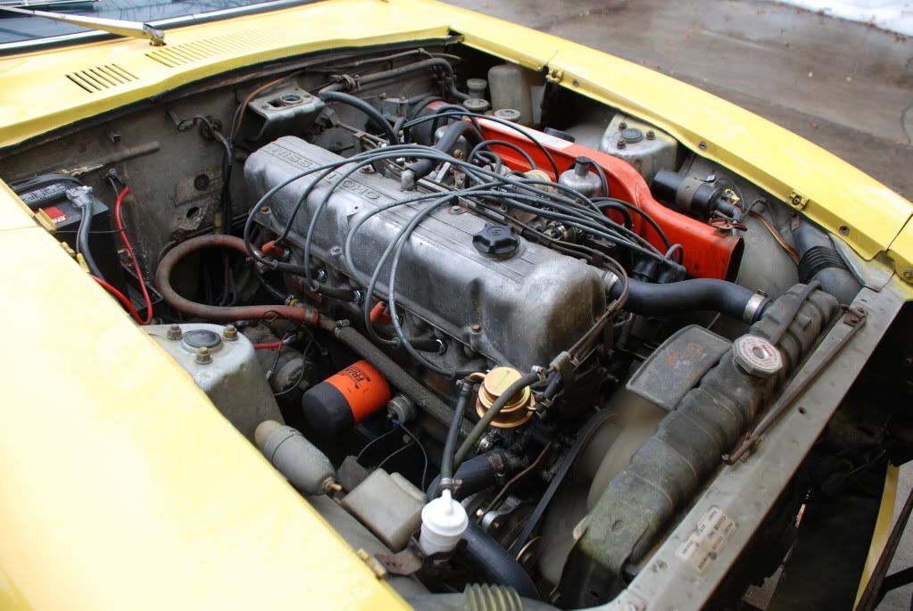

OH!!! There's your problem w/ the heater! see that big red hose that's looped back around to the engine by the battery?? that's supposed to feed through the firewall and into the heater core. that's why you have no heat!! I would suggest you look into an aftermarket/NOS heater core, then reconnect it so you'll have heat. No doubt there's a leak or something in the old one is why they're bypass it like that.
Z really looks good. You might look also into the 240z fuseblock replacement. that, I've heard is a big plus when working on 240z electricals. it's plug n play too. Read everything you can find on here about your car. there's tons of good info. oh and check your floorpans! they're notorious for hiding rust. due to cowel leakage.
oh and you might want to bolt that fender back on, it's missing all its mounting bolts.

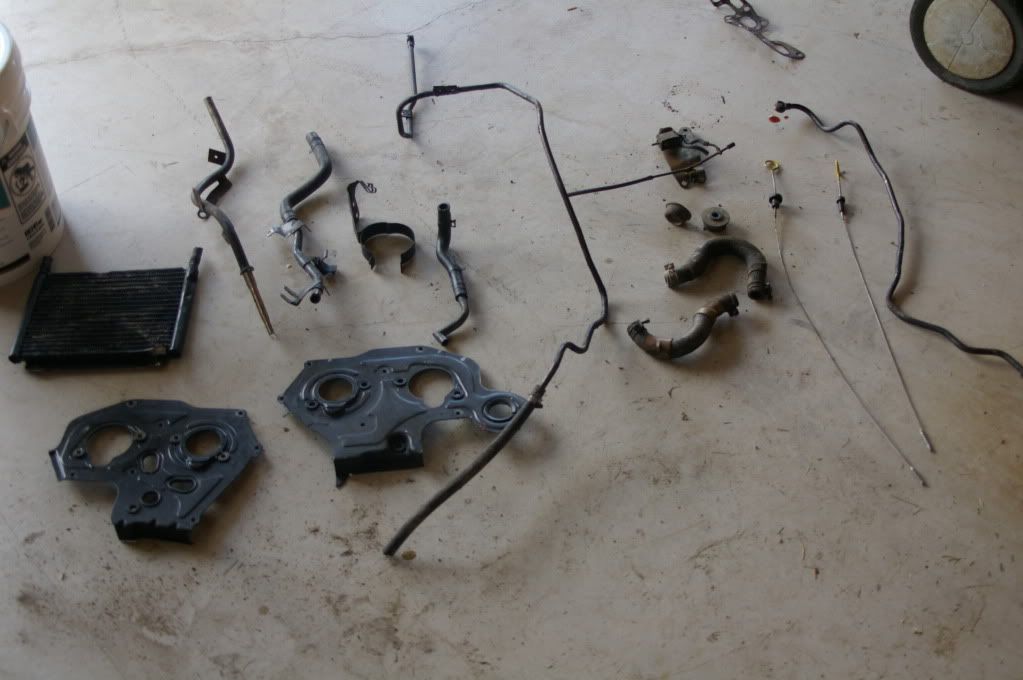

Picked up a few parts locally
4runner newly reconditioned brakes with new brake pads
2 Subaru power steering racks.
McKinney 240z to Rb26det motor mounts and tranny mount. New. Never installed.
Also picked up some power locks, and Power window assemblies.
Project is getting started now that I am throwing money at it!
