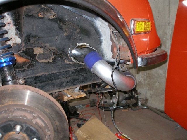

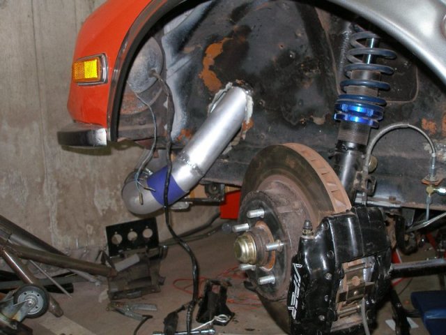

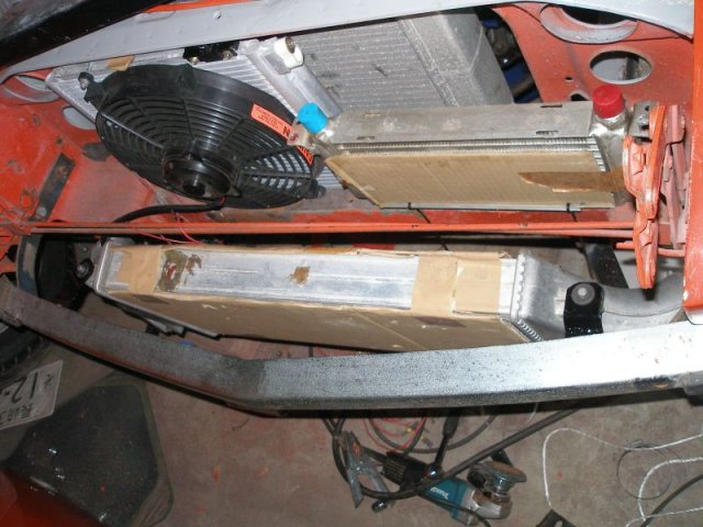

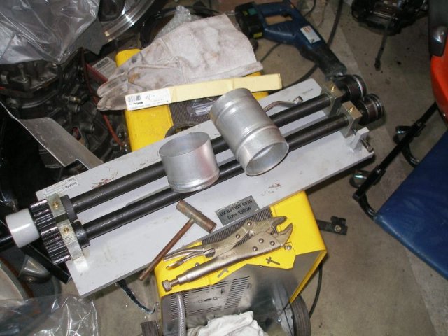

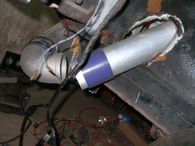

KAZU Posted April 20, 2010 Author Share Posted April 20, 2010 (edited) Intercooler is from BNR34. Lower brackets were welded at the tow holes and upper brackets were made to be bolted with bumper by its brackets. Left side. Some welding was needed. I don't have any tube beader but I thought a bead roller for flat sheet metal may be used if the tube is large enough. After some practice, it worked. Tubes are assorted mandrel bent and 3 bent cast pieces. This is the only one had to be welded. Left side. Right side. Single air filter should be located around there. Edited April 20, 2010 by KAZU Quote Link to comment Share on other sites More sharing options...

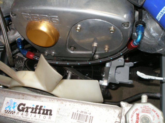

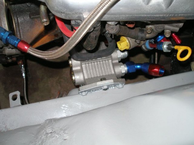

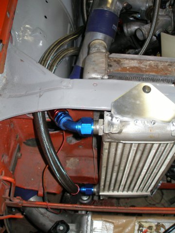

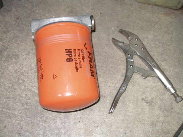

KAZU Posted April 20, 2010 Author Share Posted April 20, 2010 Remote oil filter is FRAM HP6. I didn't think I can put this huge into S30 engine compartment. Here I found some space. Filter replacement job can be done without mess. My stock of -12 hose limits the oil cooler location. I hate Earl's. Assembly of -12 hose ends needs arm wrestler. My favorite Russell nylon braided hose Quote Link to comment Share on other sites More sharing options...

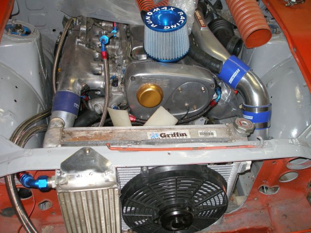

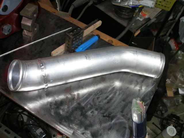

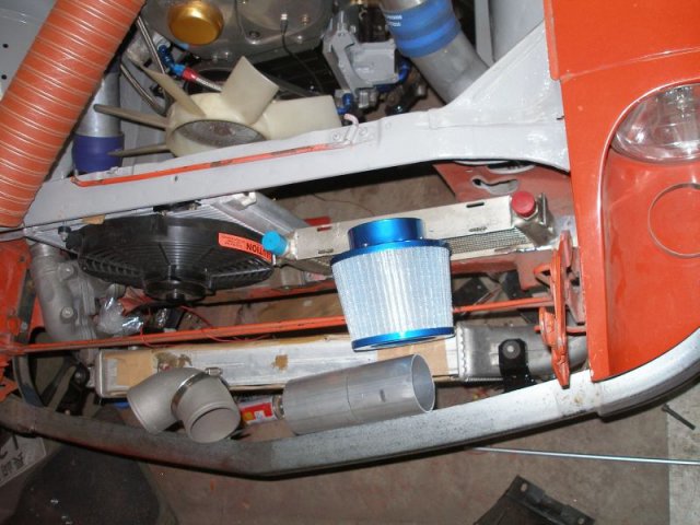

KAZU Posted April 20, 2010 Author Share Posted April 20, 2010 There is no room for box air filter container. I fabricate a aluminium duct. Time consuming job has done. Quote Link to comment Share on other sites More sharing options...
