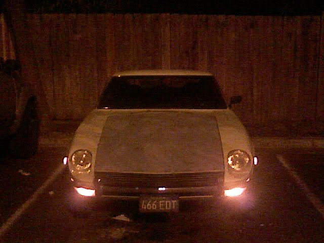

Dadaluma Posted February 15, 2010 Author Share Posted February 15, 2010 hey guys swapped the fuel lines and fired up almost immediately, it is so funny how i could be so careful with connecting all of the wiring and do something like hook up the fuel lines backwards, anyways here is a pic and a video. my car the engine is going into. Quote Link to comment Share on other sites More sharing options...

sileightygx Posted February 15, 2010 Share Posted February 15, 2010 glad you got everything worked out. how are you liking the Z with a VG30 so far? Quote Link to comment Share on other sites More sharing options...

Dadaluma Posted February 16, 2010 Author Share Posted February 16, 2010 the engine is not in the 72 yet but it really pulled hard in my z31 @3050 lbs so in the 240 it should be pretty quick Quote Link to comment Share on other sites More sharing options...
