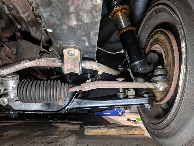

  1. Thank you Tim, I am having a bit of a dubious day so that is why I am asking you geniuses. Very good info you posted. This is why I do not want to start lowering the spring itself. It is setup without any pre-load and only hand tightened with strut at its max height and not lowered down at all so the shock has it's normal travel for this coilover. The springs are different pairs, so 6kg/mm is the front pair, and 5kg/mm is the rear pair.

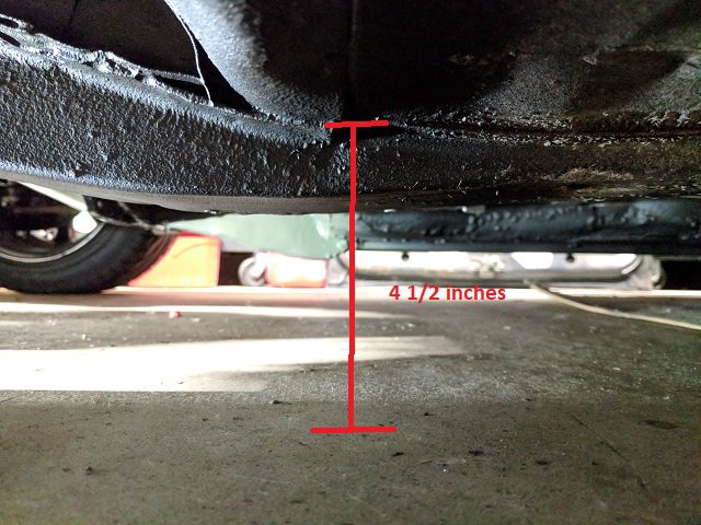

  2. Chuck thank you so much for the detailed post. For the ground to the seam of firewall/floor just slightly above the rail it is 4 1/2 inches. I marked the below photo with how I measured. Floor level picture of the suspension (you can see the coilover threaded to about where the inspection hole stops). I also do not have a bump spacer installed, and the nub left over from the original strut is about 1/2 inch. Also awesome pictures! Appreciate the time you took to detail everything out for me.

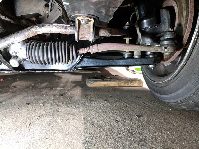

  3. It's probably the angle of the picture, but the control arm is parallel with the ground. There is no contact with any part. I didn't add any preload either, just tightened the spring lower perch barely hand tight. I do not want to adjust the height via the spring either, and that is the odd part since others have much more adjustability with just threading the shock body down. All corners have the coilovers installed as well. Yup! You are right they are 6k front / 5k rear, was just saying without any weight to compress them all the springs are 7 inches tall. I could bring down the spring perch, but from others experiences I have heard of they have not had to do this which is the problem. So I think maybe the coilovers itself are too long (stance shipped wrong ones?) I am not trying to super dump the car, and am just trying to figure out why the front height adjustment via threading down in the weld on tube is so much less than doing the same in the rear. Is that kind of adjustability normal with this setup? If someone has a set can you kindly measure the front coilovers? Preferably from the top of the threaded portion to the bottom?
  4. I thought about that too, but measured all of them and they are the same. Would make sense since I believe they are four s13 fronts (could be wrong?). The springs are also all 7 inch springs.

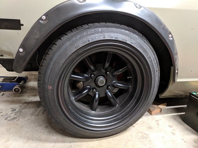

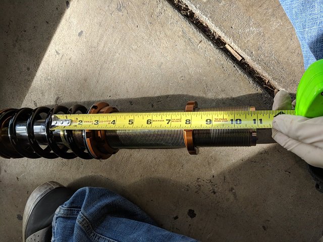

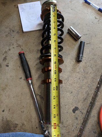

  5. Thanks for the info guys. Yeah I really don't know wth is going on with this install. Engine is installed as well so there is weight on the front. Spring is a 7 inch spring. Rates are 6k front 5k rear. At first I thought my flares were installed out of wack, but measured from body and front is definitely way higher than rear. Just trying to eliminate some variables. Included the below pics of install: Height Threaded all the way into the stance 6 inch tube. The bottom of the threaded portion below the inspection hole on the side of the stance weld on tube. Coilover is 16 inches in length from top spring perch to bottom. Shock body is fully extended. Coilover body is 11 inches from top of threaded portion to bottom

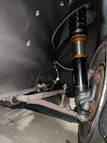

  6. Any users have this kit installed with the Sakura Garage supplied camber plates? Did the installation on a 71 240z and with the coilover threaded all the way down into the tube the front is almost stock height. The original strut was chopped and less than an inch was remaining when the tube was welded on. All arms have travel and are not stuck on anything. Funny enough the rear is only threaded into the tube 2 inches and is way lower than the front. The springs have zero preload and aren't tightened more than hand tight. Anyone run into this? Talked to a few people who had them and they have so much more height adjustability than I do in the front. The coils are the older stance super sport and are the same length on all four. Thanks! Also wanted to clarify no blame is being placed, just some confusion and welcome tips or if anyone spots something amiss.
