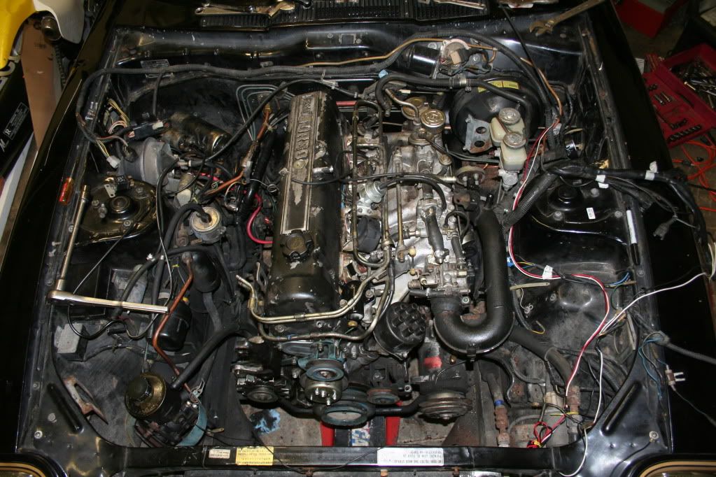

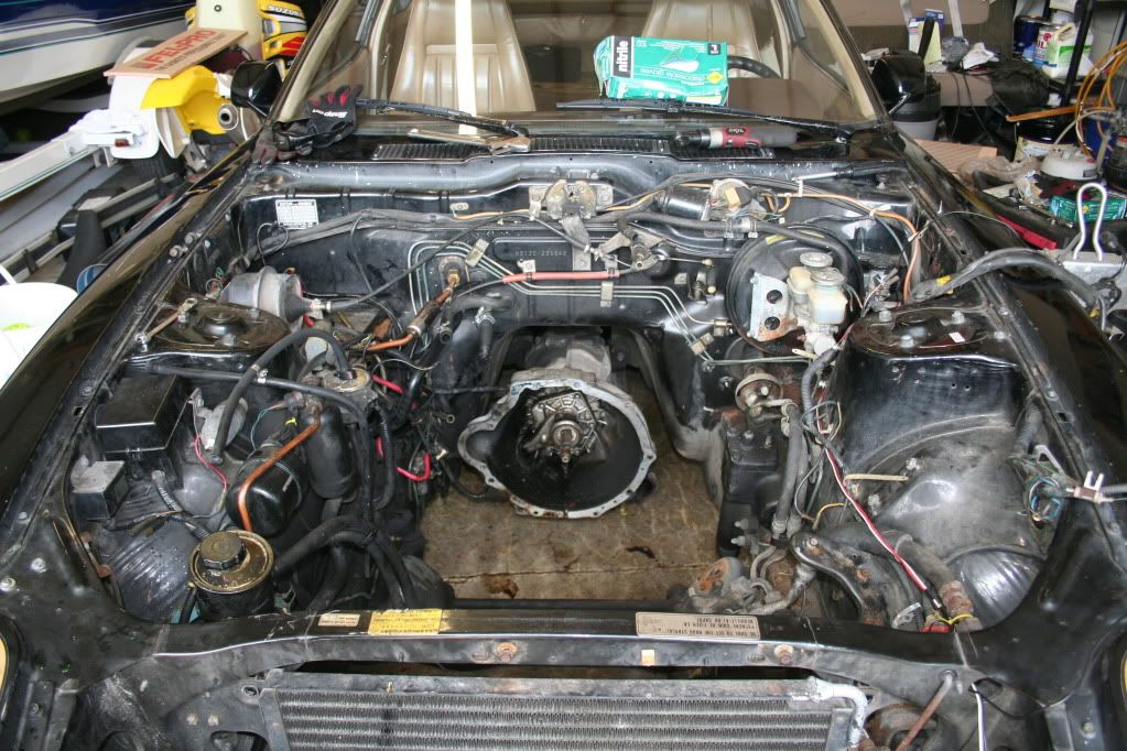

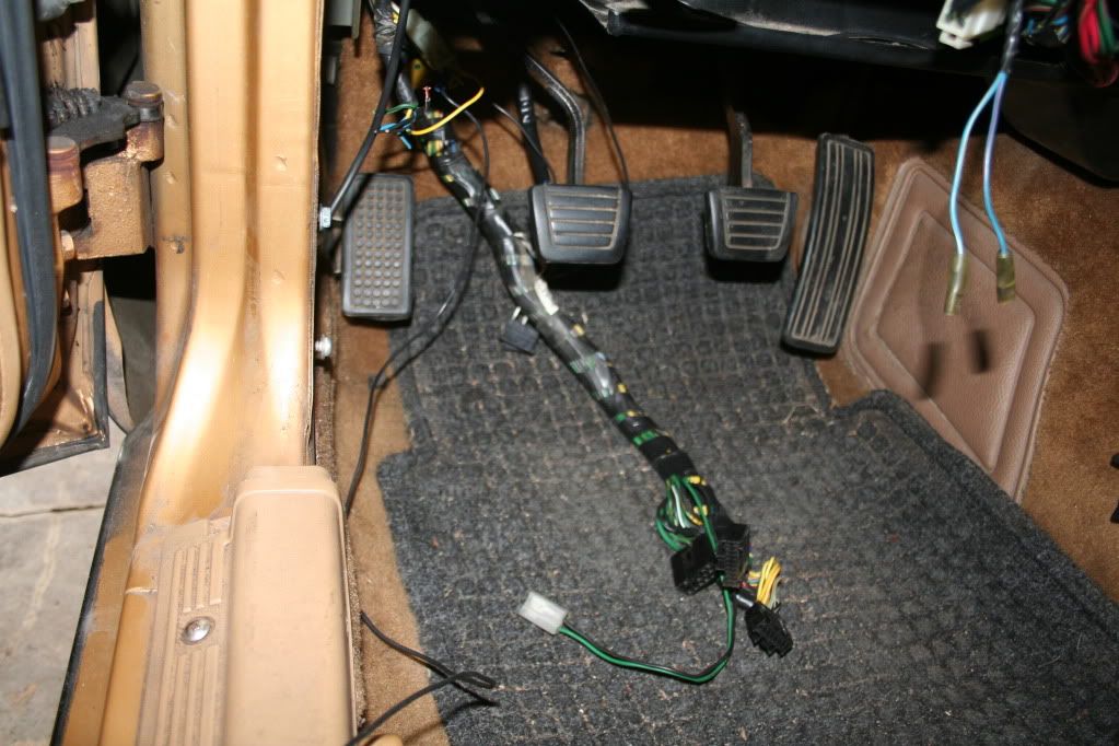

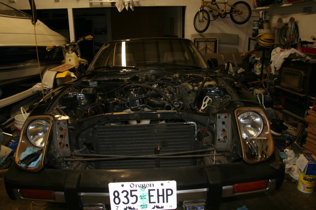

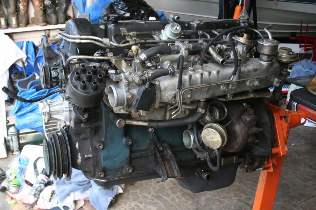

abc_was_here Posted June 25, 2011 Author Share Posted June 25, 2011 (edited) Well worked on the car finally now im just working on pulling the harness out! my ever delightful girlfriend helping Shes having fun! NO motor After all new gaskets and water pump. Also basic cleaning of intake ports and ported the manifold for a 60mm throttle body. along with cleaning the block itself up..hopefully a few days of degreaser and a pressure washer can help.. Edited June 25, 2011 by abc_was_here Quote Link to comment Share on other sites More sharing options...
abc_was_here Posted June 27, 2011 Author Share Posted June 27, 2011 Well Ive got almost all the wiring in and done. The only thing im running into issues with is the coil wires. Other then that the block is almost ready to drop in within the next day or two. Quote Link to comment Share on other sites More sharing options...

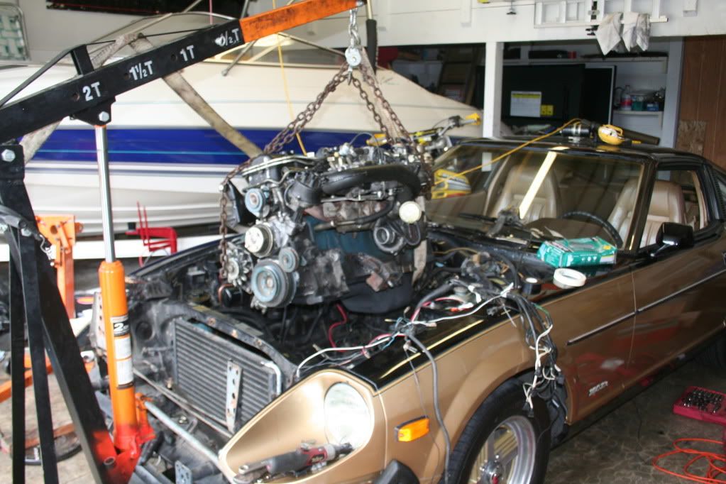

abc_was_here Posted June 30, 2011 Author Share Posted June 30, 2011 Getting the harness in the firewall Slowly dropping the motor down MOTOR IN! I almost didnt car enough off the waste gate mount though... Quote Link to comment Share on other sites More sharing options...

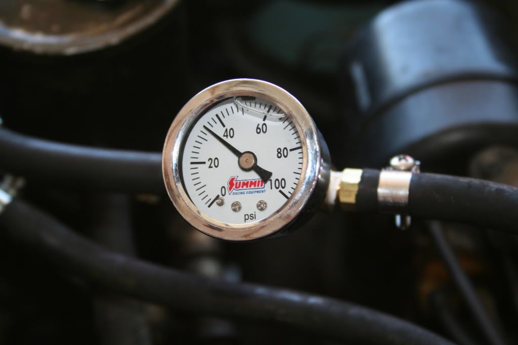

abc_was_here Posted July 17, 2011 Author Share Posted July 17, 2011 Well the car runs and drives pretty darn good at lower rpms and not in boost. It seems to miss once I hit any kind of boost. I also still cannot figure out why it wont idle. Im guessing a few hoses I have might be a problem. May also be a AFM problem as the PO decided it was a good idea to play with the mechanisms inside. I still need to clean up the wiring by the coil cause I was still playing with it hoping for it to be a factor. I also think Ive got leaky injector. it holds great fuel pressure for around 2-3 hours. Oh well I guess I just need more time to work on it. Two jobs makes things a little difficult. Quote Link to comment Share on other sites More sharing options...
