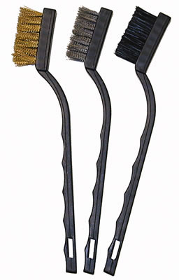

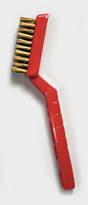

grumpyvette Posted February 24, 2010 Share Posted February 24, 2010 one factor many guys over look is cleaning and degrease parts, I like most guys started out using a 5 gallon bucket and a brush and some diesel fuel to clean parts , and degrease bolts etc. now once you get used to working with degreased components you'll start to wonder why you ever worked on cars without a parts cleaner/washer as it helps a good deal. now obviously use of flammable diesel fuel as a solvent is not ideal and detergents mixed with solvents and water are highly preferred, from a safety perspective, and you don,t want to use anything that evaporates quickly, stinks while in use or something that's overly corrosive or expensive for obvious reasons but once you've used a parts washer with a sprayer , drain and pump you quickly get spoiled and can,t consider working on a car without using one to clean components and get the crud out of bolt threads etc. http://www.asedeals.com/partswashers2.html having a pump that plugs into 110 volts and a drain with some type of filtered screen is obviously a big improvement over just soaking parts in diesel fuel, and a whole lot safer. and having a couple brushs and a constant stream of solvent sure helps. having a parts washer large and sturdy enough to let you soak a pair of BIG BLOCK CYLINDER HEADS and strong enough to support the weight of a bare block is a HUGE advantage, and it needs to have the OPTION to securely bolt to a wall or the floor for safety reasons as you don,t want it to tip over, as you turn a block or cylinder heads over so think thru your purchase, don,t just select on price alone http://www.popularmechanics.com/automotive/jay_leno_garage/4213287.html http://www.homedepot.com/webapp/wcs/stores/servlet/ProductDisplay?storeId=10051&productId=100648187&langId=-1&catalogId=10053&ci_sku=100648187&ci_src=14110944&cm_mmc=shopping-_-googlebase-_-D25X-_-100648187&locStoreNum=6379&marketID=2 http://www.youtube.com/watch?v=IeCDxcoNXNY http://www.amazon.com/Advanced-Tool-Design-ATD-8527-Gallon/dp/B000OUXAEE/ref=sr_1_2?ie=UTF8&s=automotive&qid=1266865000&sr=1-2 http://www.amazon.com/Northern-Industrial-20-Gallon-Portable-Washer/dp/B002FV6NHG/ref=sr_1_10?ie=UTF8&s=automotive&qid=1266865000&sr=1-10 http://www.asedeals.com/RangerPW.html http://www.summitracing.com/parts/CLK-MT1110B/ heres (below) some rather cheap and rather flimsy but fairly useful parts washers for light duty use, but hardly something youll want if your equipping more than a hobby shop http://www.harborfreight.com/cpi/ctaf/displayitem.taf?Itemnumber=7340 http://www.harborfreight.com/cpi/ctaf/displayitem.taf?Itemnumber=94702 once more ID point out that having access to a decent welder and building your own custom version will be a cost saving and far less expensive option at times, and a decent start point can be a large stainless steel sink , surplus used restaurant supply stores and old restaurants can be a great source of stainless tables and larger sinks that can form the basis for building a cost effective parts washer http://forum.grumpysperformance.com/viewtopic.php?f=60&t=1669 http://forum.grumpysperformance.com/viewtopic.php?f=27&t=81 how many of you gentlemen use or own a parts washer? how many built their own? how many guys want one? Quote Link to comment Share on other sites More sharing options...
