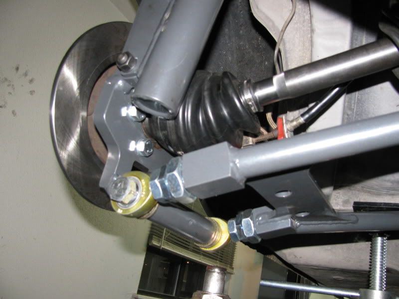

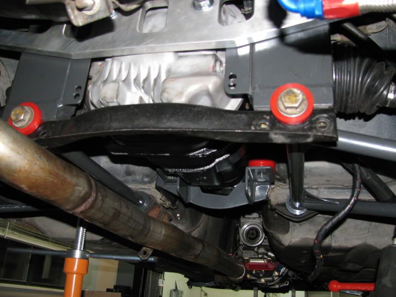

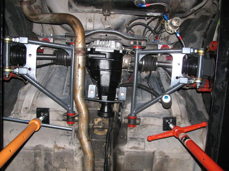

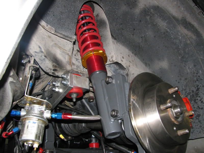

dwarlick Posted March 13, 2010 Share Posted March 13, 2010 I am in the process of a complete TTT suspension and custom R230 install and wanted to share some pics of my progress. I have been through the stock R180 and an R200. I'm hoping this will be my last differential installation. The fitment is good but did require a little more cutting on the crossmember than I wanted but it should be easy enough to augment that area at a later date. Quote Link to comment Share on other sites More sharing options...

RB26powered74zcar Posted March 13, 2010 Share Posted March 13, 2010 That looks great my friend! What rear spindles are you using to get the 4 lug? Can you explain the extra cross member cutting you mentioned pleeze. Quote Link to comment Share on other sites More sharing options...
dwarlick Posted March 13, 2010 Author Share Posted March 13, 2010 zin, I went with the R230 for a couple of reasons. 1st I don't want to change my diff again. B, I was thinking I was going to have an oem rear axle situation which did not happen. I thnk the short nose r200 would be fine with a after market LSD but an r230 w an after market LSD would be ultimate. As far as your situation zin I honestly do not know enough to give good advice. Joel that diff should look familar to you. The axles are custom Q45/z32TT inners with S13 four lug outers and S13 spindles/rotors/calipers. Quote Link to comment Share on other sites More sharing options...

ZT-R Posted December 8, 2010 Share Posted December 8, 2010 did you cut your stock diff front mount and use the bushing caps like that or what? Quote Link to comment Share on other sites More sharing options...
