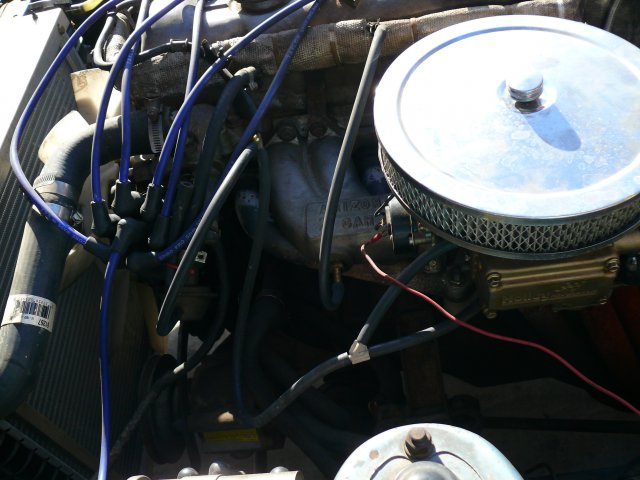

gb20 Posted March 28, 2010 Share Posted March 28, 2010 So I gave up on getting the car running myself and sent it off to a shop here in Vegas. They got it running but now it is going by the name Gutless Wonder. It sounds kinda strange (at least compared to stock) and doesnt have anywhere near the power it should. I have the AZC 4 barrell intake and the 6-into-2 headers with twice pipes exaust. I am including some pics and some video to give all you helpfull folks a better idea of what may be wrong. If you know what I need to do to get the power back, i.e. change around vacuum lines or whatever, please let me know. My baby vacuum lines into carb & intake Quote Link to comment Share on other sites More sharing options...
jasper Posted March 28, 2010 Share Posted March 28, 2010 (edited) First off, your vacuum hoses look all wrong. You have intake manifold vacuum going to evap/return/canister/purge?, with no solenoid. Cap the vacuum tap on the left of the manifold and plug the hose. The vacuum to the advance unit seems to be plumbed to both intake and ported vacuum. I've never seen that.(notice the y fitting). Choose one or the other. Make sure base timing is correct.(no hose connected to advance.( make sure mechanical advance is free and not siezed) I may be incorrect on this (opinions vary), but I'm a fan of ported vacuum to the advance.(Side of carb I believe.) Seeing this mess,I wouldn't be surprised the ignition timing,and or the float levels are off. Me thinks you had an amateur working on your car, and not a knowledgeable professional. As a note: when the ignition timing is retarded,It sounds odd/wrong....also no power Edited March 28, 2010 by jasper Quote Link to comment Share on other sites More sharing options...

gb20 Posted March 28, 2010 Author Share Posted March 28, 2010 Thanks Jasper. I'm rather new to doing all this (painfully obvious, I'm sure) so could you possibly show with the pic where I should move the vacuum lines to and which ones to block off? And also where and how to adjust the timing? As for the amatuer working on my car... I wouldn't be surprised. But it could also be a way for me to pay them more since they said they could do the tuning to get it running like it should. Thank you very much for the help. at-jefft, that is a vacuum line. The second fuel line has been blocked off. Still working on getting that video to load. Quote Link to comment Share on other sites More sharing options...

gb20 Posted March 29, 2010 Author Share Posted March 29, 2010 Ok, I changed the vacuum lines around yesterday and it helped some. So the question now is how do I adjust the timing? And do I do it with the car cold or after its warmed up? Quote Link to comment Share on other sites More sharing options...
MAG58 Posted March 30, 2010 Share Posted March 30, 2010 Should be in your FSM. But, warm it up (makes it idle better), pull the vacuum lines to the advance, loosen the screw on the dizzy base, and rotate to get correct timing. Toss on a dwell meter and set to somewhere 'bouts 8 degrees advance. Quote Link to comment Share on other sites More sharing options...
