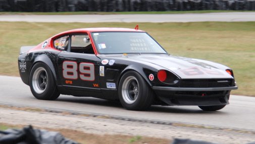

Daeron Posted April 6, 2010 Share Posted April 6, 2010 Sorry for the troll post, but that is a *sweet* looking race car!!!!!!! Stem to Stern, Tires to paint, she is NICE. Quote Link to comment Share on other sites More sharing options...
