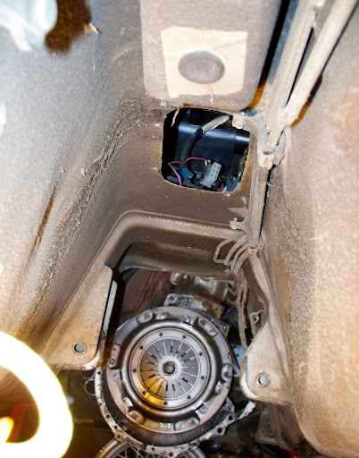

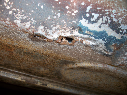

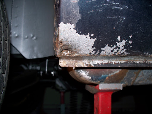

UofA_ZCar Posted December 6, 2010 Author Share Posted December 6, 2010 I swapped out the other three springs with the Tokico 280Z springs. On all 4 corners the car stands 1/2 inch higher with the 280Z springs compared to the Tokico 240Z springs. I removed the transmission, driveshaft, and exhaust in preparation for cleaning the undercoating off the trans tunnel, frame rails, and floor boards. I started needle gunning again (good times... note the sarcasm) and found a few rust spots. It is more than I'd like to have to deal with but nothing to complain about give the level of rust I have seen in some of the other build threads. Once I finish the trans tunnel I plan to put new hard fuel/brake lines in and then start putting the back half of the car together (there is no gas tank or third member right now). I've read old threads on fuel delivery for hours and figure give my planned turbo set up I'll have to weld a sump into my fuel tank. I haven't welded in years so I plan to get a buddy of mine to give me a lesson or two and then I'm going to see if I can fab the gas tank up myself. Any tips on fabricating the gas tank sump or running new hard lines would be greatly appreciate as I haven't done either before....... but that's half the fun right. Quote Link to comment Share on other sites More sharing options...

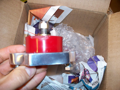

UofA_ZCar Posted December 9, 2010 Author Share Posted December 9, 2010 I got a bead blasting cabinet from HF and glass bead much of my pieces prior to powdercoating. I also use a tumbler to polish pieces like bolts prior to sending a batch off to be plated. Nice move, That's what I should have done. I hate waiting for the parts to get back from sand blasting. While I continue to needle gun I did receive a few things in the mail! Both are in preparation for the engine phase of my build. Pallnet fuel rail from a guy on Zcar.com Polyurethane motor mounts from McKinney Motorsports (I must say this is an absolutely gorgeous product) Quote Link to comment Share on other sites More sharing options...

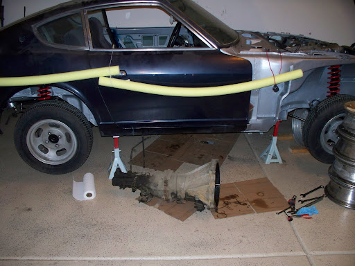

UofA_ZCar Posted May 8, 2011 Author Share Posted May 8, 2011 Finally finished stripping the transmission tunnel, now I am just waiting on the Bad Dog frame rails I ordered on April 16th. While I'm waiting I played around with some graphic ideas....... I'm thinking 370Z pearl white on the whole car and the taped sections in a copper-ish color. I blame my playing around with the tape on watching too many old episodes of "Over Haulin" on Netflicks. Quote Link to comment Share on other sites More sharing options...
