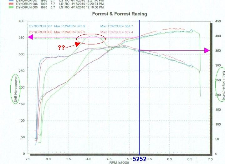

janaka Posted April 20, 2010 Share Posted April 20, 2010 I went to a dyno day on saturday with a bunch of local guys (mainly imports, but cool kids). This is the 3rd time this shop has dyno'd my car, first was I6 then right after my swap and now this past weekend. My setup: 2000 LS1- stock short block/heads T56 transmission. all pulls in 4th gear 224/224 .567/.567" on 114LSA camshaft upgraded springs/pushrods FAST 90mm intake and FAST 90mm TB sanderson 1 7/8" hugger headers 2.5" off collectors to 3" single exhuast (no cat or res but a small magnaflow bullet style muffler) I'm pretty sure thats all the mods to the engine. Other details for those who care. Stock open R200 diff with 3.90 gears, aluminum driveshaft, Z31 cv axles, 245/45/16 rear tires, 1/2 tank 92octane (mix of 94 and 91 from last two fill ups) Other pertinant info which may help explain some randomness. I had a HUGE exhuast leak, also known as one header collector bolt went missing, arg. So I installed a new bolt on Friday afternoon and leak is fixed. My O2 sensor is right after the collector so it was driving a tad funny due to the O2 not reading properly. Dumb me didn't drive the car until the 15min drive to the dyno day so I don't think the PCM got to re-learn at all. Stupid me. The biggest concern is the weird peak/drop at 4200-4500rpm, then the trq continues to drop off but the HP curve picks back up. Here's the dyno vid of the first run: http://s282.photobucket.com/albums/kk268/elcamino-dude/dyno%20day/?action=view¤t=040.flv Peak HP 378 Peak trq 400 Thoughts? Comments? Concerns? Quote Link to comment Share on other sites More sharing options...
Xnke Posted April 20, 2010 Share Posted April 20, 2010 that graph is not right...The Torque and horsepower curves have to cross at 5250RPM, due to the way horsepower is calculated. I think your dyno operator screwed up, or the machine is not setup correctly, or some other major error. Barring that, you're right, it's a weird curve, for sure. Quote Link to comment Share on other sites More sharing options...
Administrators BRAAP Posted April 20, 2010 Administrators Share Posted April 20, 2010 (edited) Good eye on the HP/Trq cross over, though the HP and trq are represented on different scales, the numbers as lined up with their respective scales do jive. I've seen before where the Torque and HP scales are not represented on the same scale which is sort of frustrating to those of us that use these graphs as tool, not just a pretty chart with colored arced curves to show off to extended family that wouldn't know what they are looking at any way. Somewhat annoys me when dyno operators present their graphs that way. It's nice to have both the HP and Trq figures represented/scaled the same, makes it easier to visualize what is taking place overall. especially when when wanting to compare to other graphs, previous runs, etc. Scaling the HP and trq graphs differently can alter the visual perception of how the power curve looks, but for what reason, I do not know. Though that huge hump in the power curve that peaks at 4200ish is bizarre. No amount of false air to an O2 from an exhaust leak, or another error in the PCM could cause the engine to actually produce that large of a hump like that. Only explanation I can gather from that, especially seeing the lower trq figure immediately preceding that hump is tire spin initially and as the tire/s was/were regaining traction, the momentum of the drivetrain being slowed down by the rollers would show up on the dyno as a torque increase like that. Riding the clutch pedal could produce similar results. Or glitchy sensor on the dyno roller... Edited April 20, 2010 by BRAAP Typo's Quote Link to comment Share on other sites More sharing options...
sq_creations Posted April 22, 2010 Share Posted April 22, 2010 Yup on dyno jets you have to turn on "Force Scaling" so that they line up at 5252. It looks like your real peak tq is 367 to me. The 400 run looks like the dyno freaked out for some reason. Quote Link to comment Share on other sites More sharing options...

Sideways Posted April 23, 2010 Share Posted April 23, 2010 (edited) On 4/20/2010 at 5:38 PM, Xnke said: that graph is not right...The Torque and horsepower curves have to cross at 5250RPM, due to the way horsepower is calculated. I think your dyno operator screwed up, or the machine is not setup correctly, or some other major error. Barring that, you're right, it's a weird curve, for sure. Indeed it is. That said, the left is scaled to 400, the right is scaled to 450. Edit: Doh went through, braaap beat me to it haha Edited April 23, 2010 by Sideways Quote Link to comment Share on other sites More sharing options...
