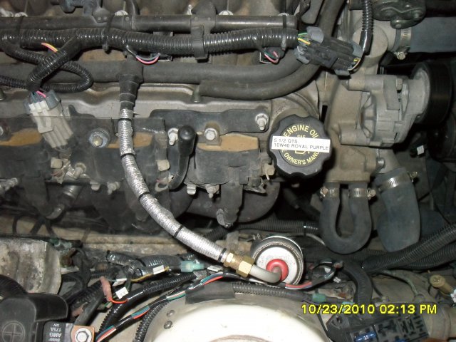

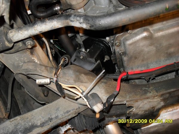

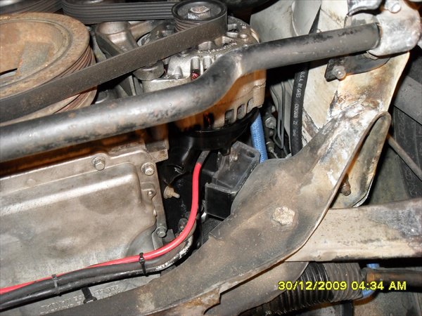

80LS1T Posted November 9, 2010 Share Posted November 9, 2010 If you can get a pic of your motor mounts and how close you are to the firewall that would be great. I'm trying to get an idea of how much room I will have for the turbo piping up in front of the engine. Oh and maybe a pic of the space in front of the engine! Thanks! Quote Link to comment Share on other sites More sharing options...
Domzs Posted November 9, 2010 Author Share Posted November 9, 2010 If you can get a pic of your motor mounts and how close you are to the firewall that would be great. I'm trying to get an idea of how much room I will have for the turbo piping up in front of the engine. Oh and maybe a pic of the space in front of the engine! Thanks! here are the photos . if you are planning on using stock mounts , make the right side a little higher . it won't take long before it compressed by the torque of the motor . btw , you have a nice car , love that color and wheels . do you have the code for the color ? doing my car two tone , when i m done reenforcing the body . Quote Link to comment Share on other sites More sharing options...

Domzs Posted December 9, 2010 Author Share Posted December 9, 2010 i used stock nissan mounts and made my own brackets . if you go with stock mounts , make the pass. side a little higher , it will sag a little with that much torque from the v8 . rec. use chevy mounts , which i will soon . what engine mounts did you use? Quote Link to comment Share on other sites More sharing options...
