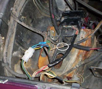

What i did near the ECU was
Turbo harness for (ECU)
Yellow to ignition
yellow with white to blue wire (from stock n/a setup off to the side single plug)
Ecu power light lights but the ??Starter?? make a whining noise.
The arrows and question mark indicates the connection i am unsure of, they both say coil so i tied them together.....
Any help would be great (i am new to wiring) and i didn't start this project and i almost wish i had my good old n/a back so please any help is appreciated!

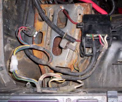

The dash wiring is basically left by itself. Your starter should crank independantly of the ECU being in the car or not. If it is powered while cranking then your fuel injection works. :)
The wires that power the coil are your key spot to splice a couple wires into the harness for the fuel injection near the turbo ECU.
Over by the battery your main power wires comming from inside the fender are the same on the non-turbo and turbo. Cut those main wires and splice them into your turbo harness. This gives everything power as it should with ignition.
The one clip on the left with the crimp connectors is the only part that was different. I matched the colored wires to the NA setup and that leaves one white wire going from the FI harness to nowhere. it did not seem to affect the engine.

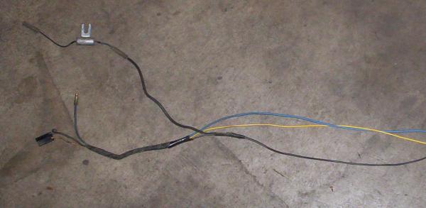

The NA power and ground wires at the coil you hook up to power and ground on your turbo coil. Pull the turbo transistor out of the turbo car's coil wiring harness and it looks like this.

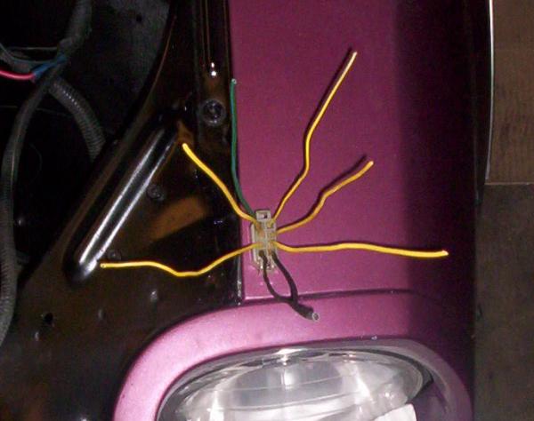

Then run that wire through the fender alongside the factory NA power and ground. It splices into the lower left yellow wire in this pic (coincides with the picture on your schematic)
