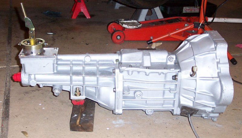

FWIW, I just bumped a related thread where I showed what I did with the Nissan T5 tailshaft housing in order to use the gForce gearset, maybe it will help a bit. The links to the pics were broken so I updated them when I bumped the thread...
http://forums.hybridz.org/index.php/topic/45954-t-5/
Also, here's a pic of the my finished gForce T5 trans with a Nissan bellhousing and tailshaft housing. This should also give you an idea as to how far back the Nissan tailshaft housing puts the shifter...
