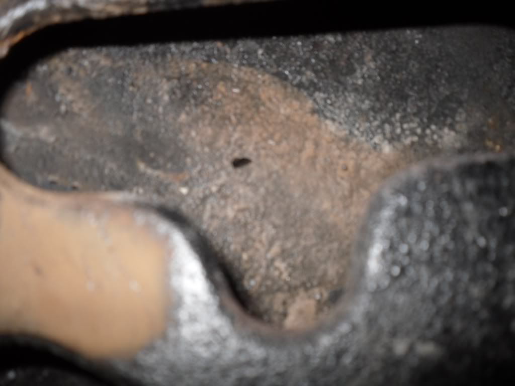

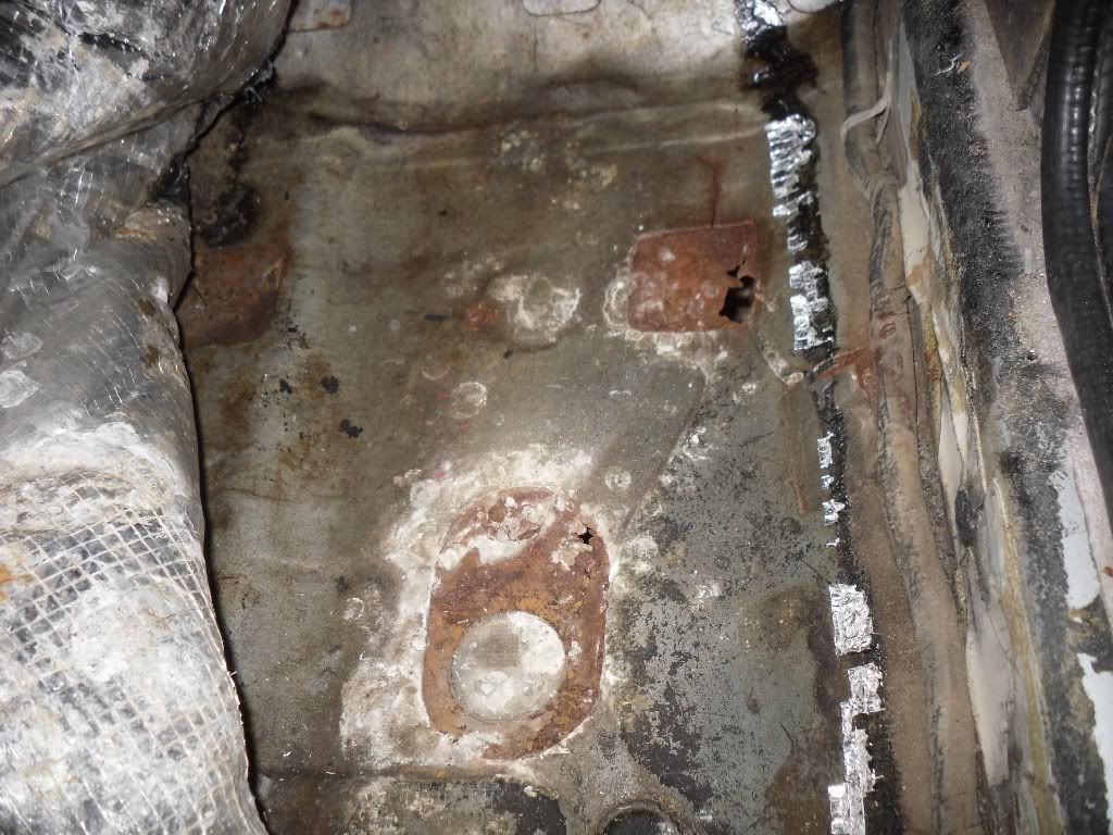

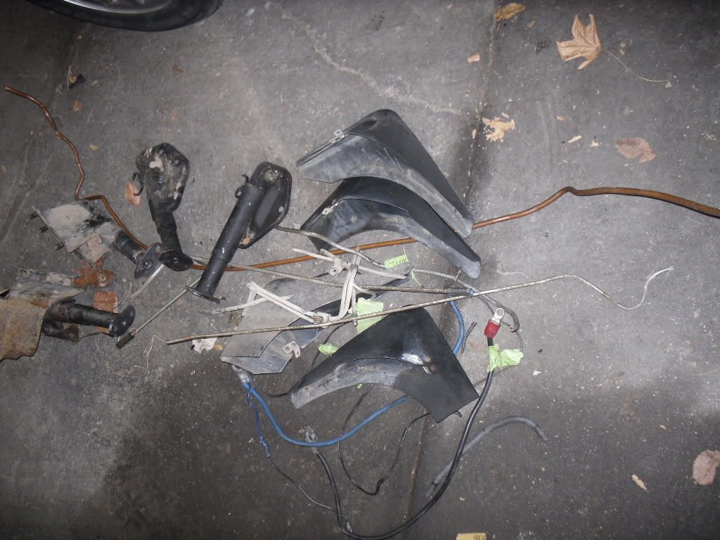

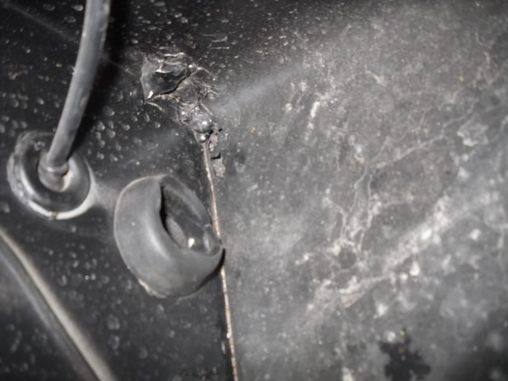

SUNNY Z Posted October 28, 2010 Author Share Posted October 28, 2010 well i have a little progress to report. I tore into the wiring, labeling everything, and taking it out of the engine bay. I'll be using a stand alone wiring harness, so 90% of this will be replaced / deleted. Here's the engine bay, pre-cleaning, without all the wiring. Here's where all the wiring now resides. haha, Just for the time being. I did find a couple more small rust spots, in the culprit areas. Below battery box and on the drivers side, same spot here's the rust on the passenger's floor pan. Not terrible, but I'm gonna replace it. and the other Z. It's been driving me crazy lately, battling a nasty driveline vibration. That's all I got done last night! Quote Link to comment Share on other sites More sharing options...

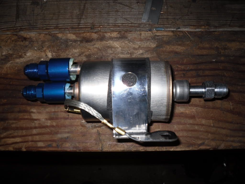

SUNNY Z Posted November 2, 2010 Author Share Posted November 2, 2010 Just got off the phone with Nasty Performance. Great guys to deal with. We discussed my fuel system requirements and capabilities. Here's what my fuel system is going to entail: -Stock 280z tank (has internal baffles) -Corvette FPR / Filter, located near the tank. -Walbro 255 inline pump -I'm going to get some sort of pre filter (brand undecided) - -6 AN line throughout ( likely a combination of hard stainless, and braided stainless / teflon lined) This should be PLENTY for anything I intend to do with the car for a long time, and is quite affordable. -walbro pump ~$100 -corvetter fpr w/ fittings ~80 -Stainless hard line - 2.95 /ft -stainless braided - ~$5/ ft -pre filter ~$25 -misc fittings - ~ +- $100 Hopefully have it done for < $350, and it should support well north of 600HP. UPDATE I took the stand alone harness out of the box that I received it in, only to find that it was wrapped head to toe in black electrical tape. This is a serious NO-NO. It was built at least a couple years ago, and the tape decided to deteriorate, and get gummy. So I stripped it all off ( HUGE PITA ) Here's the aftermath Now I'm left with a gummy harness, so I've been using adhesive remover to get all that **** off. It was a good thing I did this, as I found some shoddy connections held together by the ol "twist, tape, and hope" method:bang: I went to work on the engine bay, sanding it with 220, and taking all the unnecessary crap off the fender wells and firewall. I intend to weld up all the holes, and make it a nice smooth final product Then I went through the car harness, and trimmed out everything I won't be using. Leaving basically the horn, and headlights / side markers. All these will be run together, through the frame rail to the front, so they'll be completely hidden, and out of harm's way. Quote Link to comment Share on other sites More sharing options...

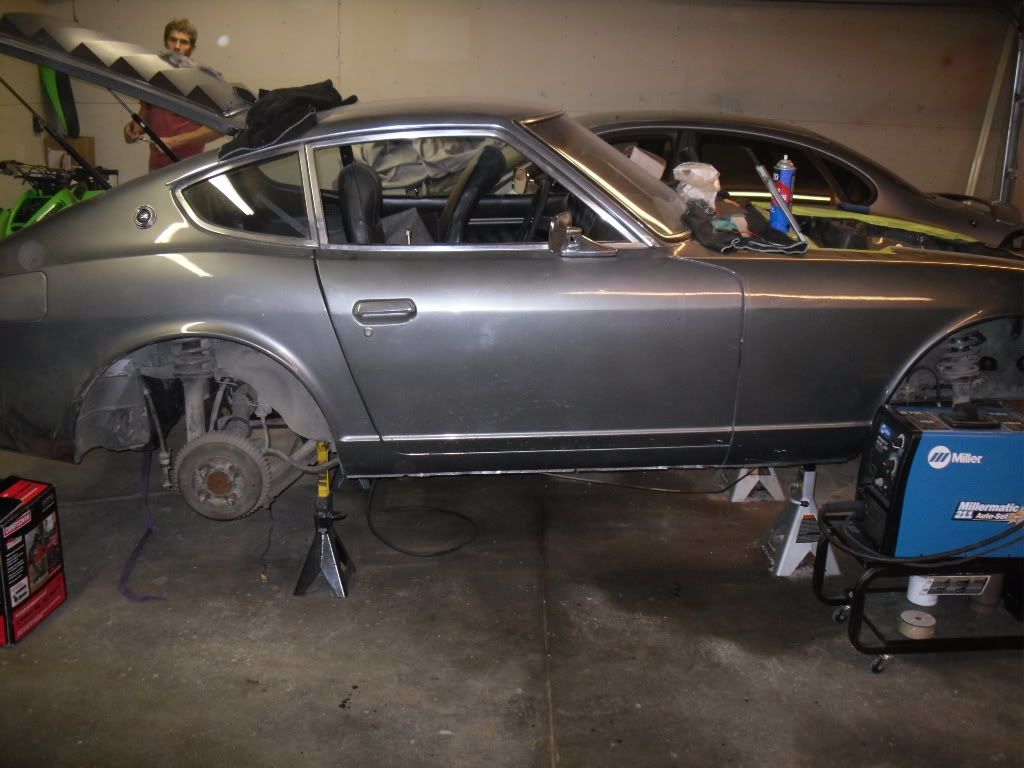

SUNNY Z Posted November 6, 2010 Author Share Posted November 6, 2010 great progress josey, keep us posted. you going to remove to brake m/c and booster and brake lines to really make the engine bay complete for the respray? Yep, it's like a fire sale. Everything must go. I'm gonna take everything out, or at least loosen it, and tape it up, so that I can get a good finish on the paint in the engine bay. I just acquired my buddy's welder today, so I hope to get a start on it tomorrow. (school / KSU football getting in the way) haha. I'll make sure to keep ya'll updated. GO CATS Quote Link to comment Share on other sites More sharing options...

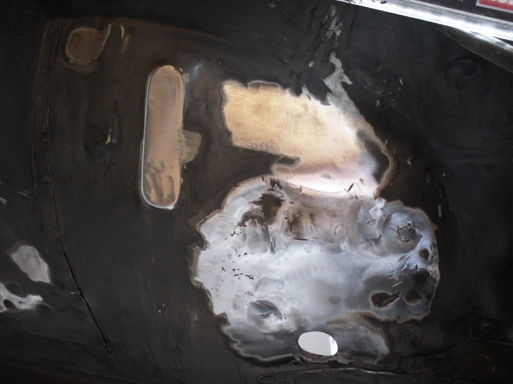

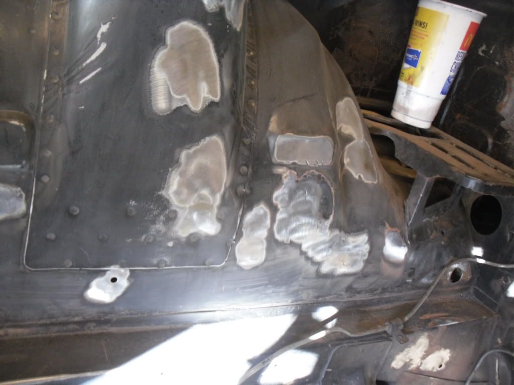

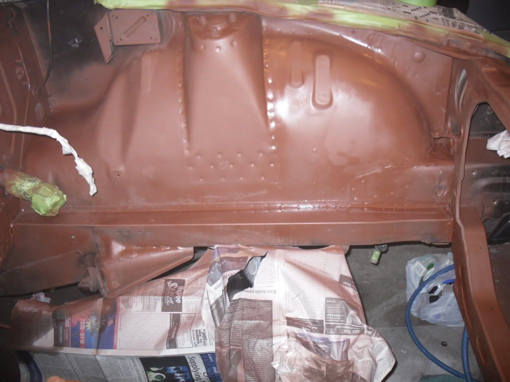

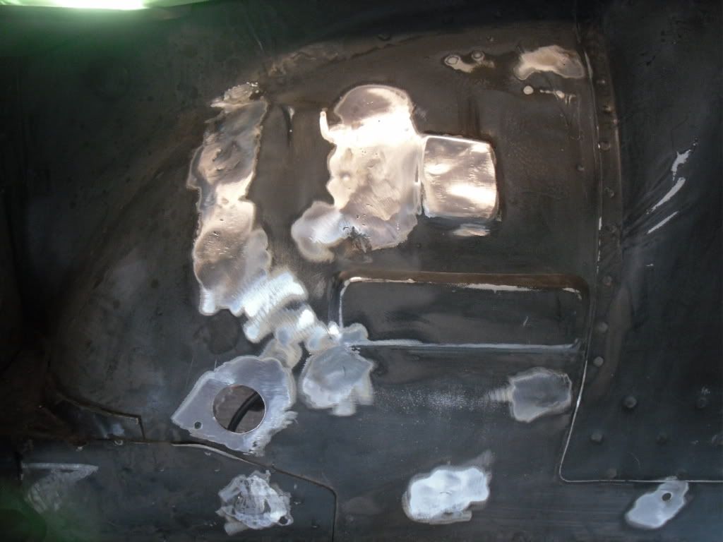

SUNNY Z Posted November 8, 2010 Author Share Posted November 8, 2010 Not much to update, but here goes. This weekend, I hardly got anything done, due to the Kansas State Wildcats whoopin that longhorn ass, and of course, I had to celebrate in rockstar fashion However, I did get some done on the z. Welded up a couple holes, (HUGE PITA btw). This sheet metal is the bane of my existence. It's incredibly thin. After some slow tacking, i was able to get a couple holes filled, and ground down. Then I masked off the engine bay, and have been getting it ready for paint. I've decided I'm going to use all SS braided , teflon lined, line. This will eliminate the headache of the hard line bending / flaring issues. I'm going to be placing the corvette FPR near the back of the car, to eliminate the need for unnecessary plumbing and clutter in the engine bay. I plan on ordering the mounts probably tomorrow, or shortly thereafter. Thats and thats all. For today Quote Link to comment Share on other sites More sharing options...

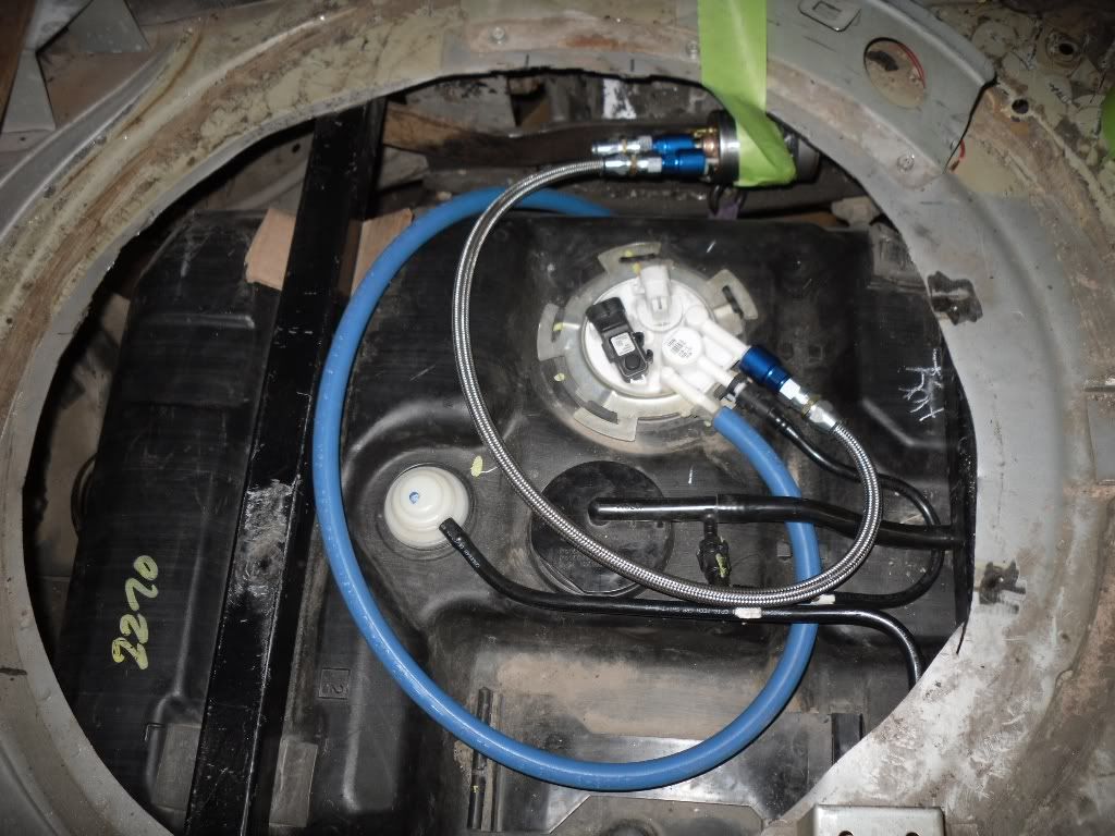

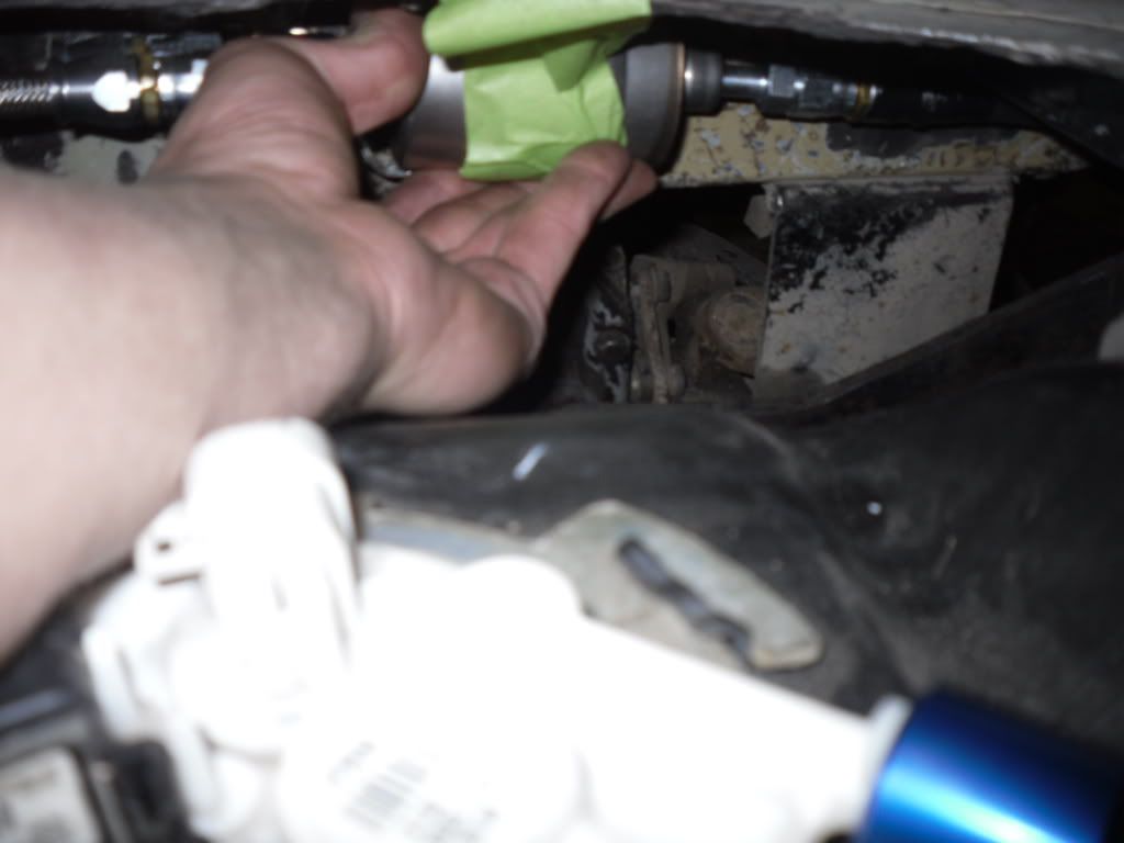

SUNNY Z Posted November 20, 2010 Author Share Posted November 20, 2010 Well, the UPS man delivered this little bundle of joy yesterday.... (fuel system stuff) and within moments of opening the box, of course i had to play with my new toys Here is how the engine bay currently looks. Ready to do some final filling / smoothing and then paint! Here's the current pile of crap i've removed. Well at least 75% of it. I started taping my harness up, and beautifying it. Of course using vinyl, non adhesive tape. Also picked this up last weekend, from a friend's parts car. Its out of a V6, so the pump will have to be changed. Not sure on what i'm gonna put in it yet. I then started the hacking of my spare tire well, to fit the F-body gas tank. Here it is, Pre-Op Annnnnd more harness work Post-op. I cut the braces with a cutoff wheel, and the rest with a sawzall. Note the half a cutoff wheel blade in the opening in the picture. That is why you ALWAYS wear safety glasses when using this kind of thing. It split while I was using it and hit me in the eye. I did have my safety glasses on, (thankfully) and it just put a deep gouge in the lens. WEAR your PPE! A view from the bottom showing the supports that must be cut. And the tub. I got a little off my trajectory in one spot, but I'll have a cover over it, so it'll still be pretty. I hope to mount the tank, and get the fuel system plumbed this weekend! I plan on making a specific thread (hybridz) on how to do this swap, when I get it all done. Quote Link to comment Share on other sites More sharing options...

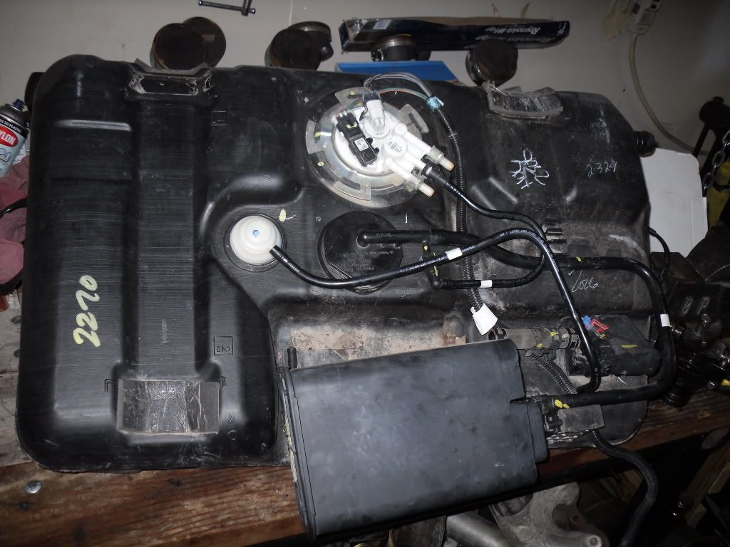

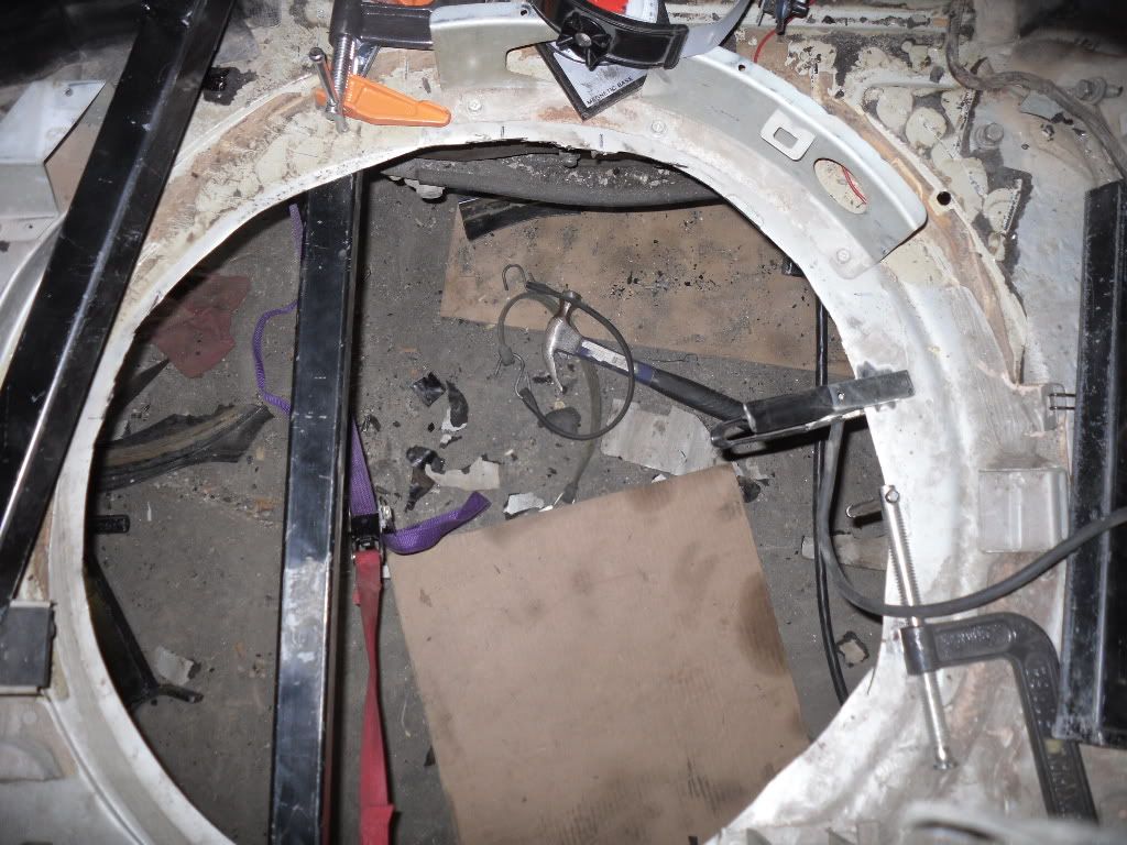

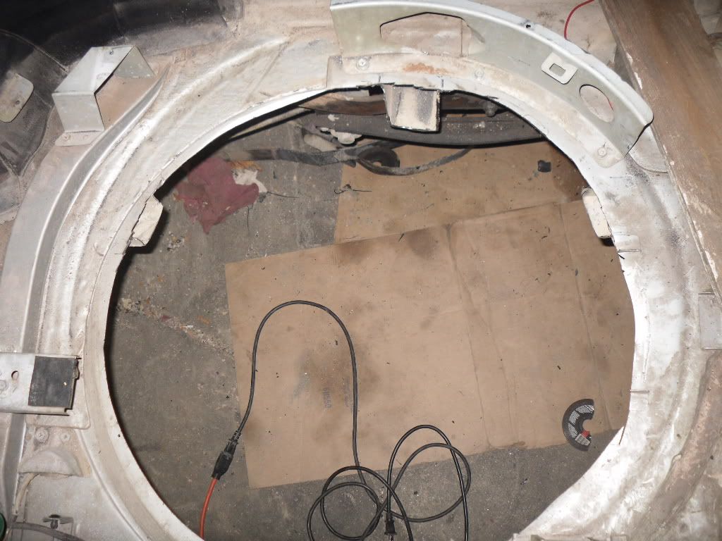

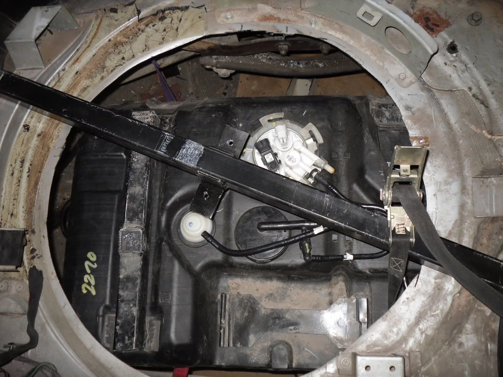

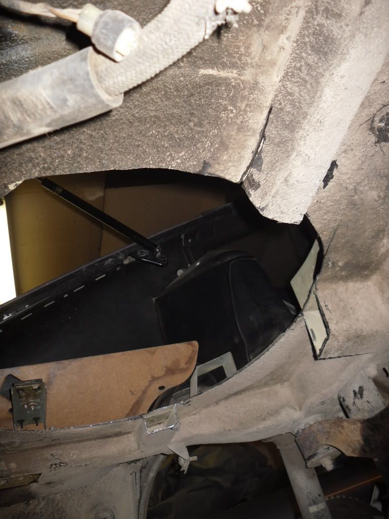

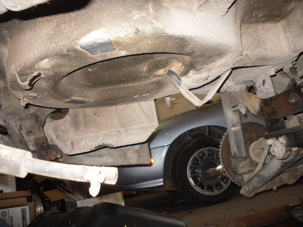

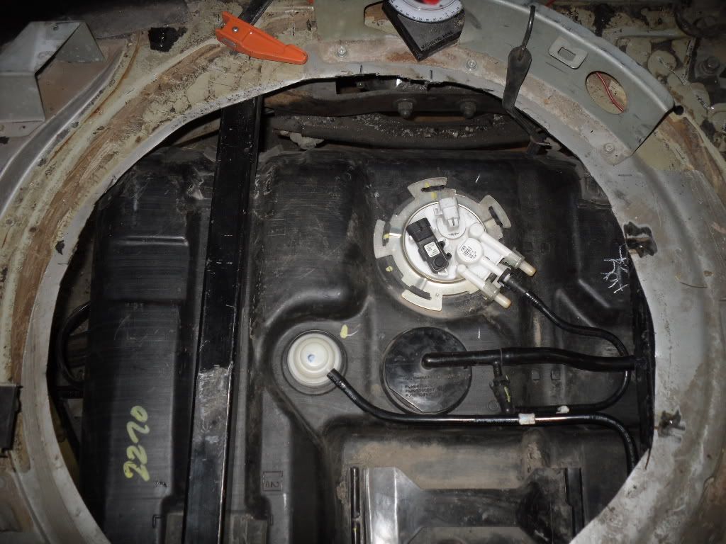

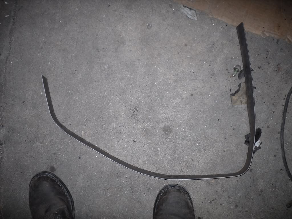

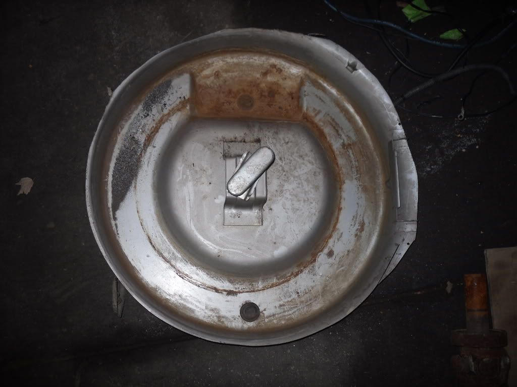

SUNNY Z Posted November 22, 2010 Author Share Posted November 22, 2010 Well I made a little more progress this weekend. I worked on getting the f body tank mounted. It was a real PITA to do this by myself. Here's some of the ghetto fabb'n that took place. Just a hood-rich way of holding it up so i could measure it. I went ahead and used some 1.5" square tubing, rather than the 2" that a lot of people have. I did this only because it's what I had laying around, and is PLENTY thick enough to get the job done. Here is the first support And then the tank, with both supports welded to the frame rails, front and back. I then started mocking up the FPR/ filter. It's gonna be all in stainless, the blue line is just for a template. The FPR will be mounted to the rail, as shown I then started bending up tank straps, out of some 1.5" strap that i had. Here is a picture of the car, as it sits. With my buddy doin a cam swap on his 07 KFX 450 in the background. Then a friend brought over a pony keg of a microbrew, and needless to say, that was where productivity ceased for the evening. haha.:chug::chug: Quote Link to comment Share on other sites More sharing options...

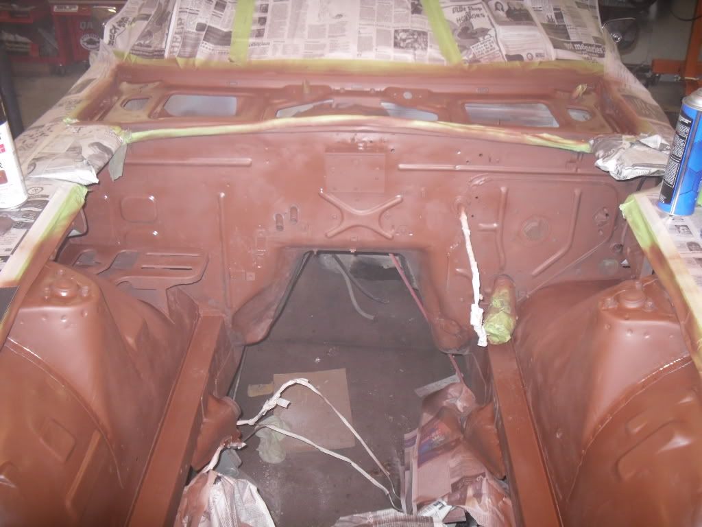

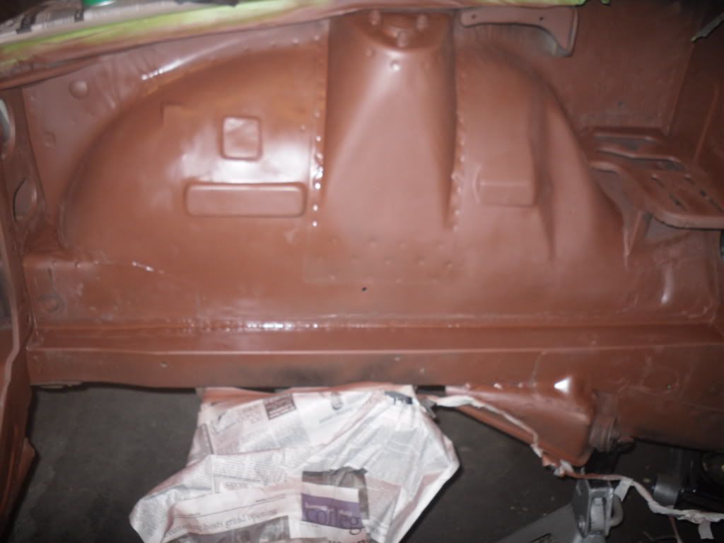

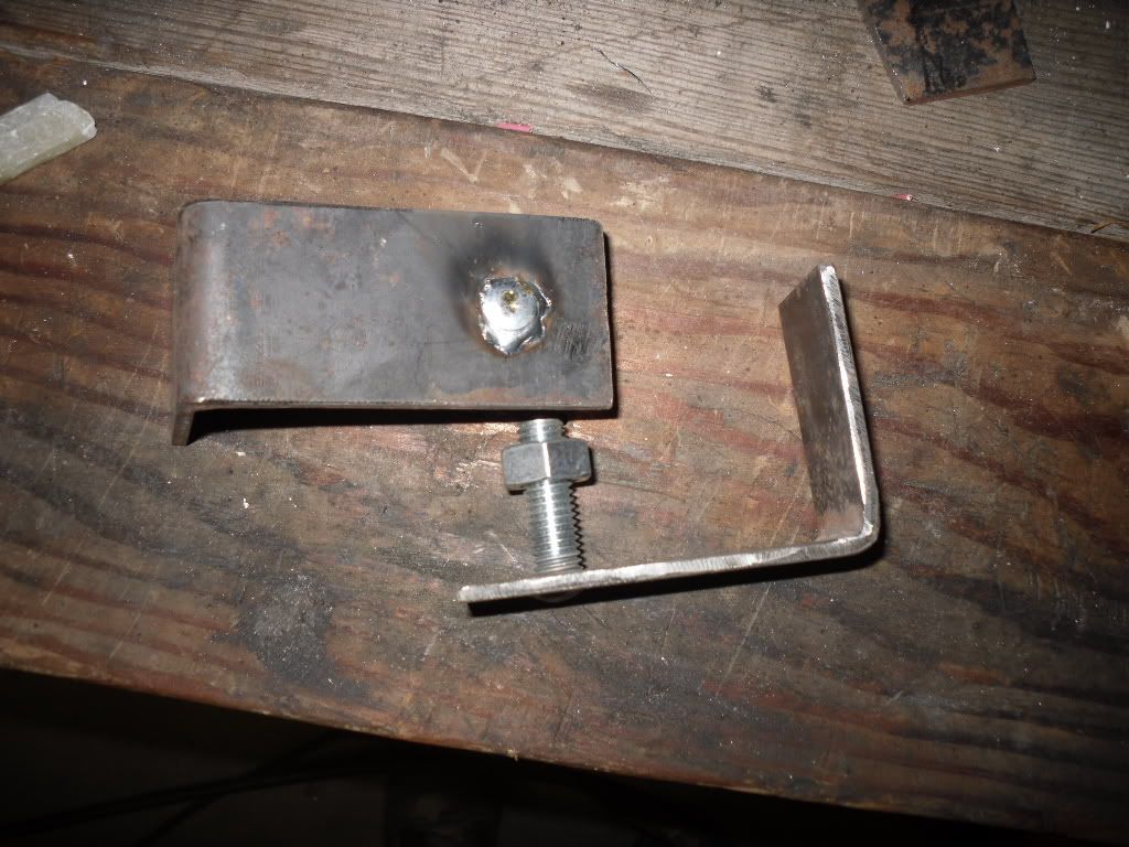

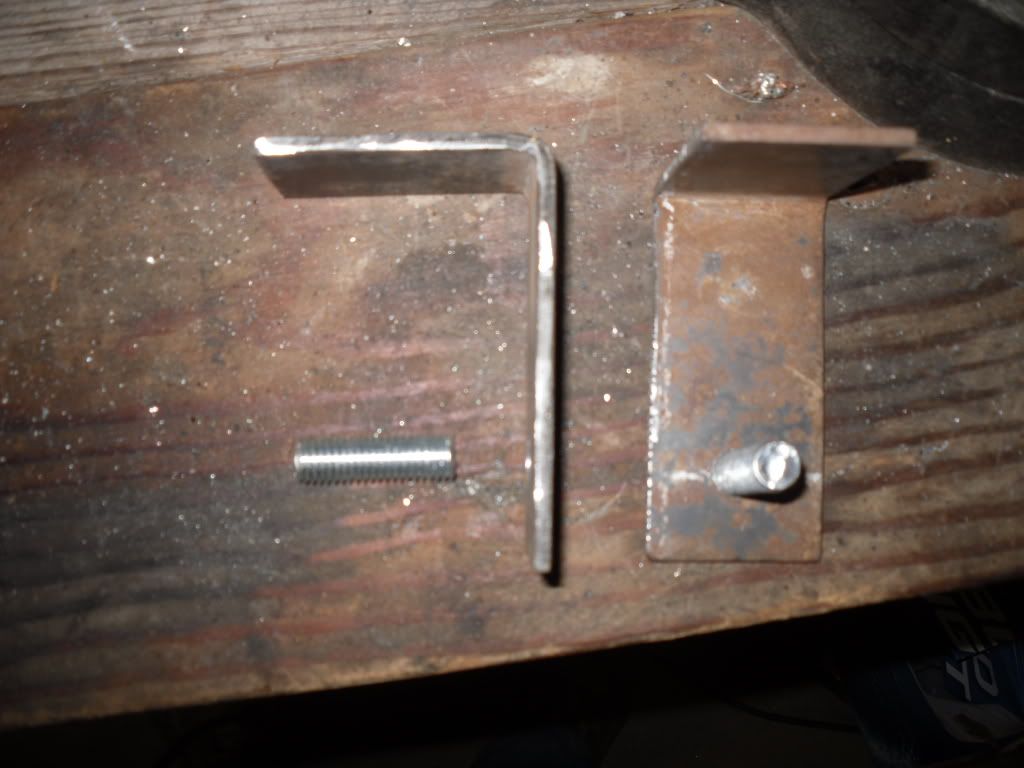

SUNNY Z Posted December 10, 2010 Author Share Posted December 10, 2010 Quick shot of the brackets I build for the rear of the fuel tank mount straps. 2.5" angle iron, 1.5" wide. drilled a 3/8" hole, tapped it to M10x15, threaded the rod into it, welded the back side. I then welded these to the 1.5" square stock above the tank. Came out really nice. More pics to follow later And then I FINALLY finished the body work in the engine bay. Ended up smoothing most of the welded areas over with bondo, to get just the finish i wanted. Here it is after 1 coat of primer. Quote Link to comment Share on other sites More sharing options...
