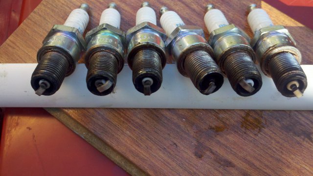

AtlantaZ Posted October 27, 2010 Share Posted October 27, 2010 (edited) My project: turn a 1976 280z into a 280z turbo, powered by Megasquirt, 440cc injectors, and an intercooled T3/T04E turbo. Target horsepower is 300hp to the rear wheels. Nothing too wild, but enough to make me go zoom when I want/need to. I'll also complete a T5 tranny swap to match. About six months ago, my wife let me buy my first ever project car: a well cared for 1976 Datsun 280Z. This was a California car that migrated to Charlotte, North Carolina in 1999, and its previous owner sold it to me in April of this year. The interior was pristine, the engine was rock solid, but I felt like it didn't ... move ... like it looked like it should. Here it is, the car that my kids affectionately call "dad's cool red car": The stock engine is in good shape and will make a great addition to some future owner's NA engine collection: Step 1: Acquire a 1983 L28ET engine I found my base longblock in a local Craigslist ad. Got a nearly complete engine (minus distributor) plus a new engine stand for $300. Step 2: Send block + head in for machine work I had the block shot-peened (sandblasted with BB's) and honed, the head got a 3-angle valve job, and all surfaces were milled. New valve stem seals were installed. Bad news was, I found out that the shop wanted an extra $500 to reassemble the engine. So I picked it up as-is, which meant that the valve train was still partially disassembled: Better yet, none of the rocker arms/lash pads were marked or organized, and he failed to give me back the "mousetrap" springs and their clips (hold the rocker arms to the pivots when the rockers are not under load from the cam). Ordered a new set from Capitol City Nissan for $38. Step 3: Reassemble shortblock Block is clean and on the stand. Installed new Hastings ductile iron rings (high quality replacement rings for turbo application) and new Sealed Power main/rod bearings. ARP rod bolts hold the piston rods in place, but I reused the stock crank cap bolts. So far so good: UNTIL I decide to double-check the main bearings for cleanliness and found some grit on the cap-side main bearing, along the centerline groove: So now I have to pull the crank back off and doublecheck all the other bearings, just to make sure that dirt isn't sneaking in somewhere. Not sure how this happened, my garage is clean and I keep the block covered! I have a new Melling (M152) oil pump, a Beck-Arnley timing kit (from Japan!), and a water pump waiting to be bolted on, as well as ARP main studs. The plastic bag in the top of the photo is full of stainless steel bolts from MMS & Accessories: But obviously I can't move forward until the cylinder head is ready. Still waiting on those springs... In the meantime, I'm starting to strip down the valve cover and clean up some of the brackets and pulleys that I'll be reusing. Some of these parts will also get powdercoated (intake manifold, valve cover). I've discovered a great non-corrosive, non-toxic rust remover that doesn't damage "healthy" metal. It's called Evapo-Rust: I've already put some small parts and bolts through this stuff, and it works great! To demonstrate its effectiveness for the reader, I have taken a "before" picture of the main crank pulley: I'll take another "after" picture when it's done (24 hours later). Here's my high-tech parts soaker: I hope to finish this by May of 2011. As I work, I am slowly researching and acquiring the miscellaneous parts I'll eventually need: - Garrett T3/T04E 50-trim stage III, .63AR housing turbo (or Turbonetics, if I can find a 5-bolt downpipe that will fit; was hoping to use the MSA downpipe) - cxRacing same-side intercooler - O-ring billet "Pallnet" style fuel rail (bought it off eBay today!) - Recirculating blowoff valve (BOV) and external wastegate - recommendations appreciated here! Hoping to eventually use an electronic boost controller - MSD 2225, Walboro 255, or Bosch 044 fuel pump - want one good to 400hp - any recommendations on the best bang for buck here? - Gear reduction starter and upgraded alternator - 440cc injectors - Rising rate fuel pressure regulator (not sure if I really need one for my application?) - Clutch kit and short throw shifter for the T5 tranny - Aluminum driveshaft with Spicer u-joints, custom length for the swap of course... - Megasquirt kit from DIYAutotune - AFR, exhaust gas, and manifold (boost) pressure gauges/sensors If any reader has any of the above parts in new or gently used condition, please feel free to PM me. And please weigh in with your (informed) .02 on my build plans! Finally, I will also be having my downpipe, (stock) exhaust manifold, and turbine housing ceramic coated. Looking for that clean, subtle look in the engine bay, like KTM's beautiful 240z: http://album.hybridz.org/data/500/EngineMSA2.jpg Thanks for reading! Edited October 27, 2010 by AtlantaZ Quote Link to comment Share on other sites More sharing options...
