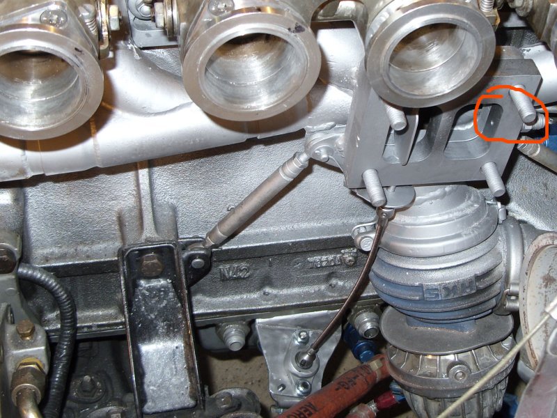

Ya I know - that whole thing was a pretty frustrating experience. I will say that since I went through and had expansion joints added in the long tubes, it's actually not given me any further problems. Here's pretty much what it looks like today...

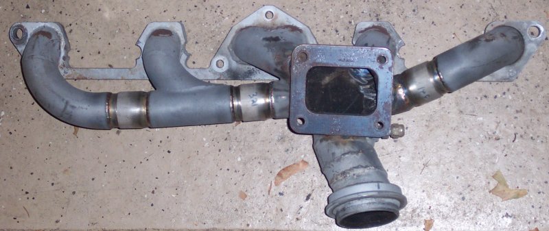

Yes, someone else went through the 're-engineer the thing so it works like it should have from the beginning' process too!
Now there is a Euro Manifold (incidentally, which has larger internal flow diameter than that one!) worked up for that as a replacement. If only we could get it cast in stainless steel economically.
