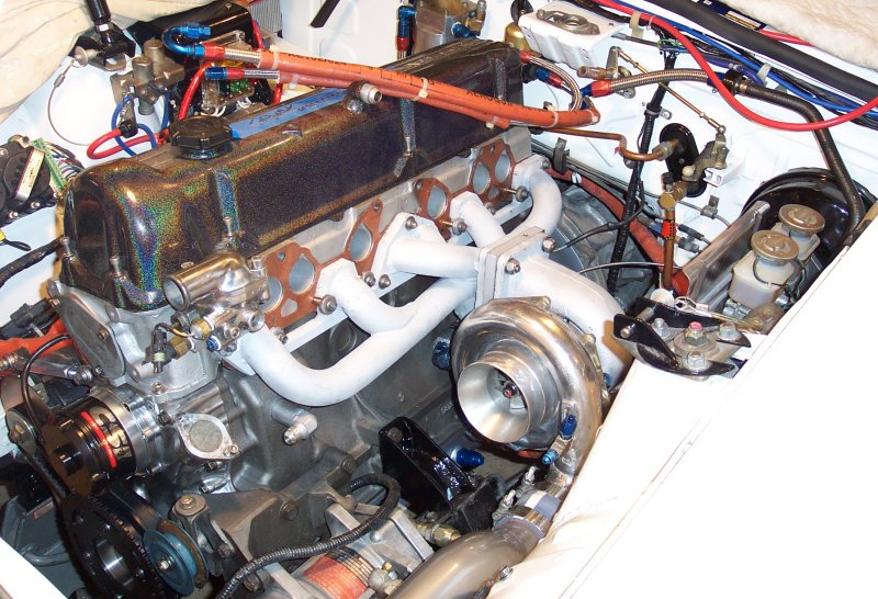

Here's what a GT42 looks like on an L-series...
well hell. it sounds like im going to go over my goal then with the build im trying for. guess I kind of underestimated how much I really am going to get out of this and should look back over my plans again, or just spend the money for it, ;)
But it also sounds like whatever the turbo really is, its still too big for what im doing for a while
