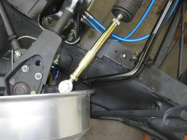

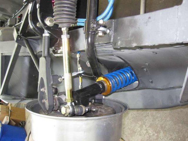

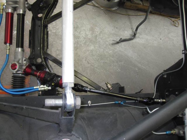

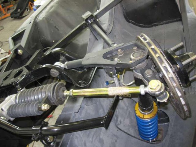

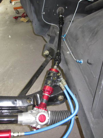

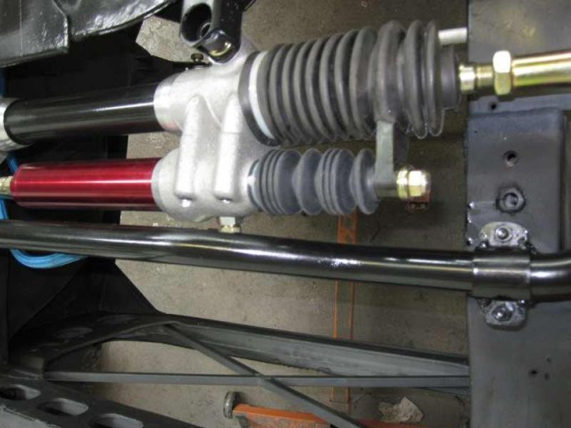

JMortensen Posted November 29, 2012 Author Share Posted November 29, 2012 (edited) Got the linkage and everything done, so yay for that. Turns out the steering shaft fit without having to notch the frame rail. Steering linkage is all done. Still need to mount the ps pump and get hoses made for it, and do a quick release for the wheel, but the hard stuff is done. Then went to bolt up the sway bar. Boo. Turns out the hydraulic cylinder hits the bar when I turn right. Will have to relocate the sway bar mount forward and lengthen the arms which will make the bar weaker. Shouldn't be too hard. I have the sway attached to a rod end, so I made a new tube to weld through the frame with a nut on the end to thread the rod end into. The end of the bar also hit my droop limiters, so will probably figure a way to limit droop with the sway bar as well. Got a bar from a 280Z that I bought earlier this year, so I'll have 2 bars to fit up and make work. On the plus side, looks like this setup gives a lot of room for exhaust. Edited November 29, 2012 by JMortensen Quote Link to comment Share on other sites More sharing options...

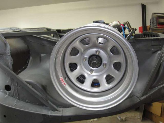

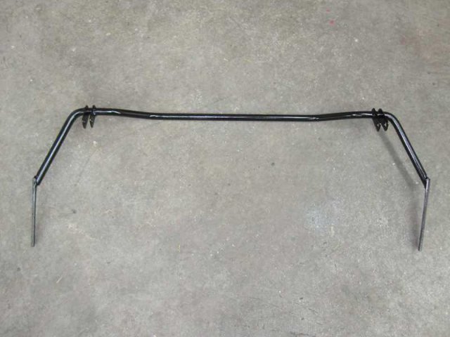

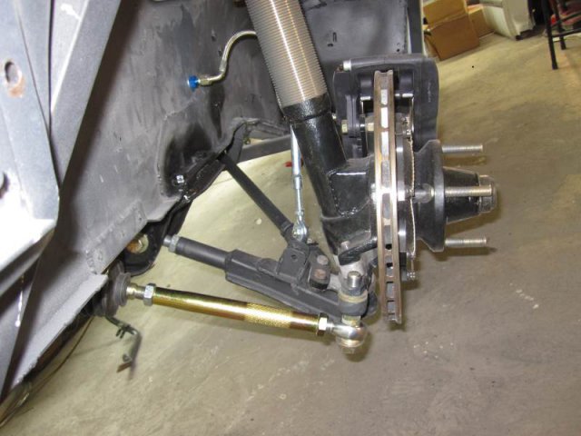

JMortensen Posted December 6, 2012 Author Share Posted December 6, 2012 Maybe you can come watch it autox next year. You might even get a ride if I get around to putting a passenger seat in it (planning on it but don't have a 2nd seat yet and have a lot more stuff to buy, so it's down the list a ways). So here's the update on the sway bar(s). I got the stock 280 bar modded and had to cut the ends off of my old 1" bar to make it fit in the new location also. Serious PITA. Got it all in and checked for clearances. This diamond wheel is really the wrong offset. It's 3.75" offset and should be more like 4". Still there is about 5/8" of space between the wheel and the tire. I think that will be OK because the tires will be pretty narrow for the wheel width, 13" tread on a 14" wheel, so I don't think the sidewall will pooch out too far. If it does I may have to add rack limiters or wheel spacers. Hoping that it clears with no more hassle. In getting the thing all together I realized that my brand new inner tie rod on the LH side is loose and has about 1/8" slop in it. That's not cool. Have to check with Woodward and see if they'll help me out or if I just need to buy another one. The suspension is sitting on the bumpstops in the pics. You can see how little ground clearance there is going to be. I might actually have to run a longer external bumpstop to keep the splitter off the ground. We'll see. Quote Link to comment Share on other sites More sharing options...
JMortensen Posted December 6, 2012 Author Share Posted December 6, 2012 Well, I learned something today! Inner tie rods are adjustable. Just back off the locknut, turn the main nut down until the slack is gone, and tighten up the locknut again. Good to go. Quote Link to comment Share on other sites More sharing options...
