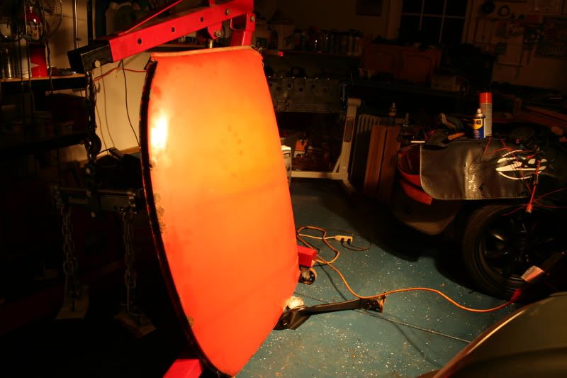

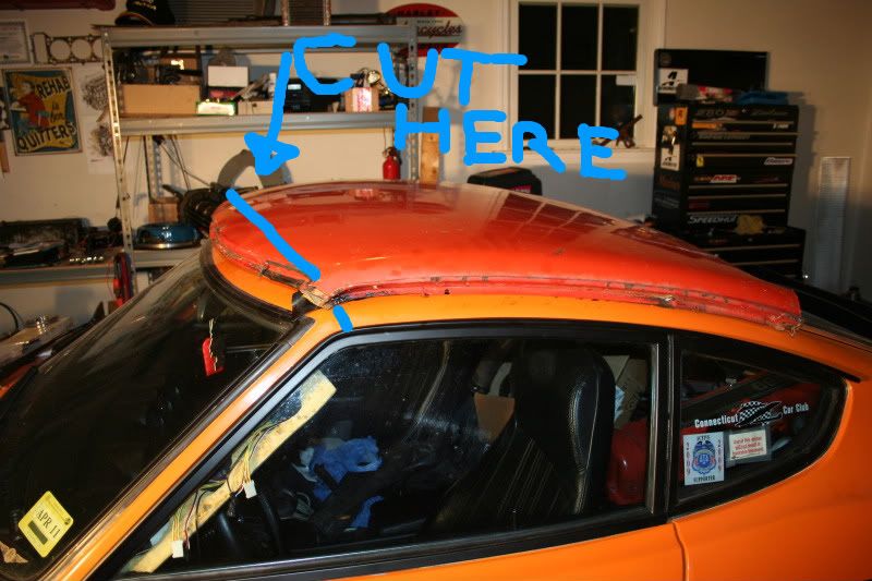

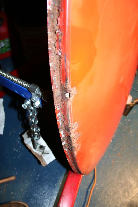

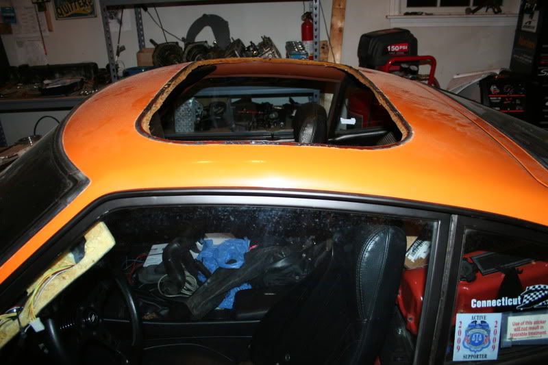

Oddmanout84 Posted January 26, 2011 Share Posted January 26, 2011 (edited) Ok, so my 280z came with one of those awful moonroof abortions when I bought it, and I've wanted to get rid of it ever since I first rode in the car. It leaks something terrible, can't find new gaskets for it, and it makes HORRIBLE whistling sounds on the highway at speed. Its time to go. Almost a year back, one of my buddies got a '73 donor car parked in his driveway and we swarmed it like a colony of fire ants. With essentially a "you remove it, you keep it" policy going, I claimed the roof and we sawed it off. It was a pretty good donor besides a small rust spot, but I didn't have a car to take it home at the time. It sat in the yard a couple months until I could borrow a scooby to haul it home. During that time not much changed, but I found the small rust spot on the front edge was a little worse than I thought. Now that I have my own handy dandy little MIG welder (Hobart 140), I can finally get around to this. I've welded my entire exhaust together so I'm not a complete newbie when it comes to MIG, but I will have to practice a bit on some scrap as its been about a year. I still feel pretty dumb for painting the car two years ago only now to ruin it, but the paint was cheap and I thought it would be harder to find a donor. This one sort of fell in my lap. Now I suppose I should have mentioned at the beginning, YES, I have searched and read other threads on how to do this swap. So far I've seen two methods: Option 1: Measuring and patching the big stupid hole itself. Option 2: Skin the recipient and donor roof a couple inches down the columns by drilling out the spot welds. Reweld donor roof in place of original. With my case, I've seen another couple possible options, and I'm wondering if they're feasible. Additional Option 1: I drill out the spot welds on the donor and cut out the rotted bits. After patching the new skin in I then weld in sheet patches for the rust spots and smooth them out. Additional Option 2: This is the one I'm a little more comfortable with. I cut the donor roof and my current roof at the line in the picture (which is still forward of the current sunroof hole) and patch the skin onto the spot welds in the rear, then weld the front. Like this. Hopefully this is clear enough. What I'm concerned about the most is what is going to be the easiest to align, will be blended back into the body with less effort, and would be better for avoiding warping. Though I feel the most comfortable cutting the roofs and welding them in as per the diagram, it would really suck if it didn't line up at all... Any thoughts? Edited January 26, 2011 by Oddmanout84 Quote Link to comment Share on other sites More sharing options...

subridersix Posted March 3, 2011 Share Posted March 3, 2011 I'd go to eastwood .com and buy a flanging tool, cut out the hole, flange the perimeter to stiffen the roof and weld in my patch. The flange will let you overlap all the way around without changing the roof line and keep your welds away from the edge so there is much less chance of burning thru. Quote Link to comment Share on other sites More sharing options...
Oddmanout84 Posted March 28, 2011 Author Share Posted March 28, 2011 I'd go to eastwood .com and buy a flanging tool, cut out the hole, flange the perimeter to stiffen the roof and weld in my patch. The flange will let you overlap all the way around without changing the roof line and keep your welds away from the edge so there is much less chance of burning thru. Thanks for the tip! A couple weeks ago I grabbed one and I'm in the process of cutting/flanging/welding today. I'll try to remember to post progress and snapshots of the process later. Quote Link to comment Share on other sites More sharing options...
darom Posted April 2, 2011 Share Posted April 2, 2011 What are your plans for drainage holes on each side at the top part of the hatch? My 76 came with the same sun roof monstrosity. I patched mine with a bigger piece of the donor's roof. Regards! Quote Link to comment Share on other sites More sharing options...
Snailed Posted April 8, 2011 Share Posted April 8, 2011 I would cut it about 8" in from all sides so it's easy hammer. Also, cut the corners with a nice radius, maybe 2-3", this will keep warping to a minnimum. Quote Link to comment Share on other sites More sharing options...
