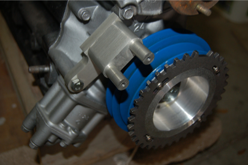

Got it back on without having to pull the radiator! Which was nice, since I didn't want to deal with coolant spilling everywhere. The bad news - the VR sensor mount didn't quite line up with the timing cover holes. After trying unsuccessfully for 20 minutes to get it on, I took a drill and grinder to it, and finally managed to get it bolted on. THAT part would have been nice to do with the radiator off. But it's done!
The best part is that I get to do this all over again on my new engine. Thankfully, that engine IS on a stand, so this will all be much, much easier the next time around!!
That's strange that it didn't fit... Maybe you weren't fitting it on right? I had that problem too... I was doing it backwards or at the wrong angle which made it dangerously close to the pully or something if I remember.Eventually I figured it out. Usually when I get pissed I take exponentially longer to solve the simplest things....
I mounted it in the same orientation as Derek's setup - with the large bolt at the bottom, and the smaller slotted hole towards the top. At least it's on now!
Sorry you had trouble with the fit. Did you have to grind the back corner of the bracket like I suggested? It may have just been the angle of the dangle when you were installing because I did a test fit on a motor I have here and it bolted up with no problems after I ground the corner. I wonder if there are different timing covers out there?
Derek
Could've been... since I was trying to thread in the allen bolt from above the engine, with the radiator still in place, the angle was definitely much less than optimal. When I tried mounting it to my L28ET on the stand, it seemed to fit just fine.
Yes, grinding the corner helped. Hate to ruin the finish, but I guess no one will see it. I may respray it with satin black just to be sure.
