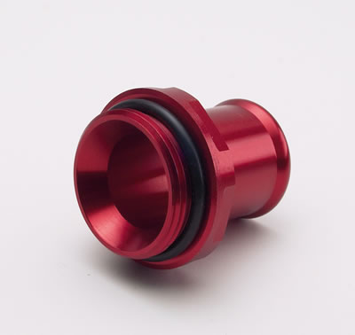

ZT-R Posted March 3, 2011 Author Share Posted March 3, 2011 i ordered my radiator way back and went with 20 an... i was thinking they would use female threads but i should have specified i wanted female. then i could get miezere adapters if i needed too... like this Quote Link to comment Share on other sites More sharing options...

ZT-R Posted March 4, 2011 Author Share Posted March 4, 2011 well i changed gears and started tinkering on the gt mod tank, got that all plumbed up and went to throw away a few trimings and low and behold there was a 90 degree rubber radiator hose that one of the other guys had to trim off. i nabbed it and although this paticualr one willnt work because the one leg needs to be about an inch longer but i can find another one, i think i can just put a regular radiator hose over these male bungs, the hell with it. i know i can put these earls fittings in the mill and mill them down and use a crimp colar which will allow for another 2 inches or so of hose, but still thats only like 3-3.5 inches of hose... ehhhhhh i think not. what do you guys think about just putting a regular radiator hose 90 and 2 hose clamps over the bungs. i think it will be fine. maybe put a bead of silicone on the threads and slip on the hose if anything. maybe i can make a beer bong out of these fittings ahahah Quote Link to comment Share on other sites More sharing options...
