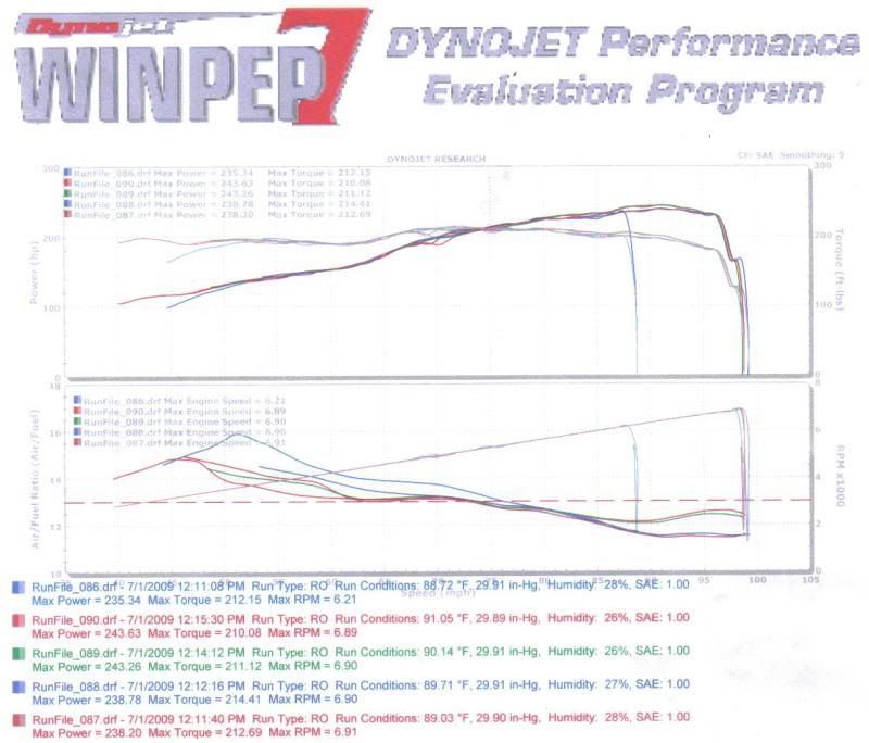

Here area few of my baseline runs
very linear power output. I was not really seeing that flat spot, but I had just installed a brand new Nissan timing belt, tensioner, and idler though. My mileage was about 82K km.
