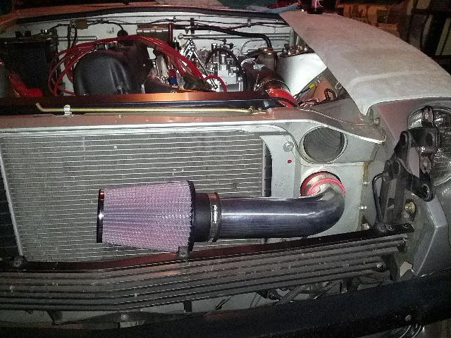

inline6 Posted February 13, 2013 Author Share Posted February 13, 2013 I had a very similar noise on my car when I over tensioned the belt on my tired alternator. Try backing off the alternator tension to see if it changes. I wouldn't have thought there'd be any noise from the tensioner? Liking this build! Yeah, it's on my "to do" list to search the forums and elsewhere to see if the noise is to be expected with the special Kameari chain tensioner set up. I also will loosen the bolts on the tensioner and see if it feels right to back it off a tad. In the meantime, I got the air box cover on... it is super tight to the point of almost breaking it to get it on. Unfortunately, the combo of the Cannon manifold, the rubber carb isolators, and the carbs and the .030" heat shield and the air box mounting plate combine to make it too long. Here is a pic of it installed: I am still wondering what to do with the air filter... I have it installed in this pic. I have two things I am thinking about. First, should the filter be pointed up like this? Over a long drive in the rain, I can see the water coming in and pooling in the bottom of the aluminum tube. That wouldn't be good, because eventually, its going to get sucked into the engine. And second, Should I put it in the center like this, in front of the radiator? Seems like I could shorten the run a touch and point it downwards and still get all the flow it needs, but the downside is that it will be exposed even more to water spray coming in the front. Where it is now, it is protected by tucking under the hood a bit. Anyway, still pondering. Quote Link to comment Share on other sites More sharing options...
