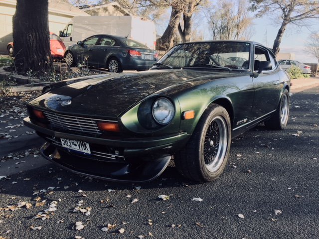

  11. WOW! That is beautiful! The rims and tires fit perfectly. What size and offset did you end up with?
