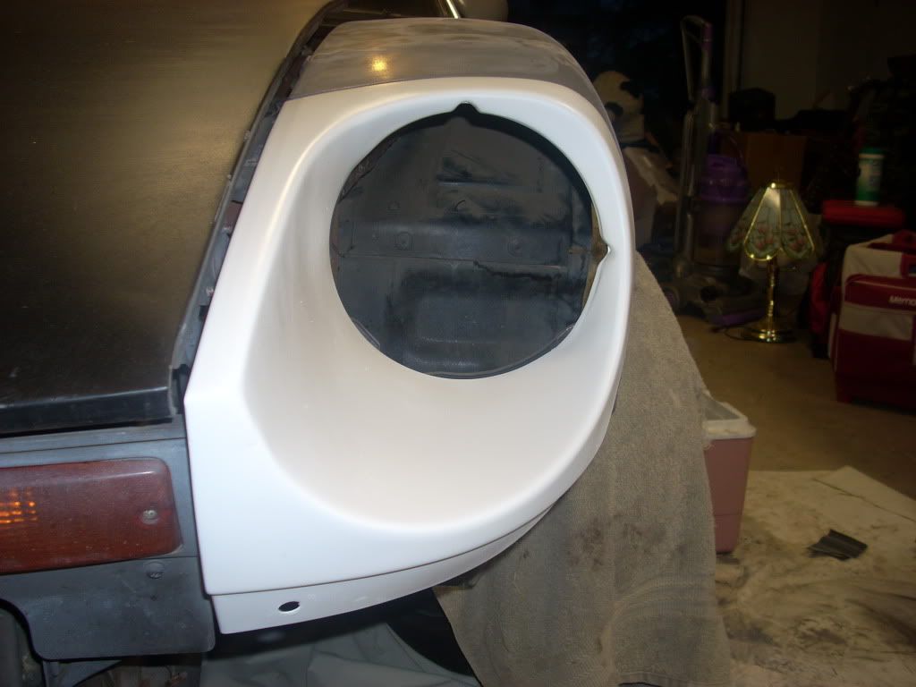

took some stuff apart like the cowl, air dam, and taillight assembly:

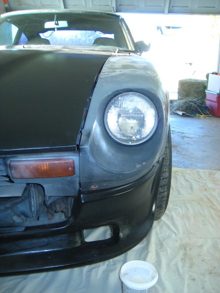

working on the wet sanding to even out the body (my friend is helping me so we are each doing one side... but he worked in a body shop)
she has been through a few different colors is see...
and more progress...
just getting the other fender done and the cowl...
