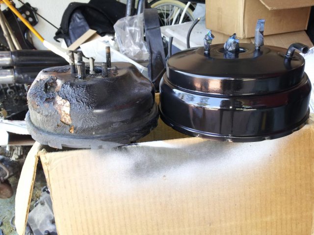

    Comparison, s30 left and z32 right.
  12. 98blackbell
    Z31 booster and MC on 240Z
    We did the Z32 mastercylinder and booster, as well as the z32 front and year brakes.. We drove it for about 2500 miles and a couple events. The booster from the z32 over powered the breaks and made them very touchy. Hard to modulate. Had to go back to the stock booster and m/c. Seems the S30 is a lot lighter and does not need the over boost. The z31 may be ok. You can only try and see. The z32 booster is bigger. Do you have a comparison in booster size.

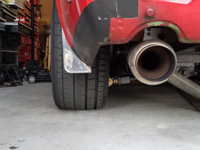

    We have a tire rub issue turning left. Grrrr. Also the breather we designed is not working. We are getting fuel leaking out.

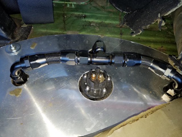

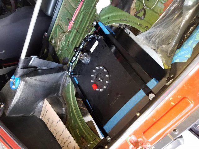

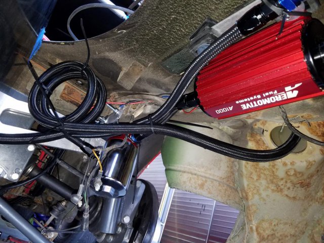

    We finished our updated fuel system and new t3/t4 hybrid turbo install. Wow what a difference. It woke up the beast. Ran SCCA Sunday at Hutchinson Island. 6 runs ended up 3rd behind 2 modified FRS Scions. Beat out other modified mustangs, brz,frs,Subaru. New fuel cell, New a1000 aeromotive fuel pump, -8 fuel lines front to pack, new pallnet fuel rail with -8 fittings. The problem: We ran the 2 vent lines "Y'd" into one line -10. Coiled it 3 turns beside the fuel cell, then back up the fill neck to a filter that is sticking out the old gas cap hole. The fuel cell is flush with floor in hatch. We are getting fuel out the vent/ gas cap then down the quarter panel during each run. What can we do to fix this?

    I agree about the loops. Definitely did not work. Here is picture from top.
