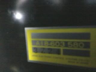

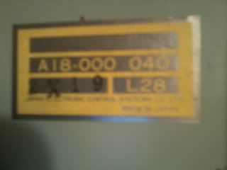

This is my ECU. Sorry about the blurry pictures.

I just read thru most of your posts and I think it worth a try to look at the EGR valve. Do you still have the vacumm like connected to the EGR valve? Just disconnect it and test it out. The ECU connector would be the next guess on my list. GL

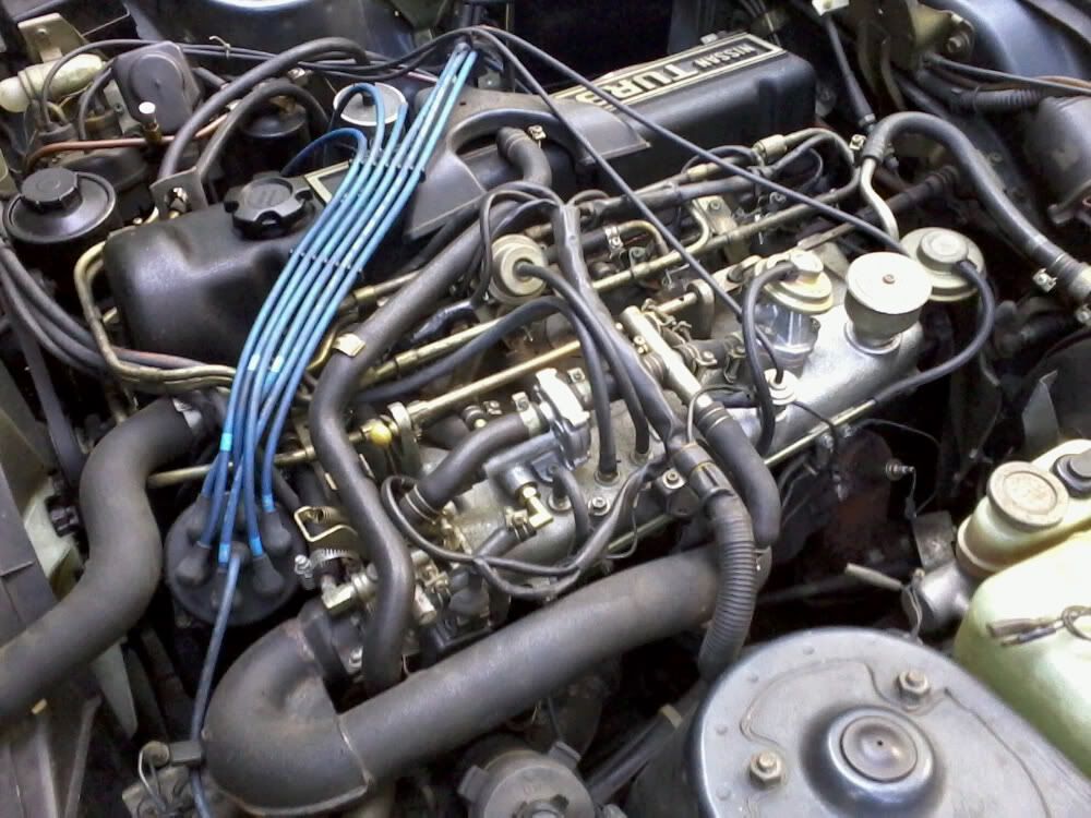

I was thinking EGR valve myself. They will leak exhaust into the intake when
bad. (stuck). This would cause a mixture problem. If origional I would replace it.
Steve

It does appear to be original equipment, or at least the same condition as other parts on the intake manifold. Looks like I wont have time to work on it untill the weekend. Are the NGK plug wires original equipment?
