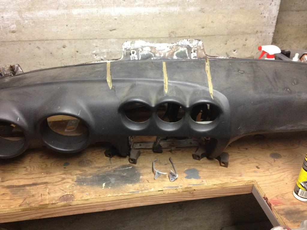

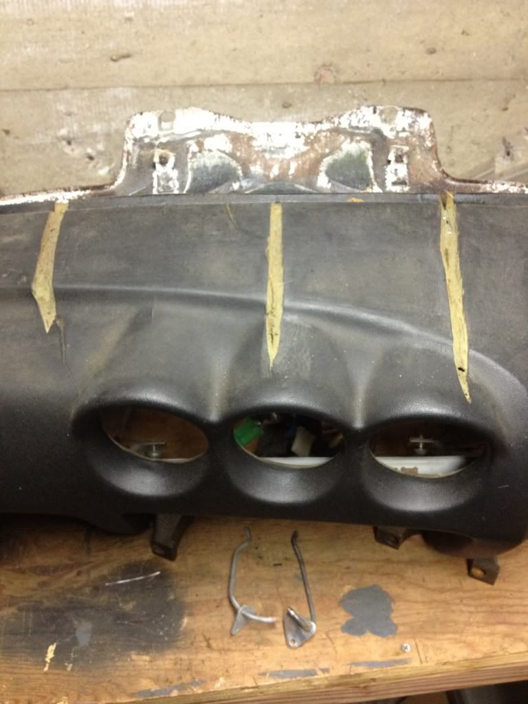

Jasonmreiss Posted February 23, 2012 Author Share Posted February 23, 2012 This is what I'm starting with. I'll start filling in the cracks with bondo tonight, and should be able to sand and start fiberglassing tomorrow. I'm just trying to think of anything to add or delete before I start it Quote Link to comment Share on other sites More sharing options...

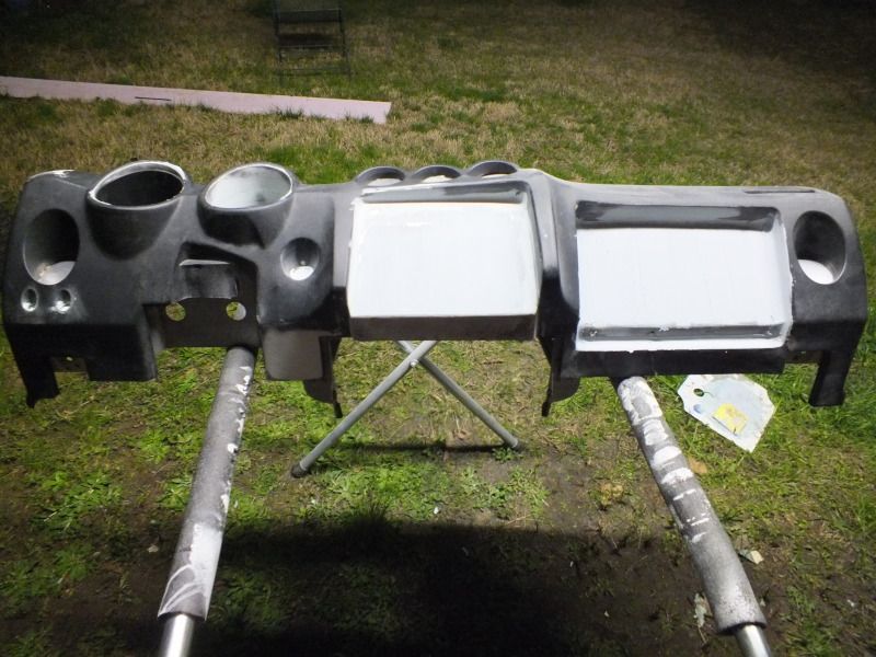

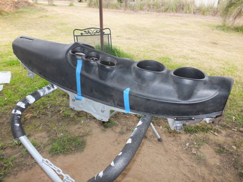

gearheadstik Posted February 23, 2012 Share Posted February 23, 2012 (edited) Here is what I started with the tape marking my cracks and the next pic is the dash with most everything plugged up for the mold... Maybe tomorrow I will get it in primer and smoothed out. Take note you guys repairing your dashes and let me know what kinda time and money you have in it by the time your through... Hoping this will be a good option for people instead of paying the 1k plus that a dash in great shape cost.... Edited February 23, 2012 by gearheadstik Quote Link to comment Share on other sites More sharing options...
