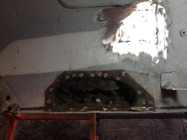

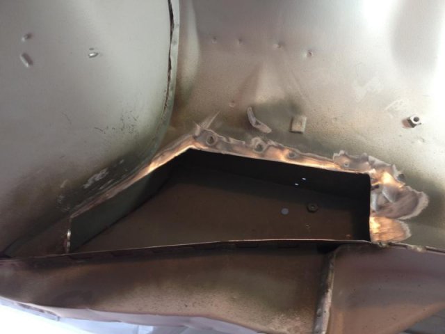

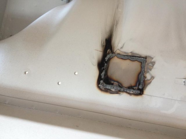

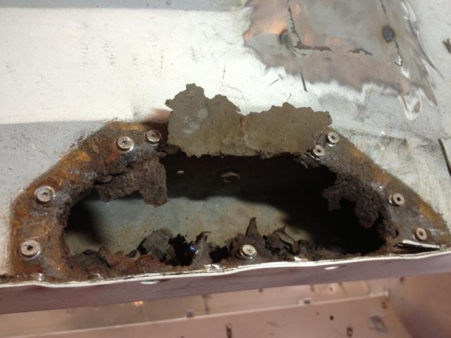

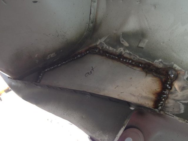

Well, for every two steps forward, we get a step back. First, some more progress (yay!). Passenger side, just forward of the firewall in the outside fender well along the frame rail. Cut out and patched. This one came out even better than the last one, so I guess practice really does make perfect (or better at least!) Engine-bay side of the driver strut tower. That's the backside of the fender-well side of the patch. And here's the step back. I knew there was some rust behind brace panel (or whatever that thing is called) that the crossmember bolts to. I drilled out the spot welds (there's a LOT of em) and found this. I don't think it's as bad as it looks though. Looking at the frame rail behind it closely, there doesn't seem to be that much rust on it...just surface rust. I think what we're seeing here is water that's gotten between the inner fender and that little bracing panel, and rusted it from behind. I think it's going to be a bit of pain to patch though, since I'm going to have to repair the fender well, and then make a new brace that will weld over that patch. Also, that brace is much thicker metal (16 gauge if I had to guess, I'll check alter) so I'm going to have to hunt down some material to work with.
Honestly, I haven't quite gotten to that part yet I think that for the strut tower, I'm probably going to seam weld the whole thing all the way around on both of them. There's a little bit of gap there between the patch panel (and the rest of it really) and the body. I suppose I could squirt some seam sealer in there, but welding the seam seems (haha) like it would improve the overall rigidity of things. As for the surface of the two patches, I'll probably use some putty for the small holes and major blemishes, but I'm not going for perfection. If someone can look closely and go "yep, there's a patch there", it's not the end of the world to me. But that's mostly because they're in behind panels and such...if it was an exterior panel, it'd be a different story.
Got those two panels burned in and mostly ground out. May do a little more cleanup, but frankly, I'm sick of grinding.
